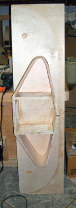

When the glue on the curvey bits is dry, the upper and lower chamber walls can be glued in. Sandbags were a bit overkill for this, so I used cans of nails and other hardware to weight it all down.

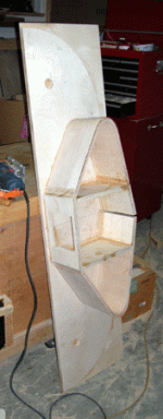

And finally, the inner front panel can be glued on. There will also be an outer front panel, which has the recess for the driver. This inner panel just has a crudely cut rectangular clearance hole.
