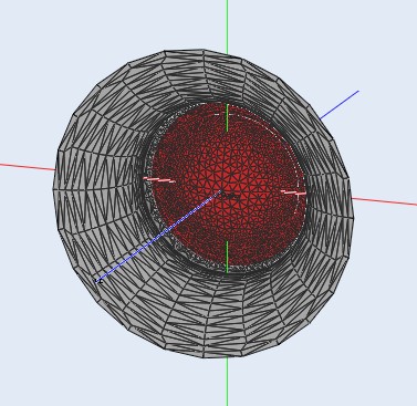

I am trying to use Axidriver simulate a round over as a basic waveguide for a high XO point (4kish) on a 1inch with a 2inch extended range do you have any pointers? or even better would share what you used in this thread?
I don't even see how to plot several curves in one graph in VACS...

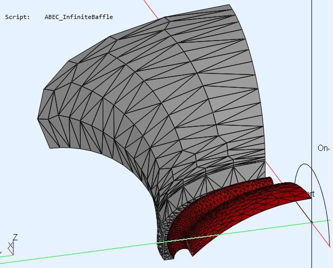

I encourage you to get your hands dirty and I would suggest starting with Akabak 3, it is the newest version and adds point and click options whereas ABEC was mainly script based.Hi,
That is really kind of you but I'd like to get my hands dirty i.e. play with the model myself, I haven't used BEM since school so I was looking for a simple example to get me started and soften the learning curve.
On the other end if you are able/willing to share what you do with ABEC/Axidriver I'd be truly grateful...
Here is a good video I found that explains the basic use of Akabak quite well.
Simulating Waveguides in Akabak - YouTube
To model a dome tweeter the dimensions of dome, surround and gaps to any frame or mounting are important.
If you just want to use a flat disc or basic dome that is easy but the results may not be valid for the tweeter you have.
mabat's Ath program can model a source in great detail and a simple circular arc profile can be selected for the waveguide. That would be the simplest way to model it with a pre-generated script for ABEC.
ABEC/AKABAK also has a diaphragm generator inside where you can model the source that way.
The CAD modelling is often the most difficult and time consuming stage when the initial learn curve of ABEC/AKABAK has been climbed.
It is worth modelling the entire enclosure once you have nailed things down in an infinite baffle. The overall effects on directivity can be quite significant.
I can run an example close to what you have described and explain how I did it if that would help.

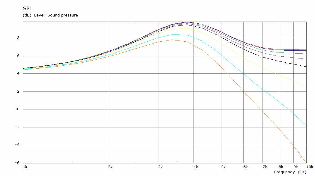

Thanks a bunch, yes if you can run an example that'd be great so I can verify my own simulation but you'll need to show detail the parameters you used. I know about ATH but though it was overkilled for what I wanted to do especially to demo the simulation vs real life.
I made some progress already but having an example to try to match would be terrific.
If Ath can generate the shape you want to look at it is always the easiest place to start because the mesh and project generation is awesome.
For the dome, what height, diameter and surround width / height do you want to choose? That way the simulations can be more easily compared.
Attached is an Ath script for version 4.7 to generate a 25mm dome 4.68mm high with a 2mm surround. To change the roundover to a different depth change the length value in the script and resolve.
