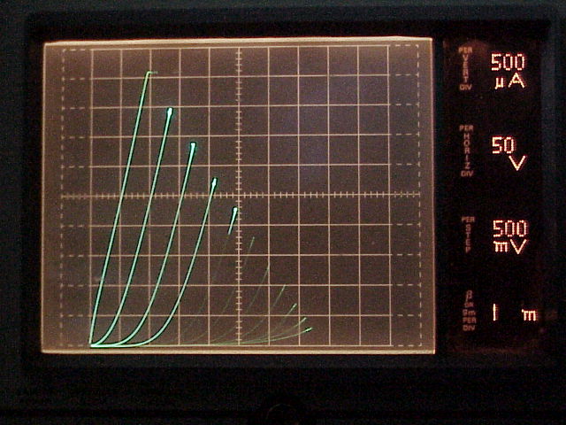

For those that want to photograph a Tektronix curve tracer, you can run into problems. The display rep-rate is dependent on the number of steps selected. If your camera can not do a long exposure (like mine), some of the steps will start to fade out. Below are the curves of a 12AX7 from a 576. There are versions of the 577 that have a bistable storage CRT which wouldn't be a problem.

Use the "Video" setting on your digital camera.
You can fashion a hood from foam-core board which will remove distractions -- but paint the internal part black. This would be akin to the Polaroid setup which Tek sold.

I've been shopping for a new camera, I'll look for that feature, my present cam doesn't have it. I have one or two of the old Polaroid scope cams, the film is about 2$ USD per pic when you can find it. Any recommendations for a low cost (<$300) cam are welcome.

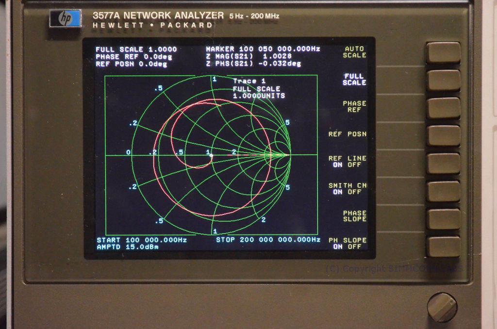

A fellow in California has adapted an LCD screen for various HP analyzers. I haven't gotten around to installing one in my HP 3577A yet, but it's on the list for the fall. Would be wonderful for the Tektronix analyzers, better still if we could export the graphic and data.

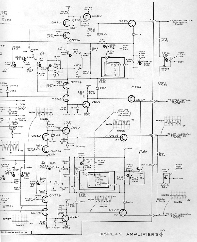

The older Tek curve tracers are strictly analog and the input to the CRT is X-Y stuff. The HP analyzers are computer based and the screen is just a graphic output. The LCD is a huge improvement for the HP instruments. For the Tek you would need appropriate digitizers to drive the screen. Probably a lot more work than it would first seem.

It could be done, not by me. Q678,Q687, Q578,Q587

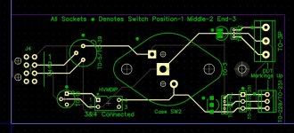

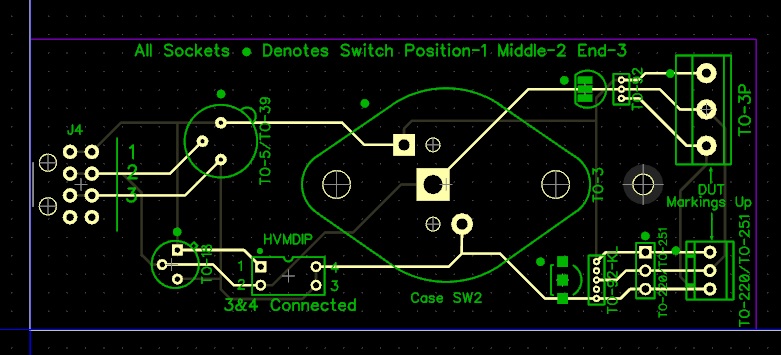

I'm in the process of spinning up my own version of a curve tracer. Nothing special, just tired of rigging up something to match devices, it's really getting old. I don't really care for a scope full of traces, so I went with something different. I'm running a slimmed down version of it now on my wishboard.

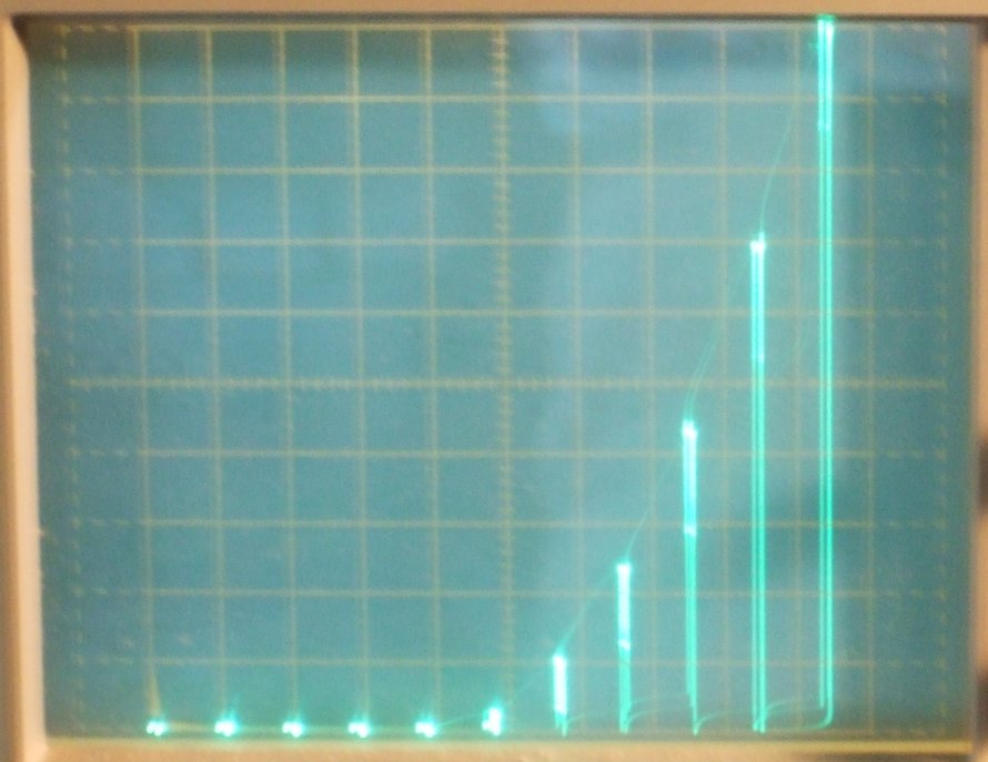

It's fairly easy to mod the Tek 576 to get 15 traces. Pull one IC pin and add a resistor. (pics below) They went to some length to reduce it down to 10.
My old Fuji 8.3 Mega pixel camera works fine for photographing the trace, just need a tripod for steady mounting. Use the zoom to fill the pic.

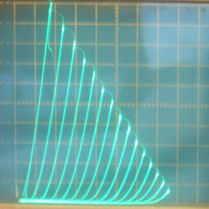

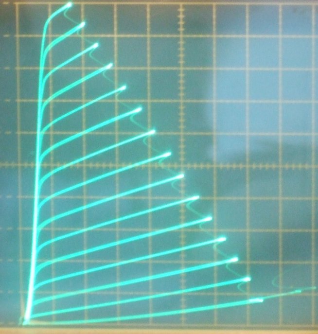

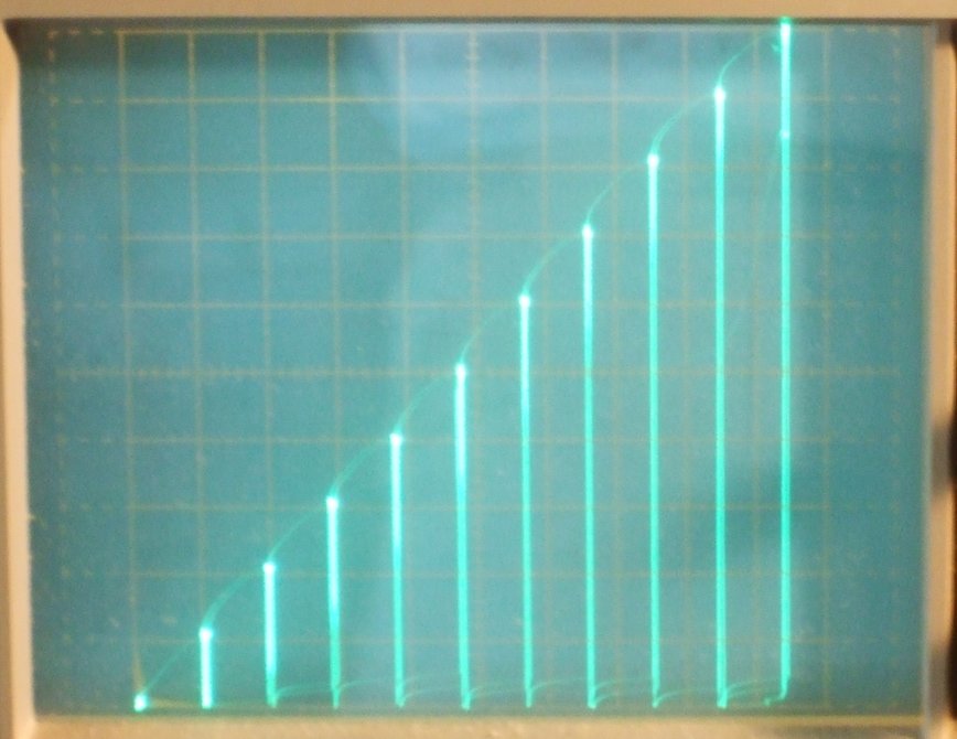

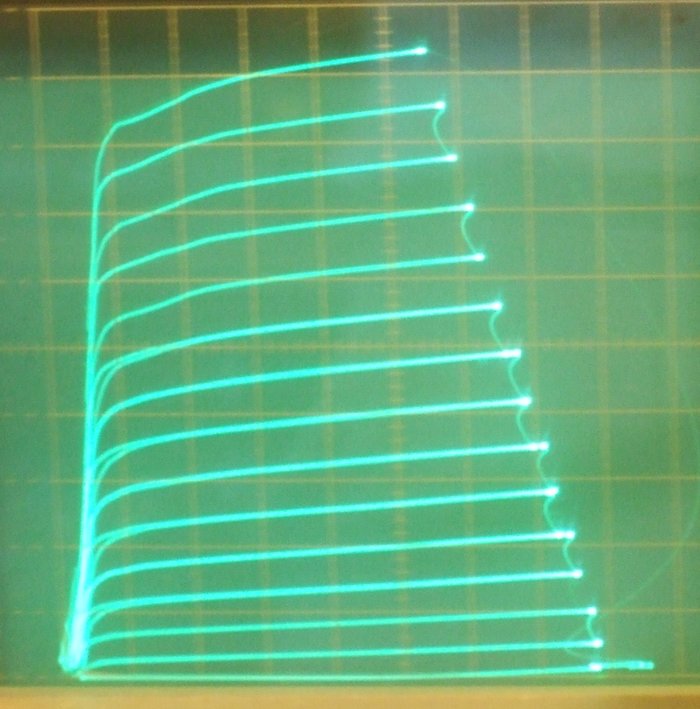

I modded the stepper amplifier and its V supply to do 14 (x 12V) steps (168V), useful for grid 2 stepping. One can also add an external floating supply for more grid 2 offset. I also changed the 1500V plate V scale to 750V by removing the voltage doubler rectifier scheme.
Then I arranged for some variable plate load resistor settings for testing plate current versus grid V (3rd to last pic, a linear ramp for Crazy Twin drive, 2nd to last pic is for normal g1 drive...which sucks!) Last pic is normal g1 drive pentode curves (compare to 2nd pic of Twin/Crazy drive curves).
Also added some switches to control the internal vertical and horizontal select relays, so external X or Y inputs can be used. Very handy for using an AM503 current probe (screen current, grid current)

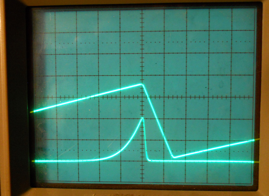

Also pick up the timing pulses from the step generator -- 10ms per pulse.
