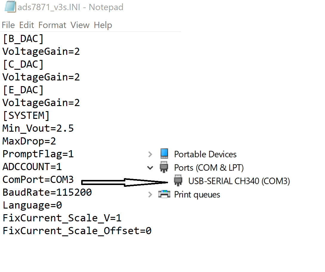

Is anyone here using Windows 10 with the curve tracer?
Mine is not recognized by the machine. Driver installed, unit connected. Opened the cover and unit looks to be alive, but not recognized by the PC.
Did anyone else experienced this?
On Windows 7, the curve tracing software app says something like "Device Not Connected" every single time. My workaround is to ignore that message and simply click Configure --> Get Parameters anyway. Presto, a popup notification message appears: "Parameters have get from device" and everything works smoothly thereafter.
The program uses the COM port number saved in the ini file directly when measuring.
When you change the USB port, windows will generate another COM number, which is different from the original one, so the program can't be connected, so you need to re-detect it in the settings to use the new COM port number. and many USB printers also produce the same phenomenon.
Bingo!
Thank you LZ!
Mark,
once you get parameters, save the setting in that screen. That will generate an INI file on your desktop (watch folder settings). The INI file must match the COM properties of the device in the device settings. After that, the deice shows up as detected every time.
In my case the PC picked up the device on COM3 and the original INI file was set to COM1. After I saved the config, the INI file changed to COM3 (below).
