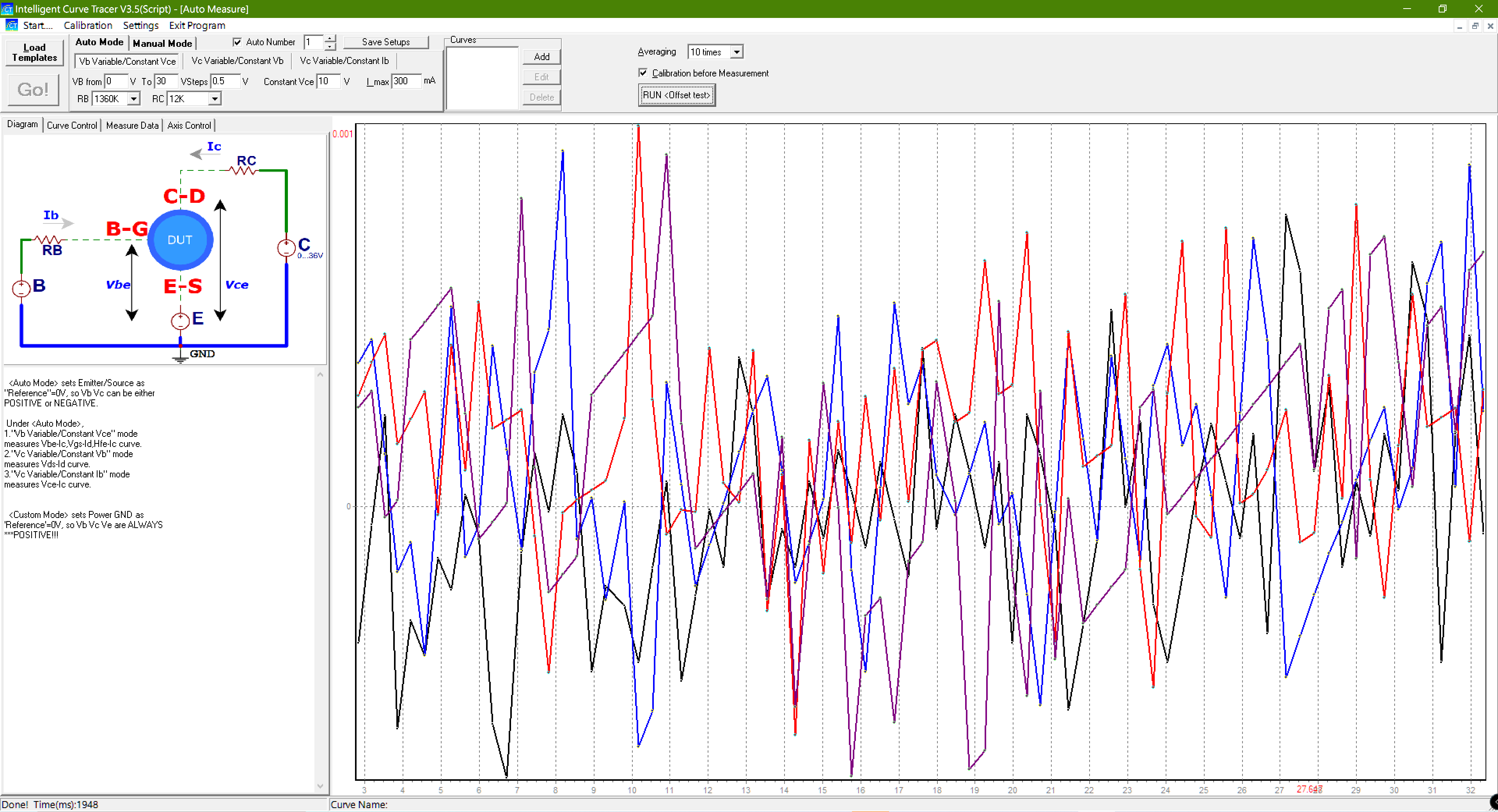

sometimes I get the same curves as shown in #1, but more often the curves begin as one would expect but break up like in #1 when the power levels increase.
I took care when setting the parameters to stay well within the DUTs limits.
My lab supply puts out 32V/3.2A at maximum (and I only tested with lower settings) ... staying within the limits of the curve tracer.
It looks as if the curve tracer for the most is producing wild cards.
jauu
Calvin
I don't know what type curve you're measuring.
The curve display is not smooth and is related to many situations, such as:
1.Y-axis scales are different, for example, the same curve under 0.5 and 5 on the Y-axis scale, and the fluctuations will be significantly different.
2."Hfe-Ic" curve, Y axis is Ic/Ib, at the beginning of the curve, Ic and Ib are particularly small, the measure result is not accurate. When perform a divide operation "Ic/Ib", the result amplitude changes particularly severely.

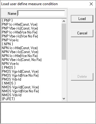

Since I've never used one before can somone suggest what template to load in the tracer to match BC556 (PNP) and BC546 (NPN) for Hfe and what settings to use. I'm kind of lost in that area and I've never used anything precise like this to match. The circuit runs at 20Vdc so I'm guessing I want to match for that voltage but other than that?
Here's the templates available and a screencshot of the settings for one of the PNP templates

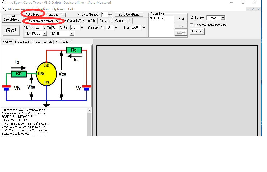

To measure hfe-Ic curve, also use 'Auto mode'->'Vb variable/Constant Vce'
attachment.php
this mode have two control voltage:Vb and Vce.
(1)
'Vb' generates a base current through RB,
Because of the supply voltage limit, the absolute value of the maximum output is less than the supply voltage-4~-6V. If you use 32V power supply,the Vb maximum is 28V or -28V.
select another RB range will gererate different class base current. example use RB=1360K, and VB set "1 to 28V step 0.5V", then the Ib is about 0.7uA~20uA. If select RB=500ohm, Ib is about 2mA~28mA.
(2)Ic=Hfe*Ib
also supply voltage limit, the “Ic*Rc+Vce” must less than the supply voltage-4~-6V. If you Ic is about 30mA, and you select RC=1K, then the Vce can not reach to 10V, because the Ic*Rc=30V and your power supply just 32V.
note: Do not measure small currents with small RC resistors due to measurement accuracy limitations.
Example you Ic is about 1-10mA, and you select RC=5ohm. The measurement will be bad. because the Ic*RC=50mV, The curve tracer resolution is approximately 1-2mV.For better results, the pressure drop on the RC/RB resistor is greater than 0.5V.

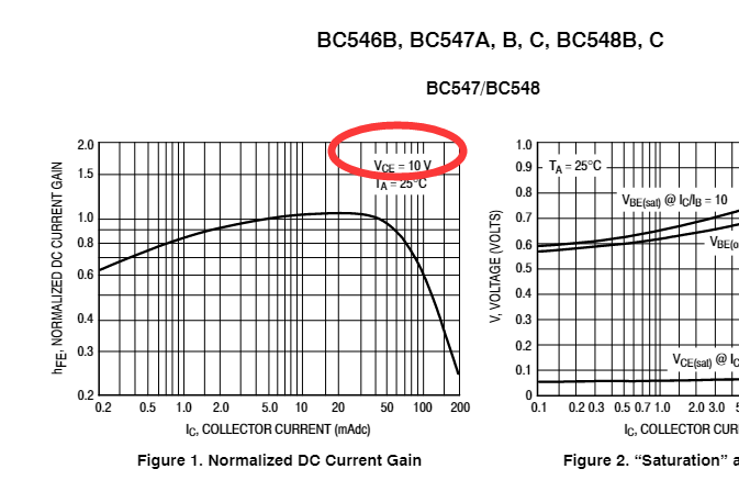

(3)How much should I set Vce?
You can find the value on the ‘Hfe-Ic’ curve on the transistor pdf.
attachment.php
