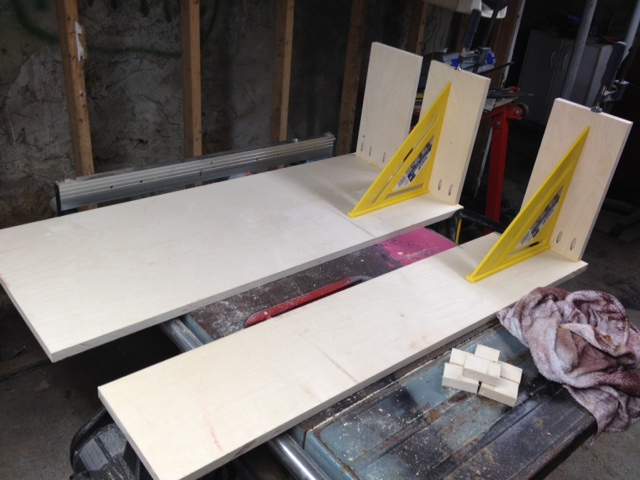

Got bored, had some extra baltic birch, so i decided to get started on them!!
let the routing begin! i had all the sizes marked on my circle Jig, so this time around it was a lot easier!!
sliced em up....anddd i'm out of wood for now. gotta go grab some more birch and finish these in the near future!

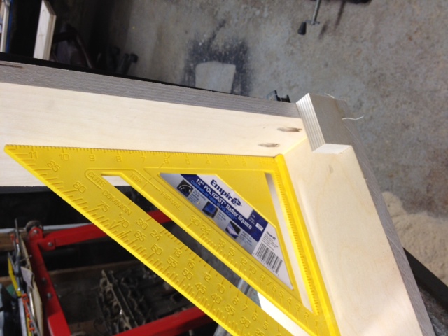

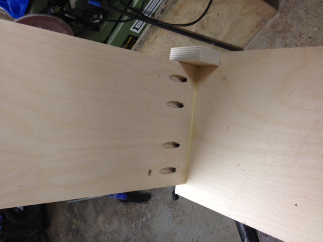

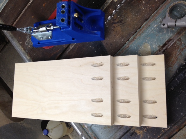

Picked up a new pocket hole jig, the Kreg K4. It is very useful, let's see how she holds up after a bunch of use!!
