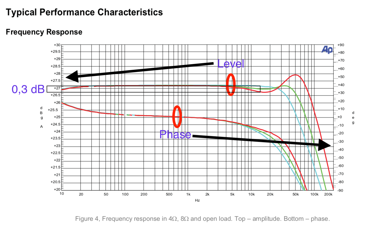

...According to the datasheet, 20kHz response appx. -4dB down relative to the 40Hz (Lower level graph trace shows).
Sorry, you are not intepreting the shart correctly... se my annotations...
The ASP amplifiers are very nice amps. I doubt that you can hear the difference between different loading - even less that you can perform at test that is valid...

Ouch!
Oh! Sorry, I used wrong trace for measurement.
Actually the difference level was numerical small.
I made mistake as it feels big enough from the sound impressions...

All ICE Power amplifiers are twin loop designs, with one loop inside the filter and the other one outside.
Anyways I´m affraid you are looking at the phase rather tthan the frequency response.
