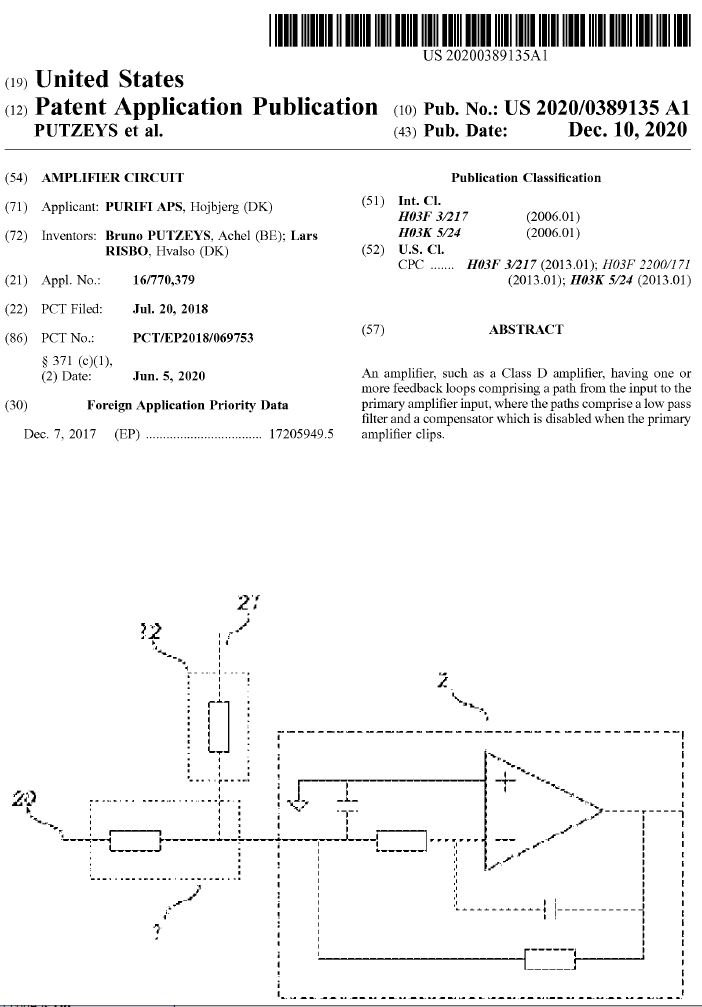

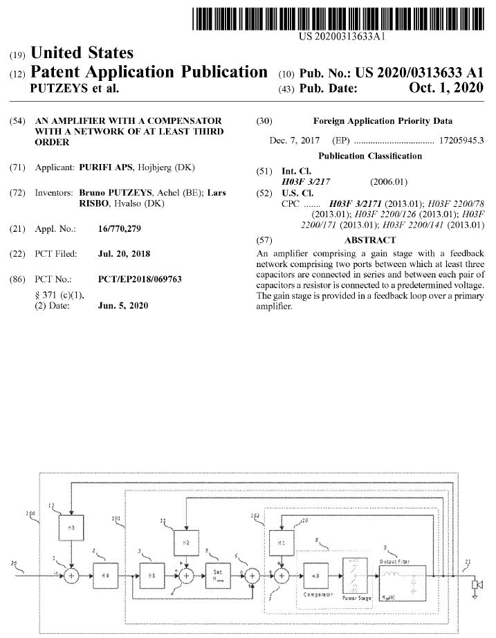

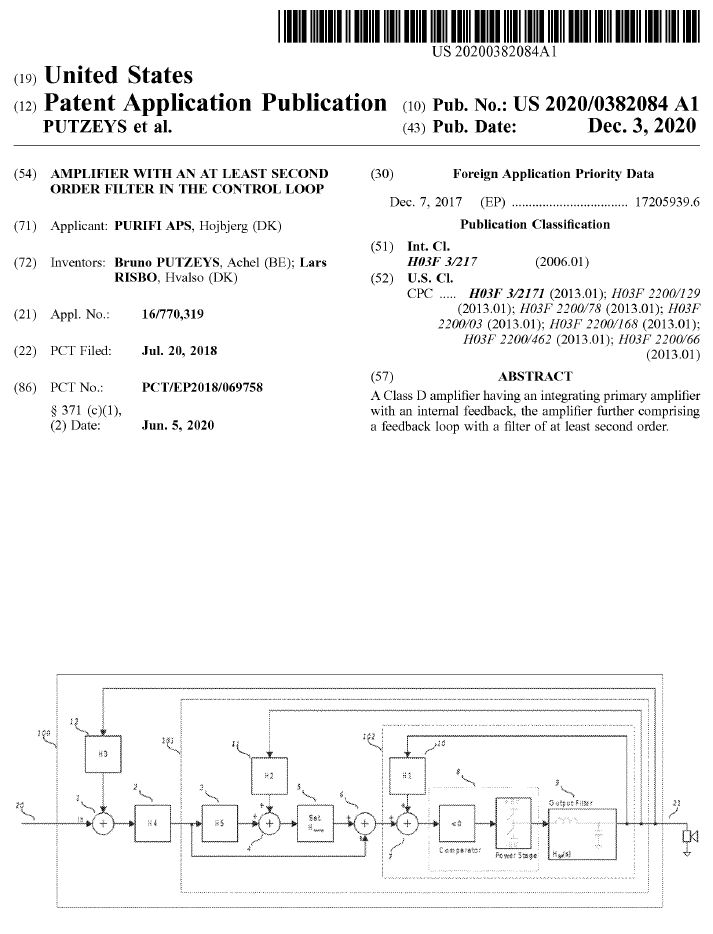

The Purifi US patent applications published Oct 1, Dec 3 & Dec 10, 2020...
These seem to be basically the US applications for the already published patents.
But worth a second look anyway.
But worth a second look anyway..........
Which already published patents? European?
These are assigned to Purifi, not Hypex.
