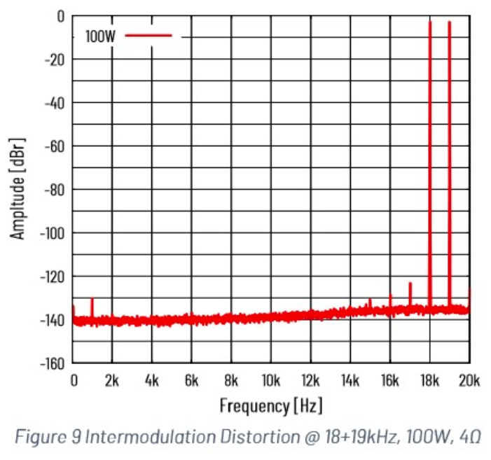

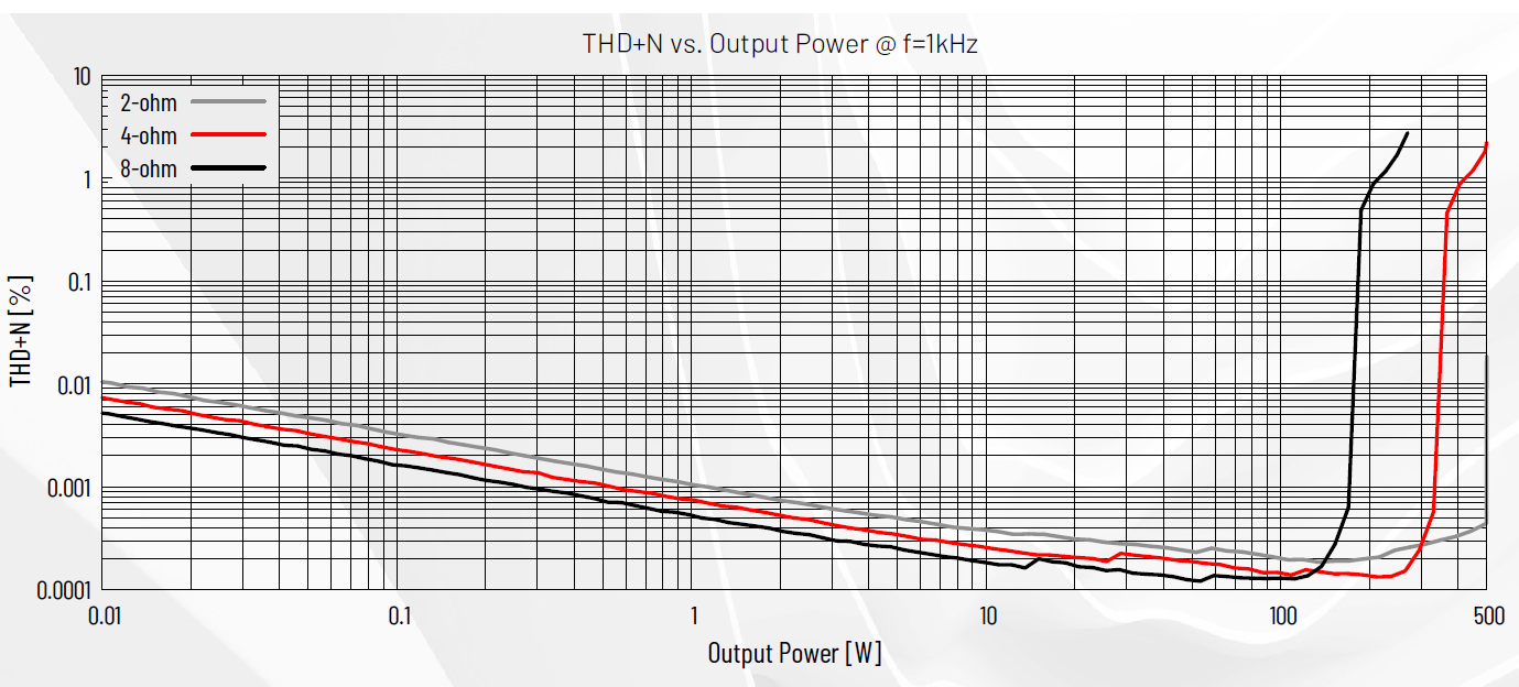

Why do the do these little shelfs / jumps in the dist as level goes up?
This is the autoranger in the AP switching to the next higher range.
Jan
OK, so they don't work very well - because what is the chance that distorsion also has a shelf rise at the exact place where it happens to auto-range....?
So, a measurement error - I see... albeit very small I have to say...
