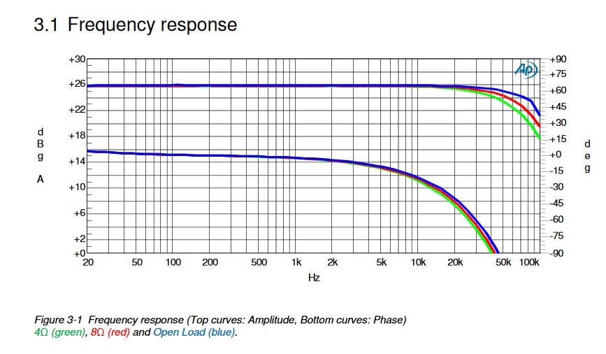

I´ve attached two measurements of phase for class D amps.
It is pascal SPRO2 and ICEPower 1200 AS2.
As you see they both have some deviation from a straight line.
This is an often overseen parameter in both class D amps and linear ones too.

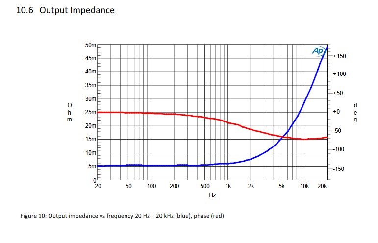

Well first of all it is not really true, that group delay is a direct function of output impedance.

At least a certain amount of non flatness in the phase is inevitable if the amplitude response is not flat.
This is the minimum phase response. There is always some delay associated with upper frequency roll-off.
And it always must roll-off, eventually.
I don't see any point to worry about this because it is unavoidable anyway, just a consequence of bandwidth less than infinite.
The only way to reduce it is to extend the bandwidth and I don't believe there is evidence that this is audible.
And of course it happens for any class of amp.
Extra, so called Non minimum, phase is more of a problem if it occurs.
But I would not expect it in a Class D amp.
Some of the Ice power plots do show some non minimum phase but it looks like measurement error to me.
Hence my question.
The plot in your latest post looks essentially minimum phase, just from eyeball estimate.
