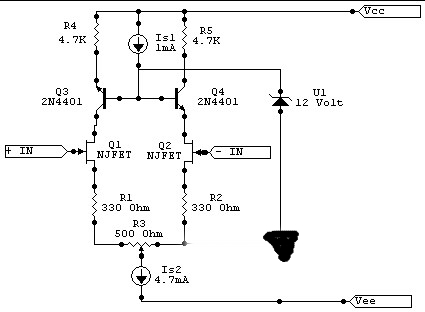

You could adjust the offset by adjusting the current through the current source. I just wanted to know how the sonics might have changed.

The Pot Adjusts the DC offset. as for the sound the Voltage ref connected to the Current source vs Ground Produced a sound similar to what more Feedback dose.
ppl said:When I first tried this Technique i got More DC offset with the Zener Grounded that returned to the current source. I must point out the Zener is only for Illistration a real Circuit would have a Quiet Precision Voltage reference.
???? Its the BOTTOM pin of the zener that needs to go to gnd, not the top one, that should stay at the current source. The way it is here will give you a HUGE offset.

ppl said:The Pot Adjusts the DC offset. as for the sound the Voltage ref connected to the Current source vs Ground Produced a sound similar to what more Feedback dose.
Aha? You actually listened to this circuit?

To answer EchoWars,
No, not a pot between the two emitters with wiper to supply, but rather a rheostat on the feed rail, supplying greater or lesser current to the DA as a whole.
I have my doubts about a trimmer pot across the emitters. This approach would certainly accommodate different Vbe on the two 'non-matched' devices; but it also means that each transistor sees different degeneration, and thus operates with different transconductance. I believe this is bad for the feedback network, which should see the same transconductance at its node as the input. I'm sure there is a math reason for this, too. Bam?

Hugh, you know I cannot resist
For Echo's circuit, call the transistors Q1 and Q2. Base voltages v1, v2; collector currents i1, i2, resistance between Q1 emitter and wiper R1, Q2 emitter and wiper R2, and wiper to supply R3.
Then, small signal,
i1 = (v1-v2)
. _________________________
. K1 - K2/(K2/R3 - 1)
Where K1 = R1+(1/gm1), K2 = R2 + (1/gm2)

So the idea is to make the contribution to i1 equal between gm1 and gm2, to minimize distortion.
If R3 is infinite (perfect CCS) then the equation becomes:
i1 = (v1-v2)/(K1+K2)
And it is balanced provided R1=R2 and Ic1=Ic2 (because gm varies with i in a BJT). Otherwise things get complicated and imbalanced.
My recommendation, for minimum distortion, is to hand select the BJTs for equal Vbe and make R1=R2 and Ic1=Ic2. OR use JFETs which have more linear gm, BUT you then have to hand select the JFETs for equal gms. So you are stuffed either way. 😉

Yes the Bottom Part of The Zener Grounded as you sugest. Regarding the Pot across the Sources of the Diff amp's jfets, If i understand AKSA correctly Removing the Pot and Use hand trimed Resistors in the Top half of the cascode Collector's?This Indeed sounds interesting. Oh Yes i have listened to the Zener Grounded and as connected and liked the more Cleen reproduction as connected rather than Grounded. The Key is the Voltage reference and Current source must be low noise or this gets injected through the sources of the J-FET's
No. I'd never use the circuit I posted. It might balance the pairs, but does nasty things to gain....and stuff.AKSA said:To answer EchoWars,

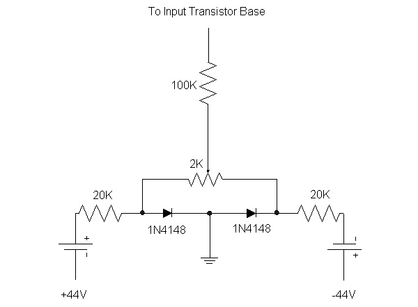

If all I wanted was to remove DC offset, I could connect the circuit below to the base of the feedback resistor. But I suspect that a current source at the emitters may offer more benefits than negatives, and I'd certainly like to try it.
