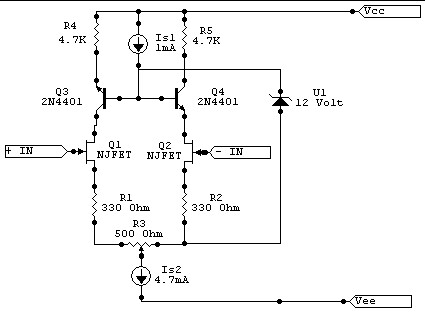

Part of my motivation is to attempt to remove the small amount of DC offset I get at the amp output. It is a mere 45mV or so, but the amp is a testbed for ideas anyway, so I was hoping to see how adding a current source in place of a resistor would affect sound quality and the DC offset at the amp output.
Daniel Rosa has agreed to send me a few of his ultra-cool little PC boards, which I will use to add a current source to the input stage. The nifty thing here is..I have two identical amps that I can A/B to listen for differences after adding the current sources to one of them. It should be an interesting experiment...
Back on Track I think The CRD will lower your DC offset. At least that is what i have encountered most of the Time On manny different amps. the one time it did not produce better DC offset was a complimentery Diff amp Stage pair. on normal single Diff Amp. Always has lowered DC Offset.
I myself Perfer Current sourced Diff Amps and resistor load for the Vas stage. Gess as Mr Pass Put it it Depends.

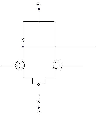

On any SS PP amp with a diff pair up front you can trim offset by merely changing stage current through the output stage.
If the bias path for both transistors of the diff pair are the same resistance, then this method will also ensure that the diff pair is well balanced. Perfect balance is difficult to obtain, and calls for identical Vbe AND beta on each Diff pair device, but this approach is actually superior to a current mirror, which routinely fails to deliver perfect current balance by design.
A simple resistor, my preferred feed arrangement, can be very simply trimmed with - drum roll - a 'trimmmer'!
Hugh

Are you speaking of, say, a trimmer on the emitters? Like this:

When I first tried this Technique i got More DC offset with the Zener Grounded that returned to the current source. I must point out the Zener is only for Illistration a real Circuit would have a Quiet Precision Voltage reference.
