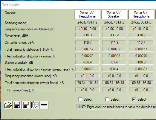

I've actually gotten pretty good measurements with my Asus Xonar U7. I could post some measurements here if you're interested.
Very much, thanks a lot.

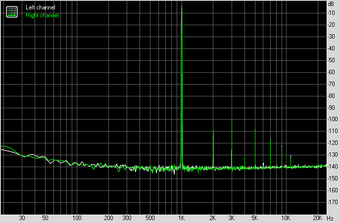

Sorry for the long wait to post some measurements of my Xonar U7. Some basic loopback tests with RMAA are attached. I played around for a little while to get the best performance possible. Much to my surprise, the THD is better when using the headphone output, as opposed to the RCA outputs on the back of the unit. Sample rate did not have much of an effect on THD, results for both 48 and 96kHz sampling rates are shown.
I will admit, I thought I remembered the performance of this unit being better. But these are the best results I could get.
