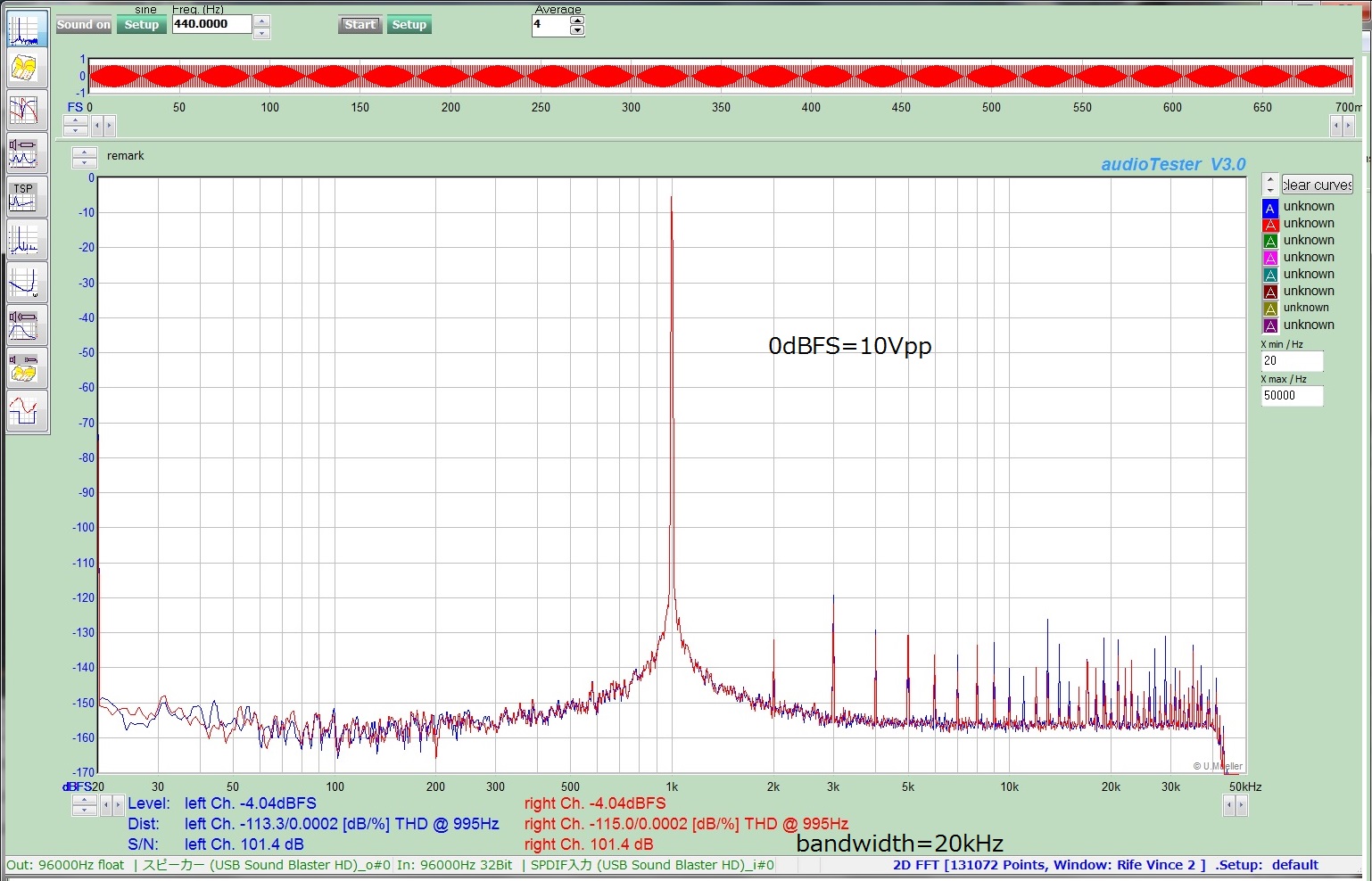

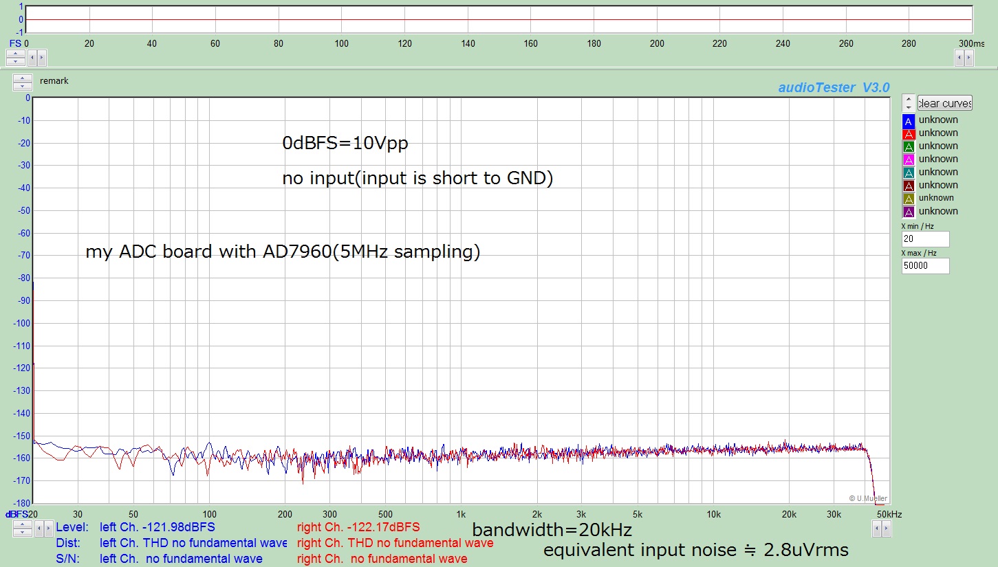

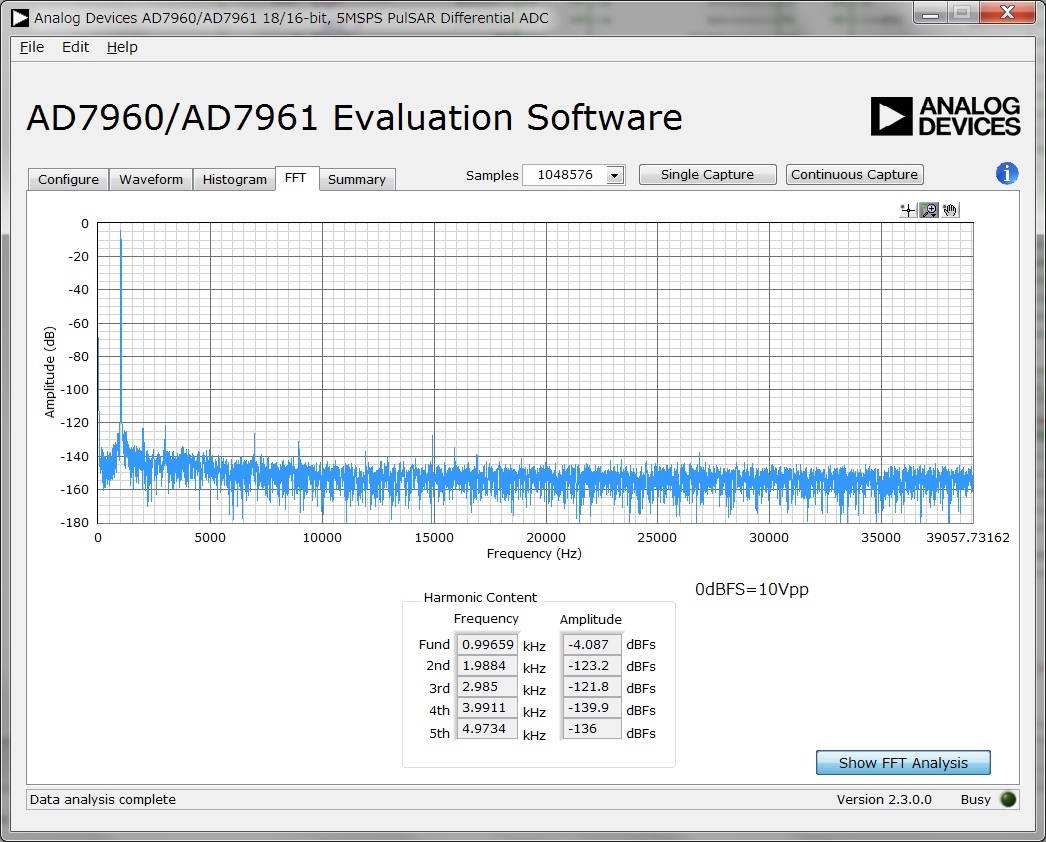

Thank you for your information. My experience is AD9760. The 1st pic is FFT of EV-board by AD. The 2nd is my designed one. The input is 1kHz oscillator by Frex. Both are pretty good, but some harmonics are above the noise floor.
I thought SAR-ADC has capacitor ladder for its architecture, where physical voltage divider results in some distortion like R2R DAC, though the datasheet has no such harmonics.
The 3rd is with the input short. This is almost the same value as the datasheet, very excellent. ADS127L01 has nearly the same value as AD7960 at 20kHz bandwidth from table1 on page 25. But it is with a 2.5V reference, where a 6dB loss in S/N.

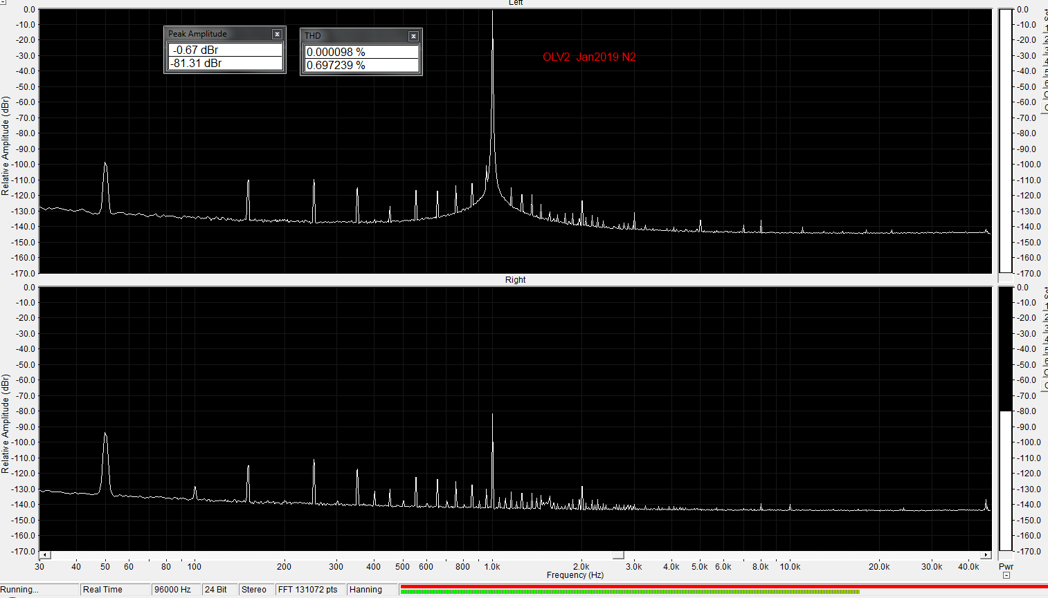

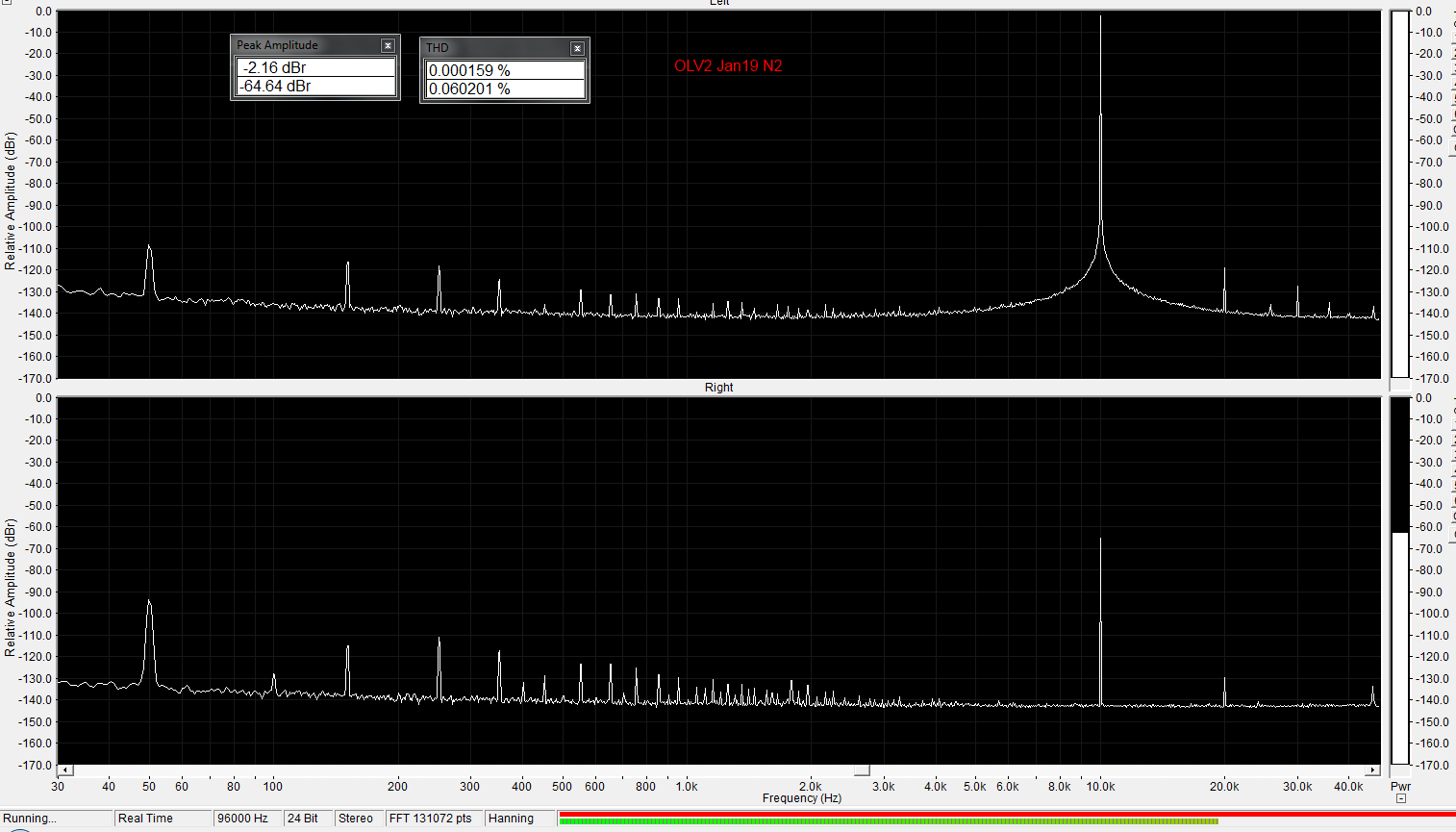

But, what you gain in this frequency band with $50 chip ($100 for 2ch) in terms of THD?
The same results can be obtained with $6 PCM1804 ($6 for 2ch):
