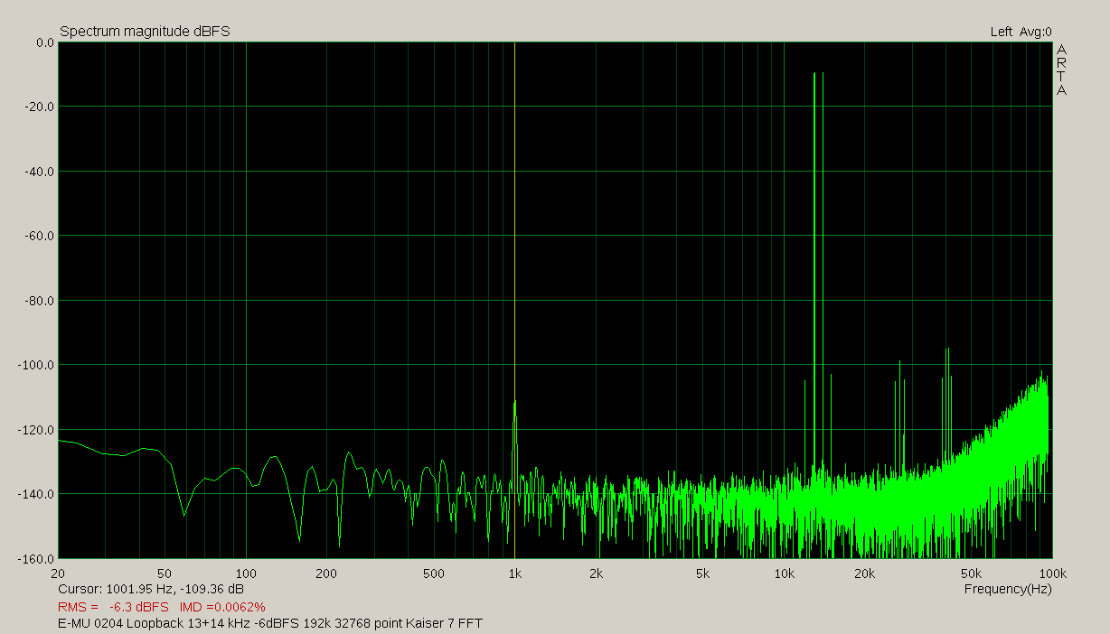

So everyone knows of the old Creative E-MU 0404 and 0202. They give pretty good performance for the price, here's some results I've had, pretty decent!

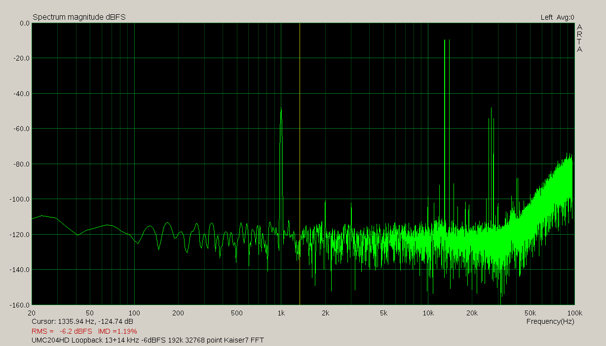

I'm finding my Behringer UMC202HD pretty good
It's cheap at about 50-60 EUR! 24/192 ADC. Can you post some measurements?

I have both EMU 0204 and Behringer UMC204HD. See Arta loopback test plots attached.
