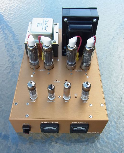

Actually Peter Millett used 807s for a well known amplifier of his, but it was the modern STC version.which are dead easy to get NOS and cheap.
You can buy the STD PP driver board PCBs for it off the shelf.
CHEAP.

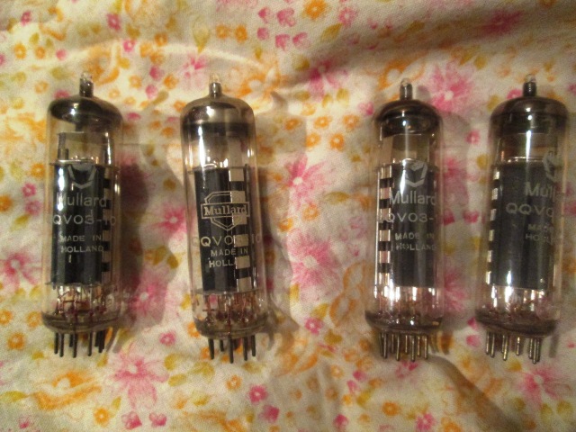

Many people use the Octal TV v-scan version of 807, the 6BG6 - again dirt cheap, and some people discovered the small Noval QQV0xxx VHF transmitter valves for audio, because they are ultra high quality NOS Mullard valves costing peanuts.
Just ONE will do 12W of audio in PP, and at +30V on the g1 they can conduct more than 1/4 of an amp at 100V, but are low gain at only 3.3mA/v so need loads of low impedance voltage drive.
Look, I got these 4 for less than 20USD, they contain 2 beam tetrodes in 1 glass, and they are genuine Mullard! What's not to like?
Transmitter valves just love having the g1 driven heavily positive, and now in the age of mosfets it's dead easy.
