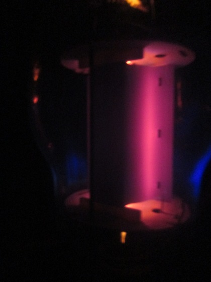

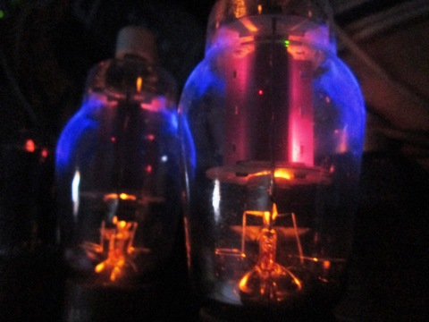

The 807 was a very advanced valve for the precise reason the Anode could be swung off into the HT stratosphere without it blowing up or flashing over, and the screen grid was fully aligned.
As a result, you can get them to hammer on with the anode glowing bright red for hours....
As a result the 807 is a paragon of virtue for screen grid current, which is why they make super efficient transmitting valves up to 50Mhz, despite being a "pinch construction".
Even driving them into a full 20V into control grid current, the thing still refused to conduct silly amounts of screen current, and remain dead linear.
I have a pair here that run at 825V on the anodes and knock out 120W.. I'll post the pics of the so called "5kg" chokes that are supposed to be in there.

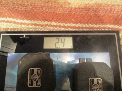

I weighed 3 UTC chokes of a similar size together and I can't get them over 3.5kg!!

As to 807 tubes, letting the plates glow red for a few more watts will not help a navy destroyer in the middle of the pacific when there are no more 807s on board. The captain will not be pleased.

As to red plates:
I had another amplifier that red-plated a 6650 (I turned it off, and fixed the problem before proceeding).
I also had some bad EL34 tubes that had faintly glowing plates. I put in better EL34s.
These are industrial amps, designed to do 24/7, 365.
Any EL34 based amp will be dead within less than a week.
I don't think you have any experience of industrial amps using 807s.
Those old coke bottles are legendary, and the amp is 70 years old. 🙂
When we flogged one to death (after a complete rebuild and upgrade) for an hour recently (as a guitar amp at 85W continous no less) it scarcely blinked.

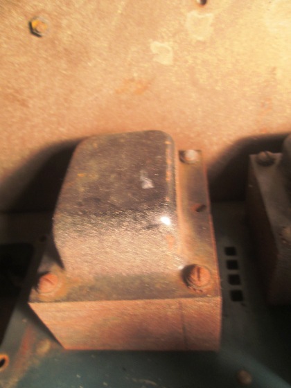

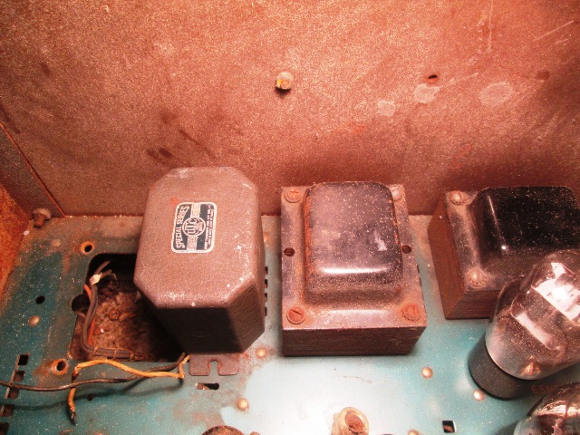

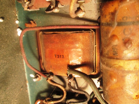

Here are the swinging chokes.
They are incredibly small, and as I found amazing quality too.
I compared them directly with some others I had.
UTC S27 normal filter choke 25H 75m/a RDC = 350.
UTC S30 swinging choke.
As you can see they are similar external size/weight to the T512 animal from Bogen which handles 1/4 amp at 800V.

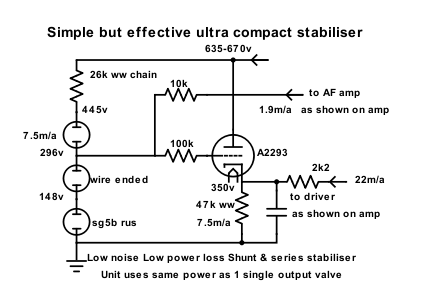

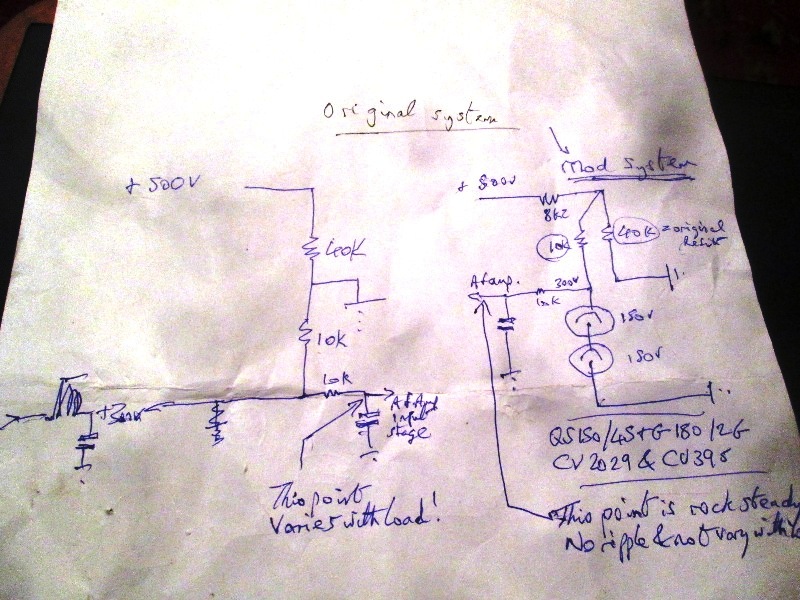

Yes which is precisely why I use a regulator triode to feed the AF amp and driver stage with completely ripple free power.
The A2293 was made exactly for this purpose, but like any transistor if you short out the output (cathode follower) it will die almost instantly.

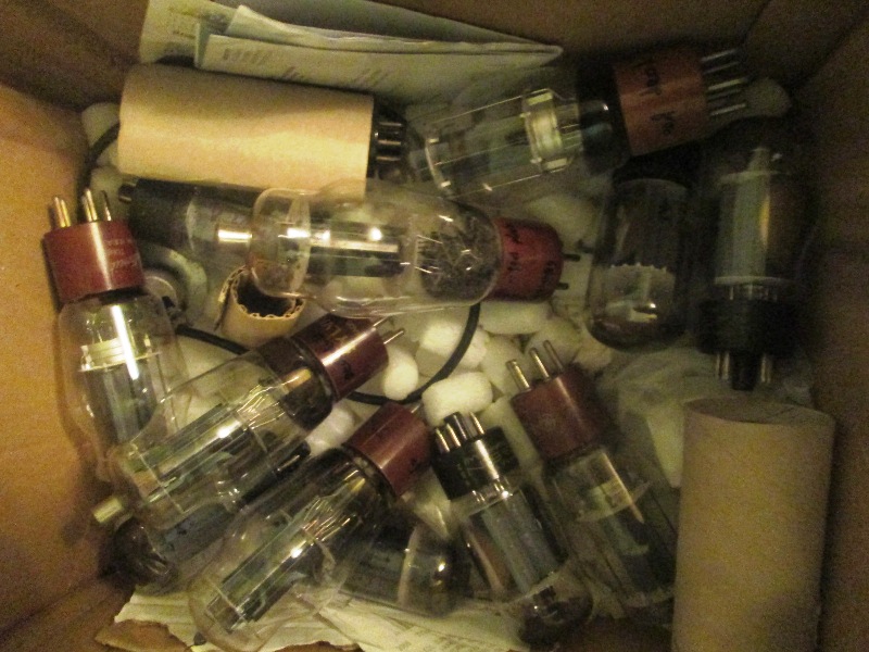

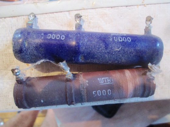

I had to go next door to look at all the stuff and take photos!
I bought a box of 807s off Ebay for about 25USD, and had them shipped.
I think they ended up 1USD each.
I'm sure there's not a single one younger than half a century old.
There were Sylvania, GE, RCA - JAN, all sorts.
I worked my way through all of them at working current and bias (about -28 for 500V) sifting the weak from the strong and UBER strong.
(I do draw the line hot swopping them tho, cos the TC is at 500V and if you try to remove it, you will immediately melt the screen grid - very bright white hot then GOODBYE.)
You can hot swap Octals, (apart from the TT21) but not these...
I have a box here with the remains of them, and a load of half dead 8417s
From the 20 I had, there were 3-4 pairs which matched perfect, you come up 165mV over 4.7rK checker, so about 35m/a - about 18W.
A pair came in at 115mV I reject them,- WEAK.
If they red plate (one blew fuses immediately) or go beyond 210-220mV I reject them. (40-45m/a), cos they will only be a pile of trouble, and unstable.
For those big amps they're going to be fitted with a quad of 5B25x because I start to get nervous with single pairs at over 800V - undocumented settings and all. 🙄
I know of only one other person that had an identical pair of those H125s and he had lots of fun with arcing and other stuff, before they behaved themselves again.
On both of mine the power transformers were scrap, with shorts, but who cares they will get changed to 230V anyhow.
I managed to get another 4 of those 50W version, but one was so bad I scrapped it, while on another, practically every transformer and choke was burnt out.

Don't worry I have done all this, repeating the experience of Gillespie who made his own solution (EFB), and shared the same sad tale.
Valves with aligned screens (eg 807), have no problem with a direct GS shunt reg, because the screen current is low, and only one of the screen is drawing on a PP amp, so the likelyhood of the stabiliser "dropping out" is low.
You can't use shunt regs on the screens of typical hi gain pentodes, because they have giant screen grid demands.
I've been there done that,- didn't know a PPP pentode pair (18W Pa) could drag easily 50-60m/a into the screen (yes 12-18W on peaks), but now I know!
Here are the odd ball shunt & series reg I did.
The "simple" series triode can have the anode voltage waggle around 40-80V or more with zero effect at the cathode, but it has a steady load.
The shunt part of the GS on that only supplies a minute current as a shunt stab, because they only have 1:2 ratio window min to max.
The first one,-
One of the interesting things being old designs used whopping shunt resistors to load up the swinging choke, as well as the C-L-C smoothing choke too.
(That stabilised a resistor divider bias supply in the CT return.**)
I don't see people implementing the shunt R vital idea at all.
I did see a very marked improvement in AF amp & driver linearity using a stabiliser, making it possible to use a lot less NFB.
