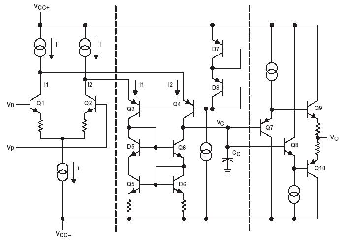

millwood said:
not really. Most modern CFB opamps use a LTP input stage, 🙂.
the key is actually the 2nd stage: does it have a transimpedance amp or a voltage amp.
Not at all. By CFB, the op amp manufacturers mean an amp
where the input stage is a unity gain buffer connected s.t.
the buffer input is the op amp positive input and the buffer
output is the op amp negative input and the output voltage
is proportional to the current flowing in the buffer output.
www.intersil.com/data/an/an9420.pdf
focus.ti.com/lit/an/slva051/slva051.pdf
focus.ti.com/lit/an/sloa021a/sloa021a.pdf
I would think they know what they mean themselves, at least. 🙂
aren't you guys really into this thing or what?
here is an amp. Tell me what it is an VFB or CFB.
