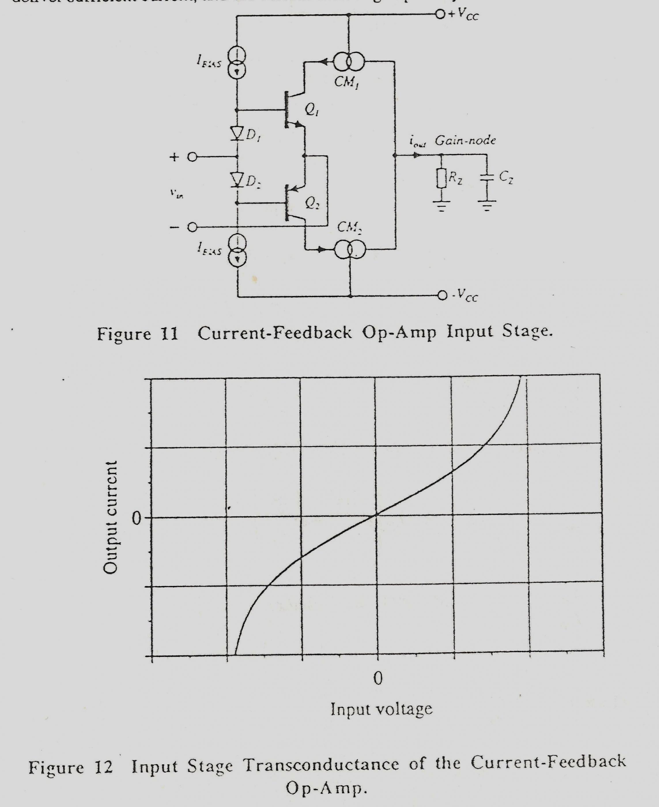

The current that drives the gain node i.e. the Ccomp flows in the feedback network. Can you deny this (that's where the high slewrate comes from to)?
High slew occurs in "CFA" arrangements in which two complementary common emitter transistors are connected in parallel (emitter to emitter).
The input stage then operates in class AB when required to meet the current demands of the shunt (grounded) compensation capacitor.
The current that drives the compensation capacitor does not flow in the feedback network: the two are isolated by the output buffer.
Yes it does as do all error currents. The current that slews the capacitor does but the signal displacement current doesn't. It comes out the emitters (-input) where does it go? The capacitor is usually to ground (simple folded cascode).
True, at least partly:
One half of the complementary input stage sources current to drive the compensation capacitor while the other half sinks it, except where the input stage is forced to operate in class AB, in which case the feedback network must sink or source current.

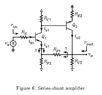

See fig 6 on pg 8 here:
http://users.ece.gatech.edu/mleach/ece3050/notes/feedback/fdbkamps.pdf
Also, read the text associated with this figure (section entitled "Transistor Example"); you should quickly realise that CFA is a complete misnomer, as it confirms everything I've said on the subject..Note that the table 1 on pg 2 corresponds with my definitions here:
http://www.diyaudio.com/forums/soli...current-feedback-amplifier-8.html#post3414948
Sorry MK, but fig. 6 on page 8 does not confirm you at all. Look at the input bjt Q1. It is an emitter follower. But the output bjt Q2 is a common emitter. This Q2 is different from the output stage of a CFA. The CFA output is an emitter follower, not CE. An EF has a low output impedance, a CE has a high Z. An EF output forces a constant voltage across the load and the feedback network. At the other end of the FB network, in a CFA, is the output of an EF, also a low Z output, buffering the input signal. With CFA, the fb current varies inversely w/ fb resistance. As Rf is lowered, If increases so that the cap is charged faster.
But looking at fig. 6, page 8, the output is a CE stage, i.e. the collector drives the fb resistor and load. This is high output Z constant current. Lowering Rf does not increase current as much as in the EF output stage. Rf and Rload divide the current, so that if Rf is lowered, the output voltage is lowered with Rf carrying a larger portion of the EF collector current.
The 2 outputs are quite different. Also, the input stage for a CFA is EF, not CE, not CB. The feedback current at the emitter node of the input EF can be said to stimulate the emitter of a CBstage. But the "gain" of this stage is NOT "Rload/Re". This stage drives a current mirror and the other branch drives the capacitor in the TIS. Hence even though you can argue that the input emitter node is driving the input buffer in CB or CE mode, the voltage at the collector is not the stage output, rather collector current is.

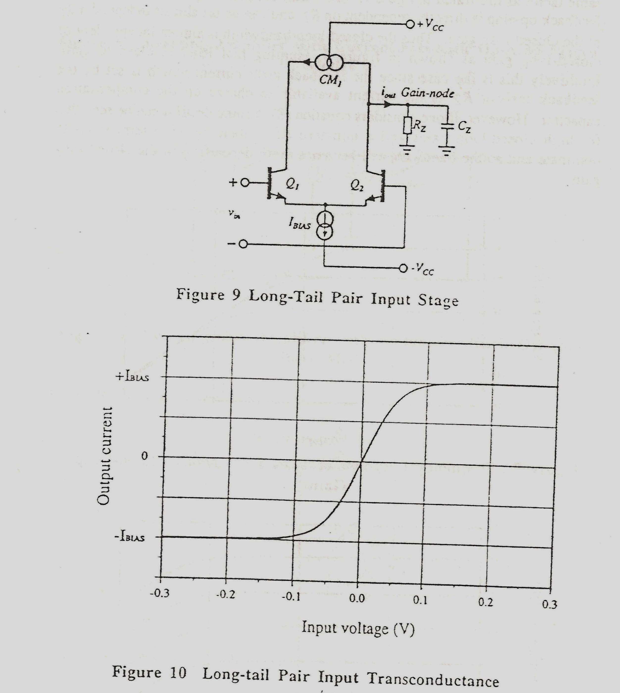

Here is my summary on this subject. For audio, I am not convinced that CFA is a better choice than VFA. I haven't tested them so I cannot say if one is better. Maybe I'm prejudiced, but for audio frequencies, I would favor the VFA. A VFA has lower output error due to input current amd voltage offsets. Also, the error due to bias/offset current can be reduced with proper R value in the noninverting input.
The emitter coupled pair in a VFA input is really good. The ecp would not be the only game in town for 6 decades if it were not the best. It rejects differential input errors/noise, has only 2 devices requiring matching, provides 1 terminal for input, another for feedback, very good topology. CFA is great at video speeds, and where low frequency and dc performance are not as critical. So if I had to develop an audio amp, I would evaluate both, but VFA is what I now favor.
