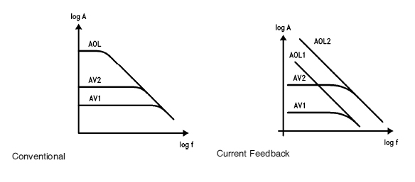

But if you think about it, the node impedance may be low, but the current into it is also determined by the voltage difference between that node and the input. jan
Forcing zero voltage and zero current are the same thing. You can analyze a CFA by taking only the current in as the feedback signal and arrive at the same answer. Jan this stuff really is simple, just review forming the classic a/(1+af) equation for the different feedback configurations.

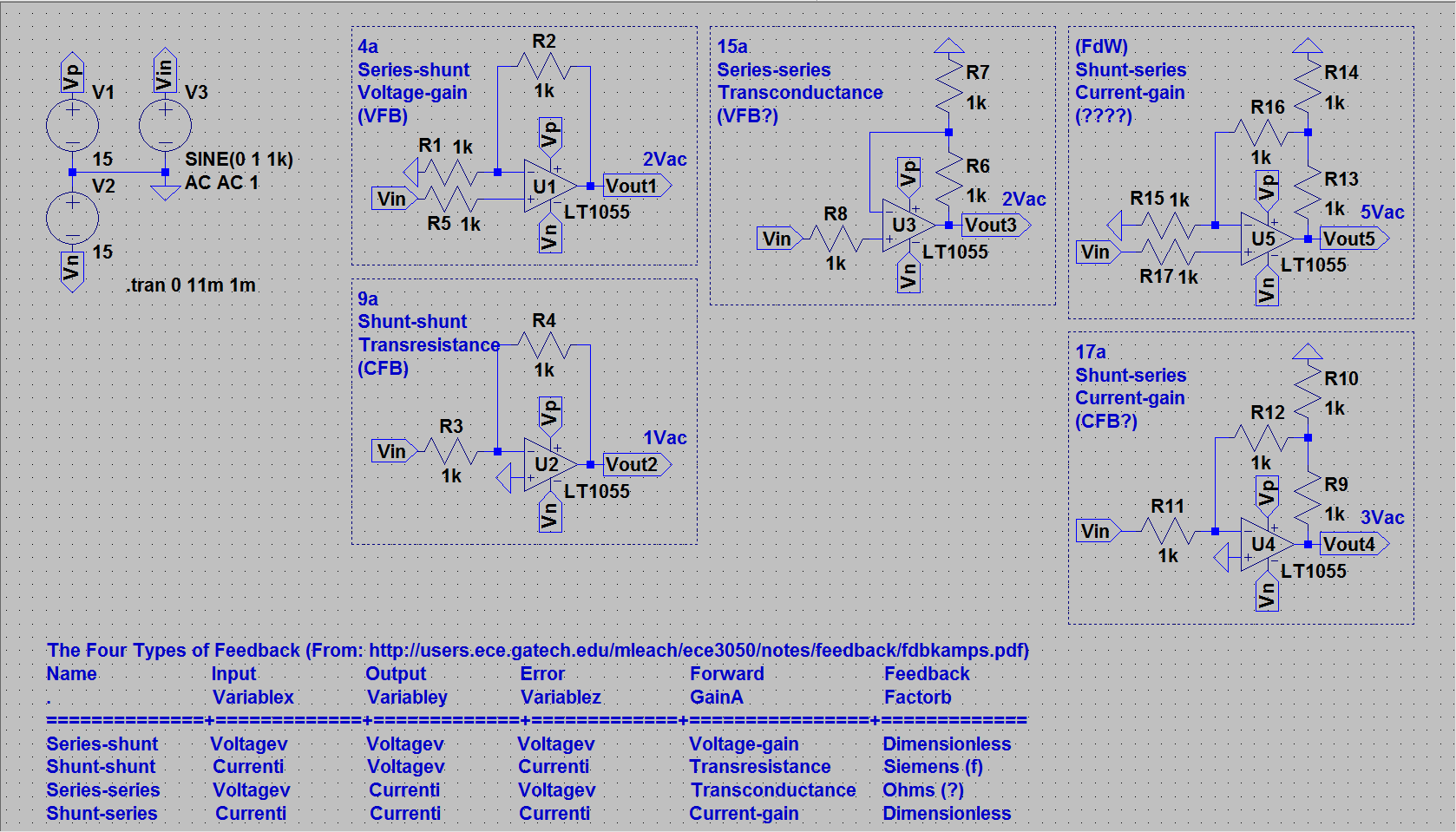

And here is my little contribution, based on this paper http://users.ece.gatech.edu/mleach/ece3050/notes/feedback/fdbkamps.pdf there are 4 configurations, all four to be found in the attached schema. Strangely enough (for me at the least) there is a 5th 🙂. My questions remain, how to call the 4 types, VFB, CFB, ... and it that really a 5th?

The variation shown in your diagrams is due to the fact that the basic gain equation of a common emitter stage is Rload/Remitter.
The input stage of a so-called "CFA" is a common emitter stage, and because the feedback voltage divider is returned to the emitter of this stage, the forward gain of the amplifier also changes as the resistors of the feedback network are changed.
As I've pointed out, this is the means by which the apparent bandwidth is changed.
Well, these are the 'official' gang of four 😉 http://www.linearaudio.nl/linearaudio.nl/images/pdf/leach_feedback_basics.pdf
Don't know about any 5th...
Edit: same link as Mike's... sorry.
Anyway, Mike, I believe you meant that emitter of the feedback node to be a common base stage, not a common emitter stage (from the pov of the feedback network).
jan

Well this is a bit of a strange reaction, it credits the link that I found to Mike and then ignores what I am asking (and remarking) completely. Maybe I was not clear enough, and do I need to explain myself a bit more.
All documentation that I can find talks about 4 models, as in the linked paper, but we (here at DiyAudio) are talking about CFB or VFB, can someone please explain how this reflect to the 4 models. In other words, what models are VFB and what models are CFB?
If these models are looked upon, one can see that if 9a(shunt-shunt) transforms 17a(shunt-series), as in the linked paper, then 4a(series-shunt) should transform into (FdW)(the 5th model). The question is, is this a just observation, and how should it be called, or where am I wrong?
As the tittle of the thread is 'Current feedback - Voltage feedback, how do I see the difference?' 🙂 I thought that a picture may say more than a thousand words, so a annotated picture might help 🙂 a bit 🙂
Sorry Frank, I wasn't crediting Mike with the link, but didn't see him putting it up before I put it up myself.
There's no correspondence between the four topologies and the CFB/VFB terminology. The four concepts concern itself with what you sample at the output (current or voltage) and how you add the feedback signal to the input signal (in series or shunt/parallel). The reason is that this immediately shows the effect on the amp: decreased or increased output Z, and increased or decreased input Z.
The CFB/VFB terminology came en vogue after Elantec designed the first opamps with a low-impedance (emitter) feedback node which had some favourable effects on the bandwidth and called it current feedback. Must have been late 70's? But it doesn't say anything about the effect of the feedback on the amp, because you can still use this 'CFA' with either current or voltage output sampling to make an amp with zero or infinite Zout.
So we're stuck with two different ways of looking at feedback, which have no correspondence.
