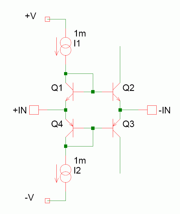

I can't resist.
Attached, Mr. Knowitall, you'll see a simplified schematic of an input stage of a so called CFB opamp .
You won't tell me that there is no unity gain buffer between the + and - input, do you?
I think Mr. Jung does know quite enough about opamp's even if he was not the designer of these AD products.
Enjoy, Tino

zinsula said:
I can't resist.
Enjoy, Tino
Now, i can't resist, it does exactly what an opamp is supposed to do, amplify the difference between + and - input. Your circuit will have identical collector currents for q2/q3 if both inputs have the same voltage... no unity gain, zero gain 🙄
Mike
