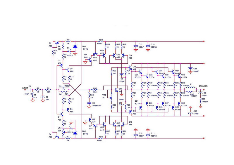

I looked at your site.
How do you achieve 1200V/us slew with 100pF capasitor to ground as compensation?
Charging current seems to be 120mA if my calculation is OK. High...

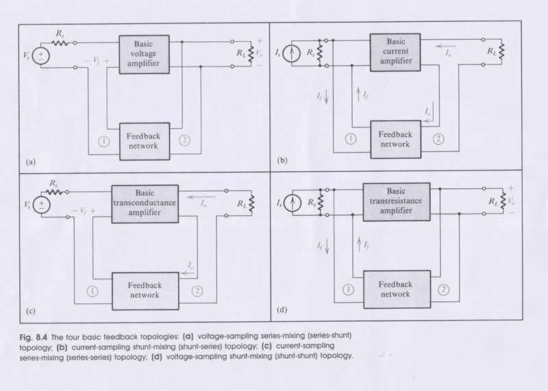

mikeks said:PM...there is nothing to recommend so-called 'current feedback' in audio applications, unless such a topology is used as part of a compound output stage with gain in excess of unity.
Why?

Hi ANALOG GUY,
Your schematics seems very similar to a circuit from Stan Curtis used in the first Mission Amplifier, a Lecson amplifier and a DIY class A project published in ETI.
mikeks said:
Not true...
As far as I remember you don'teven accept there are such things as CFB amps, so how can you have an opinion on their properties? 😉
That said, I also find Jacks comment puzzling and asking for a clarification.
Christer said:As far as I remember you don't even accept there are such things as CFB amps...
Actually, this also is incorrect.....current feedback amps DO exist, as a matter of fact.
These, by definition, possess series (current) derived-shunt (current) applied negative feedback.
The so-called 'current-feedback' topology is, in fact, merely shunt (voltage) derived-series (voltage) applied negative feedback implemented with an unusually low-impedance feedback voltage divider.
OK, but that is the usual confusion with conflicting terminologies, and I assume your previous comment was referring to what others call CFB in this thread and which you do not acknowledge as different from VFB, or have I entirely misunderstood our previous lengthy discussions on this topic? Oh well, I don't want to start those discussion over again. 🙂
Christer said:.....I assume your previous comment was referring to what others call CFB in this thread and which you do not acknowledge as different from VFB.........
Correct..
This is also the definition I was tought.....
