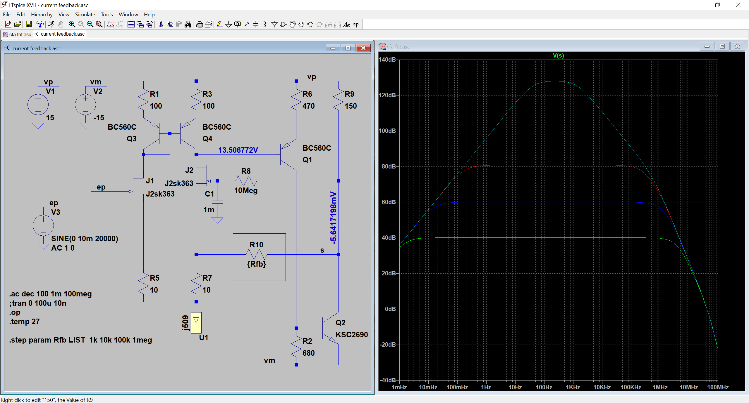

It shows that the ratio of the AC signals Ic / Vbe is unequal to gm (1mA/26mV in this case).
I can't really follow how you drew this conclusion, but it is certainly wrong for a small signal analysis. If you think of a large signal analysis, then the transconductance is modified by many factors, at any moment in time, so I don't know how you would isolate a particular contribution. Sorry, I'm not a LTSpice camper, so I can't help interpreting the results straight from the simulator output.
But if vbe gm were the only thing occurring, then we would see an equality between these terms. Since we don't, there must be another mechanism that explains this. There is - the Early effect, demonstrated by the Hybrid Pi model (for small signal low frequency operation),
Once again, for a small signal analysis, gm=constant whatever way you slice it and dice it. Also, the only way the Early effect is modeled for the purpose of a small signal analysis is through a constant Early (direct and reverse) voltages, hence a constant ro.
MOSFETs, JFETs, tubes are purely VCCSs. There is no alternative way to model them for small signal purposes, there is no Early voltage to tap into, but a (JFET, MOSFET) channel length modulation factor that creates a finite output impedance.
I still fail to see the dragon you are trying to slay through all this argumentation. If I can prove you mathematically that all CFA small signal properties (constant bandwidth for a range of closed loop gains, whatever else you can think of) can be obtained by a black box formal analysis of a shunt output, serial input feedback topology, would that persuade you to understand there's no dragon to slay here?
Please re-read what I have written. I have never, ever claimed that gm changes with loop gain. Ever! You have obviously confused me with someone who has.
I have demonstrated with LTSpice, and have derived using the small signal AC low frequency Hybrid Pi model of a transistor, that the ratio ic/vbe of AC signals for a CFA inverting input transistor is unequal to gm (which is constant regardless of loop gain!) when the CFA operates in a closed loop.
This occurs because vbe is reduced by loop gain and therefore so is gm vbe, but vce is not, and so vce / ro is unaffected by loop gain. The currents produced by the two effects subtract at the collector and emitter terminals. Accordingly, as loop gain increases, gm vbe approaches vce /ro and we are left with the inequality.
If you can't simulate with Spice and you can't analyze a CFA using Hybrid Pi transistor models for input transistors, there is no way you can see this effect, and there is nothing for us to discuss. If you think it would help you see what I am talking about, I can forward the algebraic analysis.

A small simulation (attached figure) shows that the input transistor which receives the feedback voltage, does almost not change its Ie and Vbe with or without a buffer.

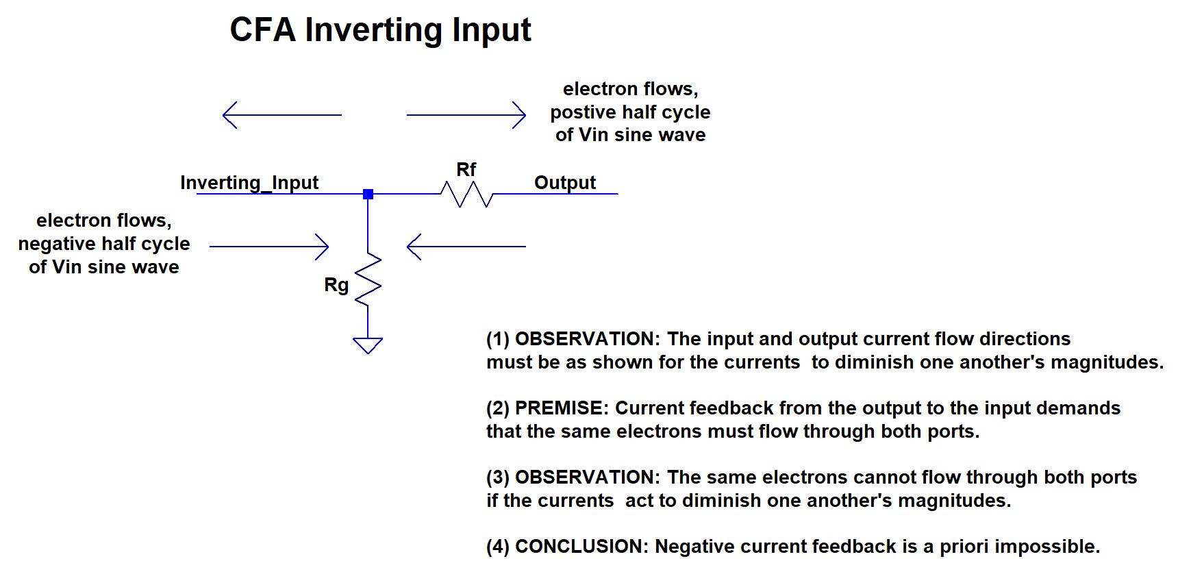

Please address the assertion in the attachment.I don't understand.
I just wrote I = V/R. you connect a resistor on a voltage source, and you have current.
Yup. And derived from conservation of current at a node, a current flows through a resistor and you have a voltage. You make no distinction between a voltage controlled current source and a current that flows through a resistor because of conservation of current.
Yes, I demonstrate it is a voltage feedback.
Not that I can see.
May be still my poor english, but you say that emitter current flows through collector, no ?
No. I say that all collector current flows through the emitter.

Have I anywhere attempted to put in your mouth "gm changes with loop gain"? If so, I apologize.
OTOH, I really don't understand why you would think the ic/vbe (as a ratio of small AC signal amplitudes) relationship with the (bias point defined, for a small signal analysis, always constant) gm=Ic/Vt is relevant in this discussion. In fact, I also fail to understand why ic/vbe is a relevant metric for any purposes, (dimensionally is the same as a transconductance, but that's where any resemblance stops).
But it's likely my total inability to follow your rationale and get your points.

Will you please respond to the reasoning that your claim leads to? You have said that because no output stage current flows into the input stage, there is no current feedback in a CFA.
But for negative current feedback to exist, input and output stage currents must mutually diminish. If they do, their directions must be such that the current from one stage cannot enter the other. Therefore, negative current feedback is impossible.
Ignoring this logic is not refuting it.
So if you say NOW that negative current feedback is not impossible, you should have no problem giving us an example in which no output stage current flows into the input stage, right?
