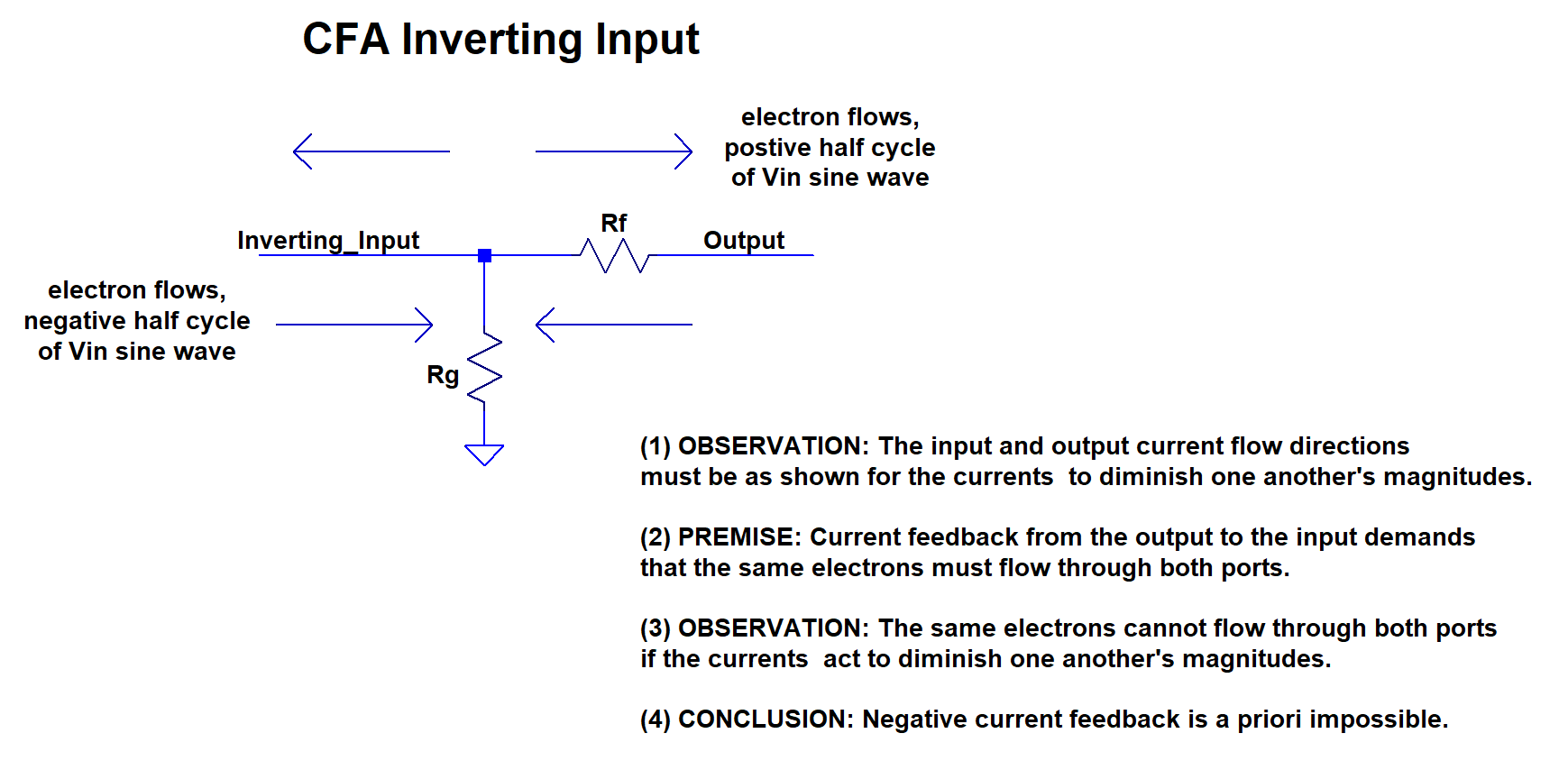

Please tell me what you disagree with in the following screen shot:
The consequence of your premise is clear: it assumes your preferred conclusion! Your premise is disputed by applying conservation of charge at in (-) and writing the appropriate equation to establish the mutually diminishing interaction of the output and input currents: in (-) = I(Rg) - I(Rf). Clearly, the output current affects the input current and the collector current itself in the prescribed, simple manner.
(1) To describe the transistor as operating as a voltage controlled current source only is false. A more complex description is required.
(2) Regardless of loop gain, almost all of the current flowing through the emitter at in (-) always flows through the collector, and into the low impedance input of a current mirror.
Finally, please explain how, when global AC feedback is removed and an excitation is applied to the inputs of a 400MHz VFA and a 400MHz CFA in a test developed by Hans Polak and modified by me, the responses of the circuits can be so different if they both operate employing the same type of feedback?

You get it! But you do realize that up until now, we were living with "the transistor is a perfect transconductor paradigm"? The previous understanding was simply wrong. It most obviously is not - it's also a simple resistor.
Realize also that this analysis poses no danger to the current feedback paradigm: the collector current, which controls the output, is still virtually identical to the current entering in (-). Such a simple explanation - contrast it with the complexity of the explanation now required to support the voltage paradigm - Ptolemy when Copernicus would suffice.
This is a proof that the transistor is voltage driven.
A current travels through ro. ro terminates in a low impedance current mirror input, almost AC ground. Of course there will be a voltage across ro! Were there not, Ohm's Law would be violated!
I do believe that your way of looking at this circuit requires us to conclude that current feedback is impossible, simply because there's always a voltage involved.
What controls I(Rf) and the whole loop is too often forgotten.(2) Regardless of loop gain, almost all of the current flowing through the emitter at in (-) always flows through the collector, and into the low impedance input of a current mirror.
Not false, incomplete. But sufficient to analyze most circuits.(1) To describe the transistor as operating as a voltage controlled current source only is false.

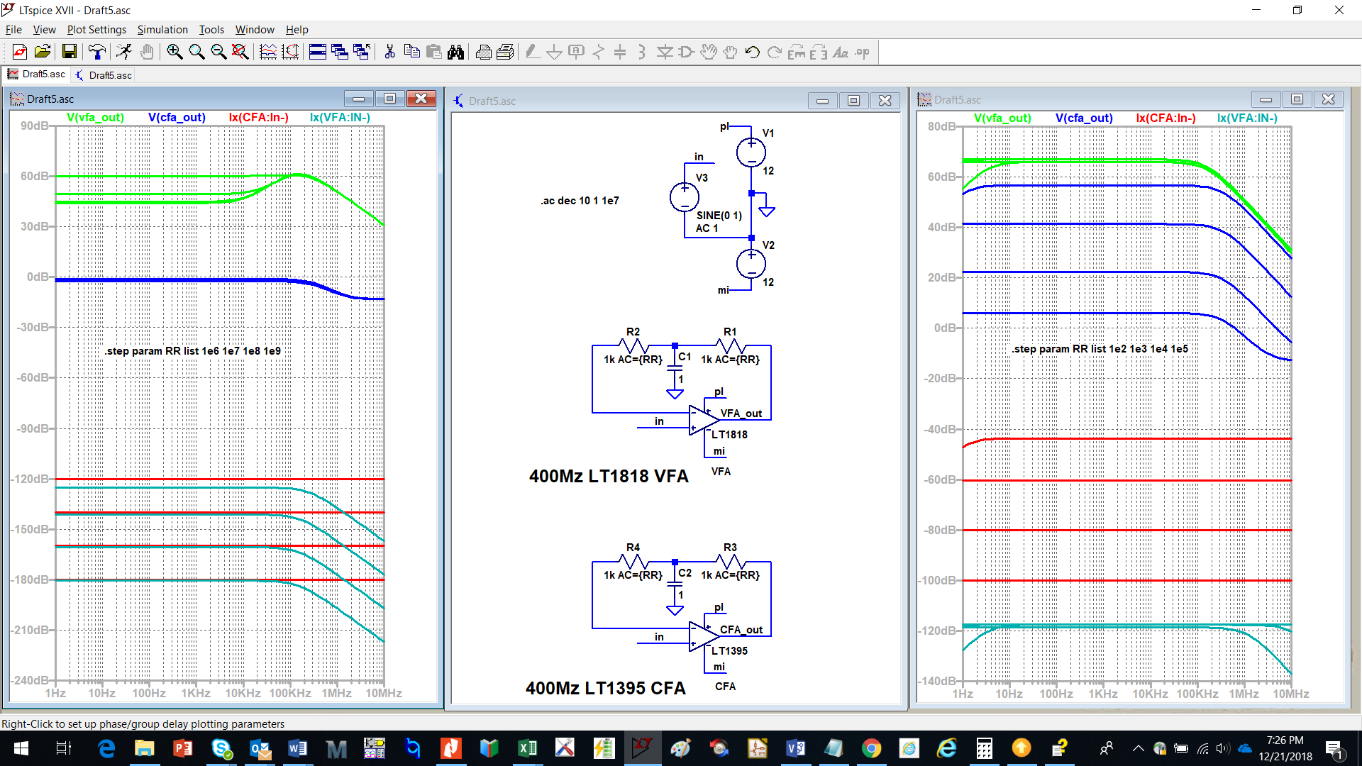

How clever a comeback to use as an excuse to avoid answering the question. Here's a second chance; I hope you won't duck it again.I am not sure of being the right recipient of your beautiful drawing with beautiful arrows.

The first part of the claim is attached. The next part follows:
And here's the reply:
The reply is obviously not an answer; you avoided the question.
Your premise that current feedback demands that some portion of the output stage current must also flow in the input stage inexorably leads to the conclusion that negative current feedback is impossible.
And oh, yes, and then there's the question of why two circuits, deprived of AC feedback, with supposedly identical types of input stage feedback, have such obviously different responses. No answer there either.

You may be unfamiliar with the Hybrid Pi model. OK, consider instead Post 1028. It works with transistors only. It shows that the ratio of the AC signals Ic / Vbe is unequal to gm (1mA/26mV in this case). But if vbe gm were the only thing occurring, then we would see an equality between these terms. Since we don't, there must be another mechanism that explains this. There is - the Early effect, demonstrated by the Hybrid Pi model (for small signal low frequency operation), as well as by the more general Ebers-Moll/Early: ic = Is exp (vbe / VT) ( 1 + Vce/VA ) . If you reject this explanation, how do you explain this obvious inequality?
Half of the emitter/collector transistor current flows from the output through Rf (unity gain) or Rg (non-unity gain), through the resistive Early Effect and terminates in the low Z Current mirror input into which current flows, across which voltages are NOT impressed. The transistor is NOT acting like an ideal voltage-controlled transconductor.
You have said that because the Rf current does not flow into in(-), there is no current feedback. But if the Rf and in(-) currents are to diminish rather than augment one other in non-unity gain circuits, their directions must be such that the Rf current cannot flow into in(-). I have simply added this fact to your assertion to arrive at the obvious implication: negative current feedback is impossible. And I mean by this term the feeding of current to a point in a circuit in which it, not a voltage it creates, causes a change in circuit operation. This excludes the case where a load current is controlled by a VFA - no current is fed anywhere but to ground in such a case.

I just wrote I = V/R. you connect a resistor on a voltage source, and you have current.
Yes, I demonstrate it is a voltage feedback.Remember, I have never claimed that there is not a relationship between voltages and currents. You're fighting a straw man. It is you and forr who are claiming that there is no feedback of current even though Ic is approximately Ie, and Ie is equal to a simple difference between the Rg and the output stage currents.
How do you get this from "almost all of the current flowing through the emitter at in (-) always flows through the collector"? Original indeed! There is nothing in that phrase that references current origins.
May be still my poor english, but you say that emitter current flows through collector, no ?
No.So specific that it's the termination of the input stage collector of just about every CFA IC ever made?
Two identical types of input stage ?Oh, come on! Don't hide behind that canard! If the VFA didn't need DC feedback to avoid railing the output, the circuit could have simply involved the source, R2 and the op amps! You need help understanding something as simple as that?
The most likely reason for your reply is that you can't explain why two identical types of input stage feedback could yield such different results. Here's a second chance again.

- Current Feedback Amplifiers, not only a semantic problem?
