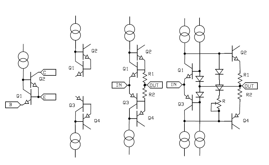

One final piece in the jigsaw, about the development of the CFA, is that VFA IC's did not have fast PNP's until the 1990's so they couldn't make really fast fully complementary opamps. When the CFA was developed, fast PNP's had just arrived, making them faster than VFA's. Applying the same methods to VFA's you get similar speeds as CFA's - read the IEEE Erik Brauun paper, last line of the summary, it's on Jan's website https://linearaudio.nl/sites/linear...nalysis-of-Transimpedance-CFB-OA-Circuits.pdf
So the 'CFA' name is not about a different feedback arrangement - it's about a different internal topology. Convert the CFA topology with two high Z inputs and you have a new VFA topology with pretty much the same performance figures.

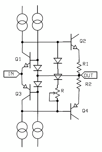

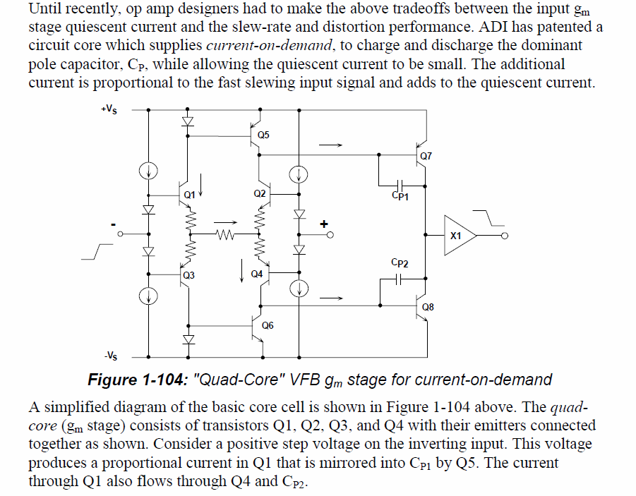

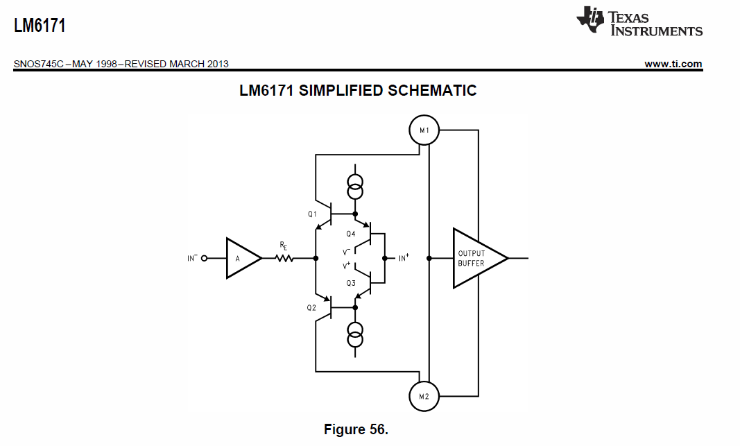

Attached are some fast VFA's -- they are CFA's with two high-Z inputs. And there are still only 2 stages to compensate. Walt Jung's book is here http://www.kelm.ftn.uns.ac.rs/literatura/mpi/pdf/Op Amp Applications Handbook.pdf
BTW I found Scott Wurcer's tiny CFA http://www.diyaudio.com/forums/atta...2874415-fully-complementary-ad797-blesser.jpg; it's a little gem. I have simulated it and has great potential for audio power amps and it works great with MOSFET power transistors as well. The post is http://www.diyaudio.com/forums/solid-state/306797-fully-complementary-ad797-3.html#post5059708
