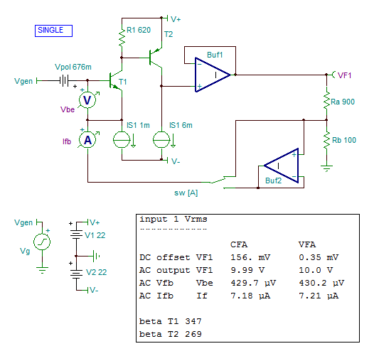

Simulation shows that buffering the signal from the feedback network, just like it happens with a long tail pair input stage, makes the circuit an indisputable VFA. You can see that it has very little effects on the current and the voltage involved in the feedback signals around the device in charge of the subtraction process.The fact that the base is also driven independently does not change that; it is common base from the signal view point. Google 'superposition'.
Looking at these two circuits with the name 'VFA' and 'CFA' is a clear, unambiguous and correct naming convention that prevents confusion and promotes communication.
To summarize, a VFA tends to look like a buffered CFA, if we admit that these acronyms have any meaning.

"Simulation shows that buffering the signal from the feedback network, just like it happens with a long tail pair input stage, makes the circuit an indisputable VFA. You can see that it has very little effects on the current and the voltage involved in the feedback signals around the device in charge of the subtraction process."
At DC I would expect little or no difference whatsoever. You have in inverting input, a non-inverting input, an amplifier with gain and a feedback network.
What is the point you are trying to make here?

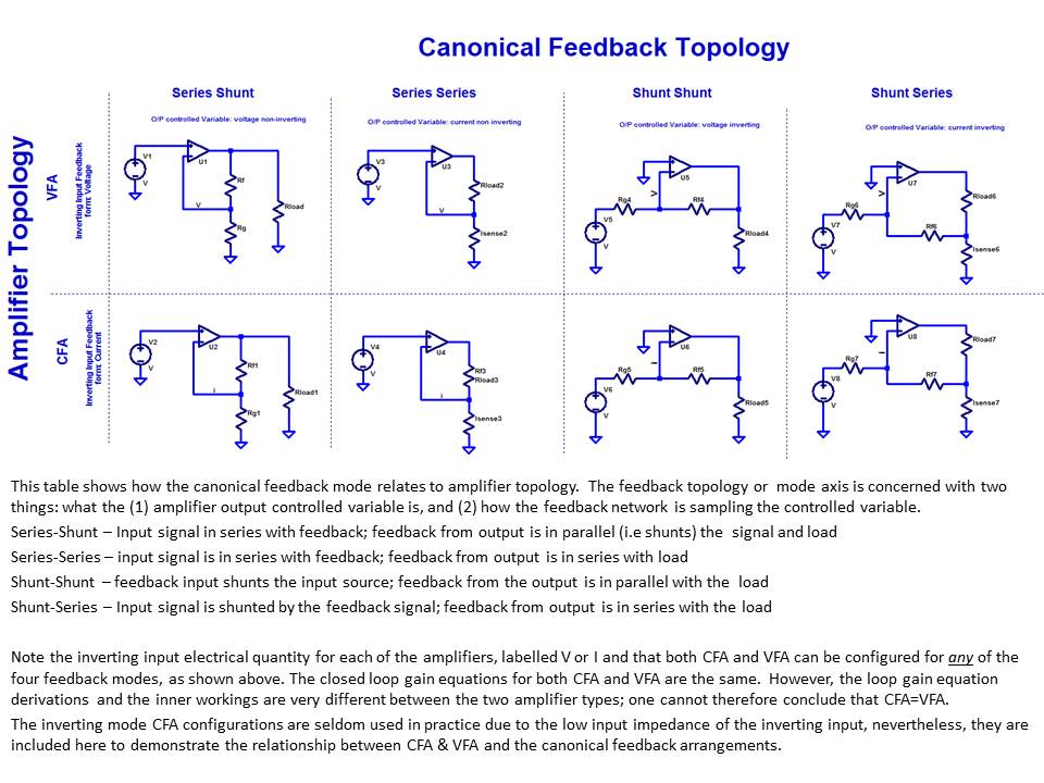

Don't confuse current feedback amplifiers with current output amplifiers - they are not the same thing.
Voltage Output Amplifiers
VFA: Voltage output>voltage sampled>voltage feedback (feedback into hi-z - input)
CFA: Voltage output>voltage sampled>current feedback (feedback into lo-z 'current sink' - input)
Current Output Amplifiers
VFA: Current output>current sampled>voltage feedback
CFA: Current output>current sampled>current output
Yes, it shunts out nested local feedback in the 1'St stage through resistance of the main feedback loop. 😀
I tried to make clear :What is the point you are trying to make here?
- that, whether the feedback network be buffered or not, the device of the input stage in charge of converting to current the difference betwen the signals present at the non-inverting and inverting inputs is governed by one principle only, which is transconductance.
- and, as a consequence, that, M. Kiwanuka is right in contesting the specious concept of Current Feedback term applied to a topology of amplifier input stages.
forr,
instead of delivering the displacement current via the lo z feedback resistor network, you are simply delivering it from the opamp output. The - input is not the feedback buffer + input. It is still the lo z input port at the transistor emitter.
This does not prove that CFA = VFA or that there is no such thing as CFA.
Mikeks is smart and argues pursuasively but his premise is wrong.
Why not? To me forr's circuit including the buffer looks like a valid nullor implementation. Of course you can also look at it as an amplifier with an extra buffer, whatever you find most convenient.
As I pointed out before, in the "current" mode the 1'St stage has a local feedback by current due to a resistance of a feedback loop, in the "voltage" case it is simply shunted. I.e. it is a nested feedback that has different values, while the global feedback by voltage stays the same. Well, almost the same, since local feedback decreases OL gain.
You have not changed the fundamental operation of the input stage compared to a VFA in my view - you have simply hidden it behind a buffer.
