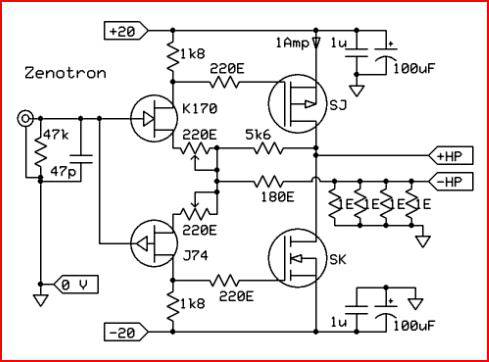

You are all wrong 🙂 CFA is a poor name for a topology that uses both positive, current feedback, and negative voltage feedback.
Do you mean something like this ?
Ketje
IMHO both feedback loops operate in current mode , since both loops controls input pair source current flow which also represent relative low Z node.
