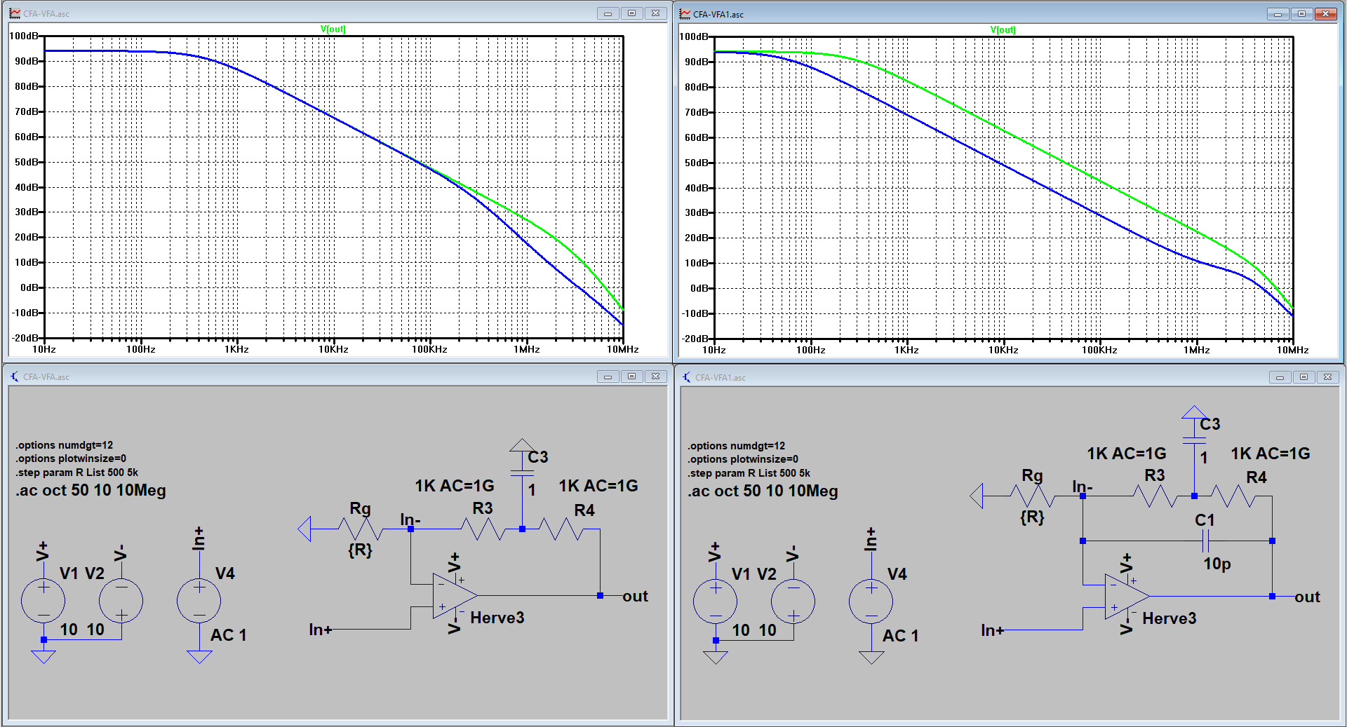

It calculates loop gain. And the result is used to classify the DUT in the VFA or CFA category, depending on the predominant feedback mode.MDIT does not deal in classifications. It does not identify topologies. It measures loop gains.
To be a CFA in inverter mode, there would have to be a signal applied to what is in this circuit the ground terminal of the feedback network, which there is not. In MDIT, there is neither the standard inverting nor the standard non-inverting mode operation. Signals which would be applied in such situations are set to zero. Instead, signals are applied inside the loop, where they would never be in standard operation.
Signal is applied on inverting input, non inverting input is grounded, DUT is in inverting mode. I agree this is a non standard inverting mode.
I confirm it is not the same simulation scheme.It is not the same test if you apply a signal to In+. In such a case, you are not measuring loop gains.
The simulation shows that when the DUT is in "standard" working conditions, as the In- impedance is increased by the feedback, the ratio between fraction of injected voltage signal present at Rg and Rf common node and the fraction of injected voltage signal present at In- is far lower than the ratio between fraction of injected current signal flowing in Rg//Rf and the fraction of injected current signal in In- . This indicate that predominant feedback mode is voltage.

Are you talking about setting In+ to zero and inserting a voltage source between ground and Rg? I would consider this to be the standard inverting mode, which I agree is rarely used with what the industry calls CFAs.
Suppose I connected ground-referenced voltage signal sources Vp and Vm to In+ and to the side of Rg which would otherwise be grounded. I set the outputs of these sources to zero - they are effectively short circuits. I also connect the two sources I need to run MDIT, which I then execute. I obtain current and voltage loop gains and determine the predominant form of feedback.
Next, I zero the outputs of the MDIT test signals (returning the circuit to "normal" operation), and allow Vp and/or Vm to take on non-zero values. If this actually caused the loop gains and feedbacks to change from what MDIT gave us, then MDIT would be totally useless - its results would be irrelevant to how the circuit is actually used. Why then would anyone pay attention to MDIT?
There is a reason that MDIT exists, and that to determine loop gains, it requires the In+ voltage to be zero and Rg to be grounded.

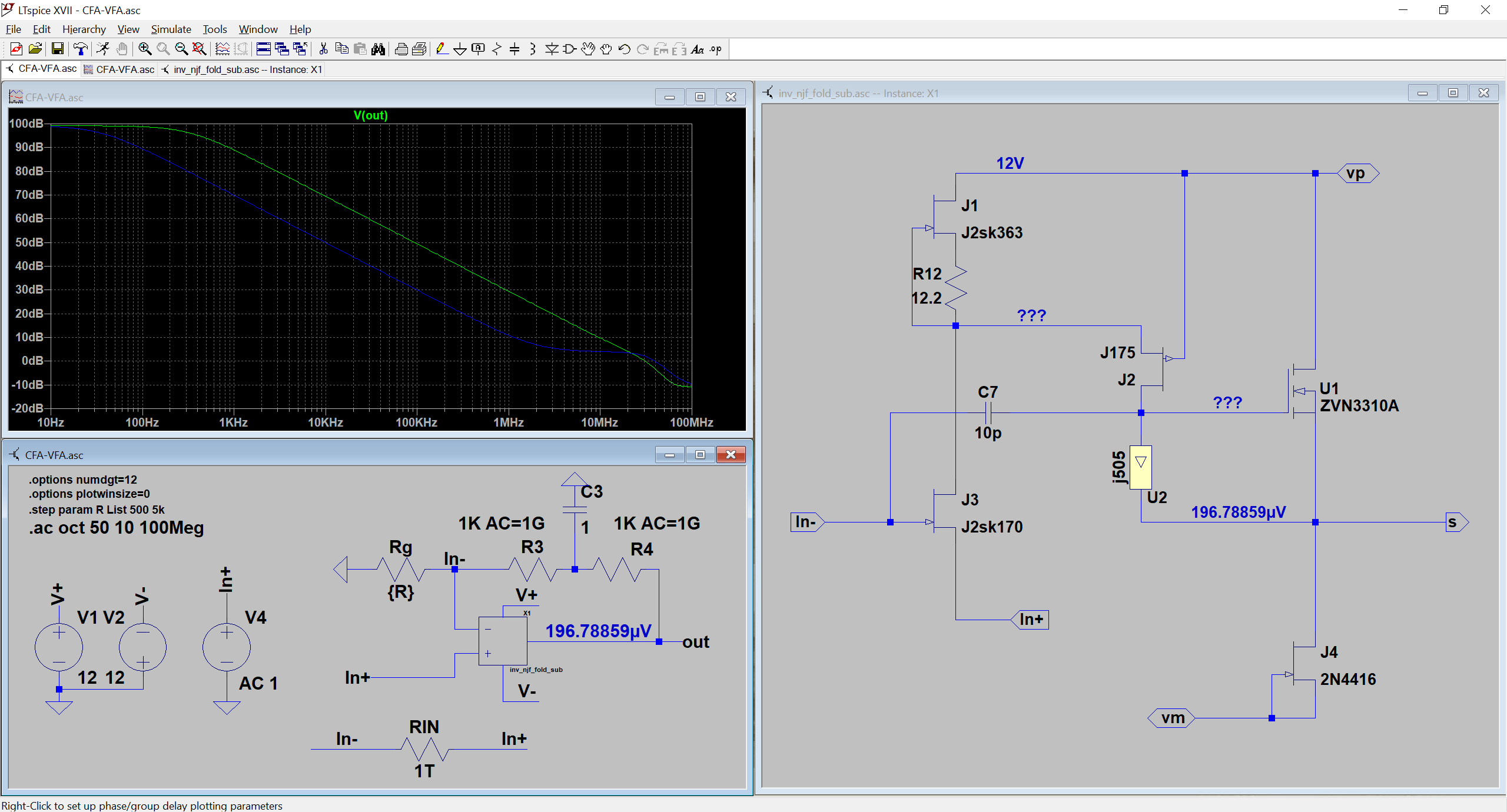

Hans,
My actual need is not to classify CFA and VFA. What I try to do is demonstrating that in almost "standard" use condition the predominant feedback mode in CFA is voltage.
To come back to your test, it seems it has difficulties to identify which input of the DUT is of low impedance.
As an example, you can see your test applied on a simple folded cascoded fet input amplifier (non optimized) we often use as charge or current amplifier where the negative input is high Z and the normally grounded non inverting input is the source of the fet.
I don't think we can classify it as a CFA as the fet current don't flow in the feedback network, but your test does it.
I simply couldn't believe that changing a source resistor to a Fet from 500 Ohm to 5K could have the effect that you were showing.
So I tested your "simple" folded cascode circuit, that is not that simple at all, since tuning R12 in your circuit comes utmost precise to 0.1 of an Ohm.
But the outcome of the test is shown below.
What you did internally was to place a 10pF cap from V(out) to V(in-), which I see as an external component, that should not be be there in this test.
I have shown the effect with and without this external 10pf, an of course this makes all the difference.
But even then it does not qualify as a CFA as you mention, because at 10Hz the 2 curves are lying on top of each other where a CFA shows parallel lines all over the FR up to 0dB.
I'm quite disappointed how unserious and ill prepared you were in trying to come with a "Prove".

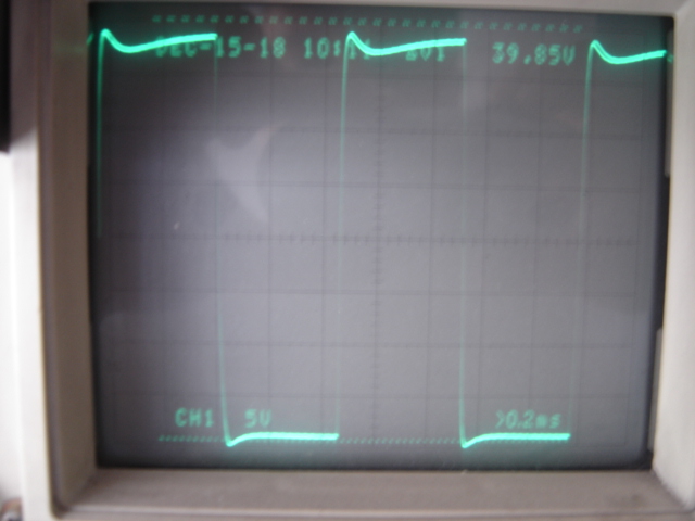

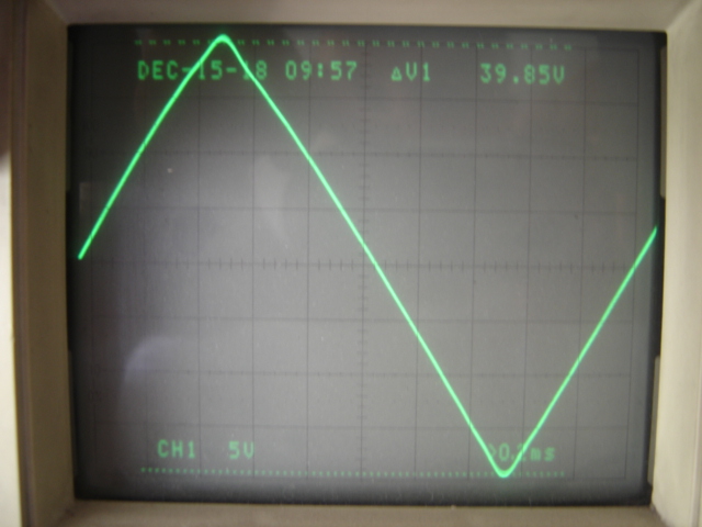

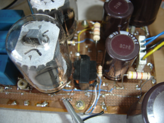

I'm trying positive current feedback in a compactron tube amplifier DC coupled via a current transformer, and it is very effective.
Hi Osvaldo,I'm trying positive current feedback in a compactron tube amplifier DC coupled via a current transformer, and it is very effective.
That sounds great !
Are you willing to show us the circuit diagram ?
Hans

Yes, but the amplifier is still under development. As advance, look these pics.Hi Osvaldo,
That sounds great !
Hans
