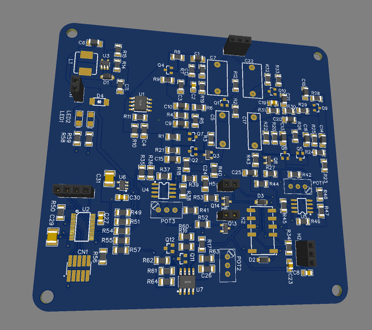

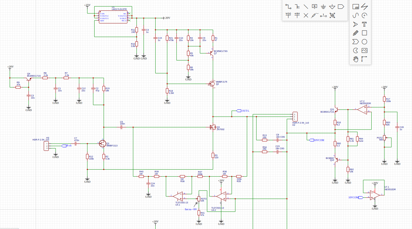

Schematic
Schematic of left channel, not including page 2, which contains various peripherals like the 5V to 24V boost SMPS, dual coil relay or MCU.
After playing around some more with simulation values, I will start off with R4 = 5.6k, for a bias current of about 12mA.
R10 + R11 ratio will be a little higher to attempt to squeeze 22V out of the LM317.
The drop-out may be little high if the input is exactly 24V, but we shall see.
I could've filtered the RHS so that the op-amp and the output stage of the V-GND in particular doesn't modulate the 20-22V positive rail. But the input stage is already hardened against line noise. Only the output stage maybe susceptible to modulation, but that's what the LM317 is for, anyway.

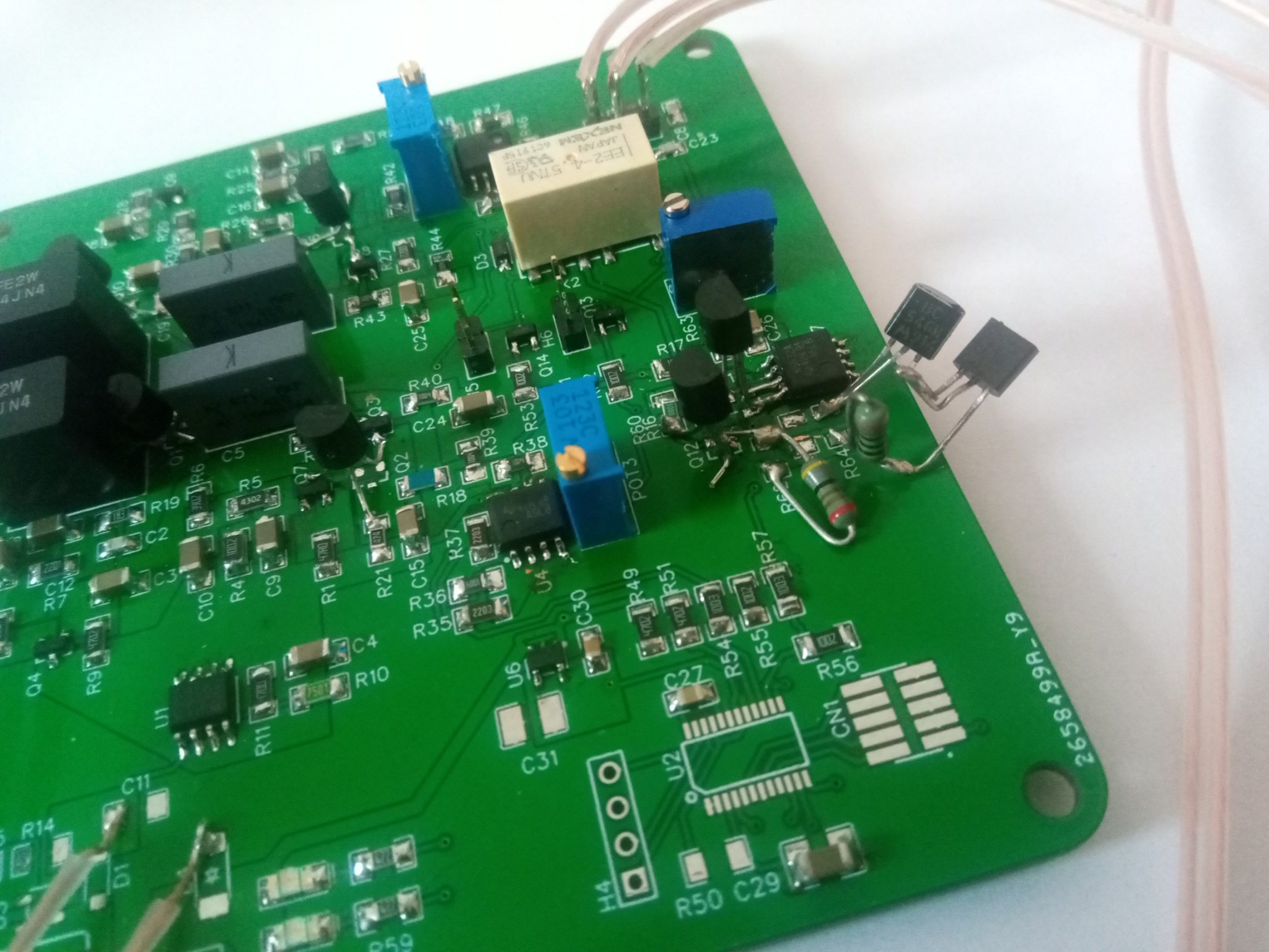

Freshly built. I'll try and put up a few pics and do more tests in the coming days.
The push-pull v-ground was too simple again, and goes into thermal runaway, which I haven't fully analysed yet. That'll learn me to cut corners 😉
It really needs a more stable design with a couple of diodes between the NPN and PNP bases.
Meanwhile, I did a simulation running a signal in reverse to modulate the v-ground and found that the main output stage followed it much better than I expected. Amplitude vs frequency plots across the headphone load showed a plateau of to 50-55dB of attenuation in the 100Hz - low kHz range. The output impedance was reduced in the sub-bass due to voltage feedback from the servo, and also at high frequencies but I'm not sure why just yet for the latter.

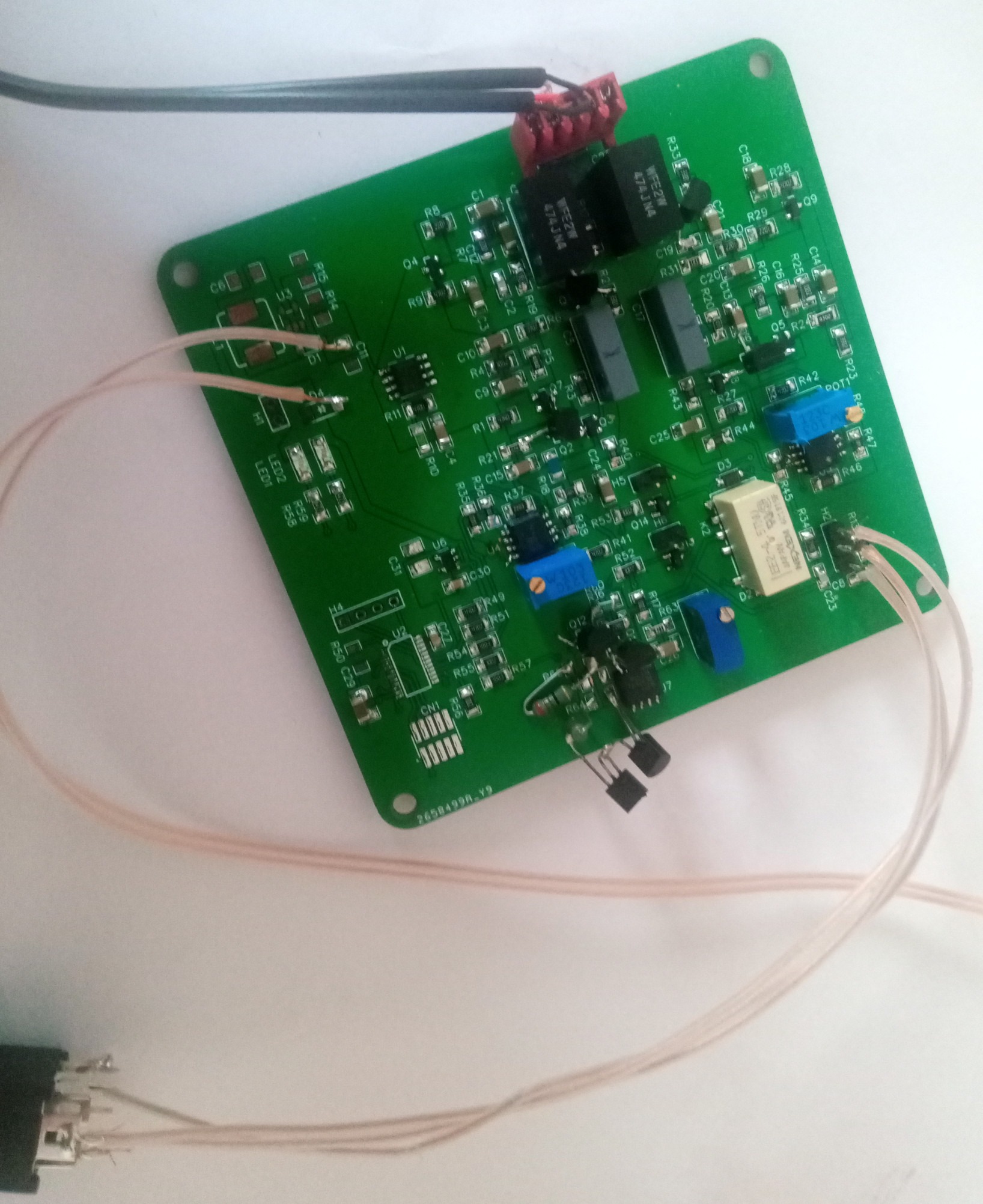

Just finished soldering earlier today.
There was a bit of debugging at first --accidentally ordered large SO-8 op-amps for the servos instead of slightly smaller SOIC-8, so that was fun 😉. But once that was fixed, it was a matter of turning the pots to get the offset to within a single mV, according to the Volt meter.

The mods look a bit brutal, but they work 🙂
Mods:
2 BC546's as high-performance diode drops + 100 ohm between the bases in the push-pull virtual ground.
Through-hole J113 and J175 JFETs because the surface mount MMBF versions were all out of stock :'(
24V plugged in directly (boost converter out of stock LOL.)
