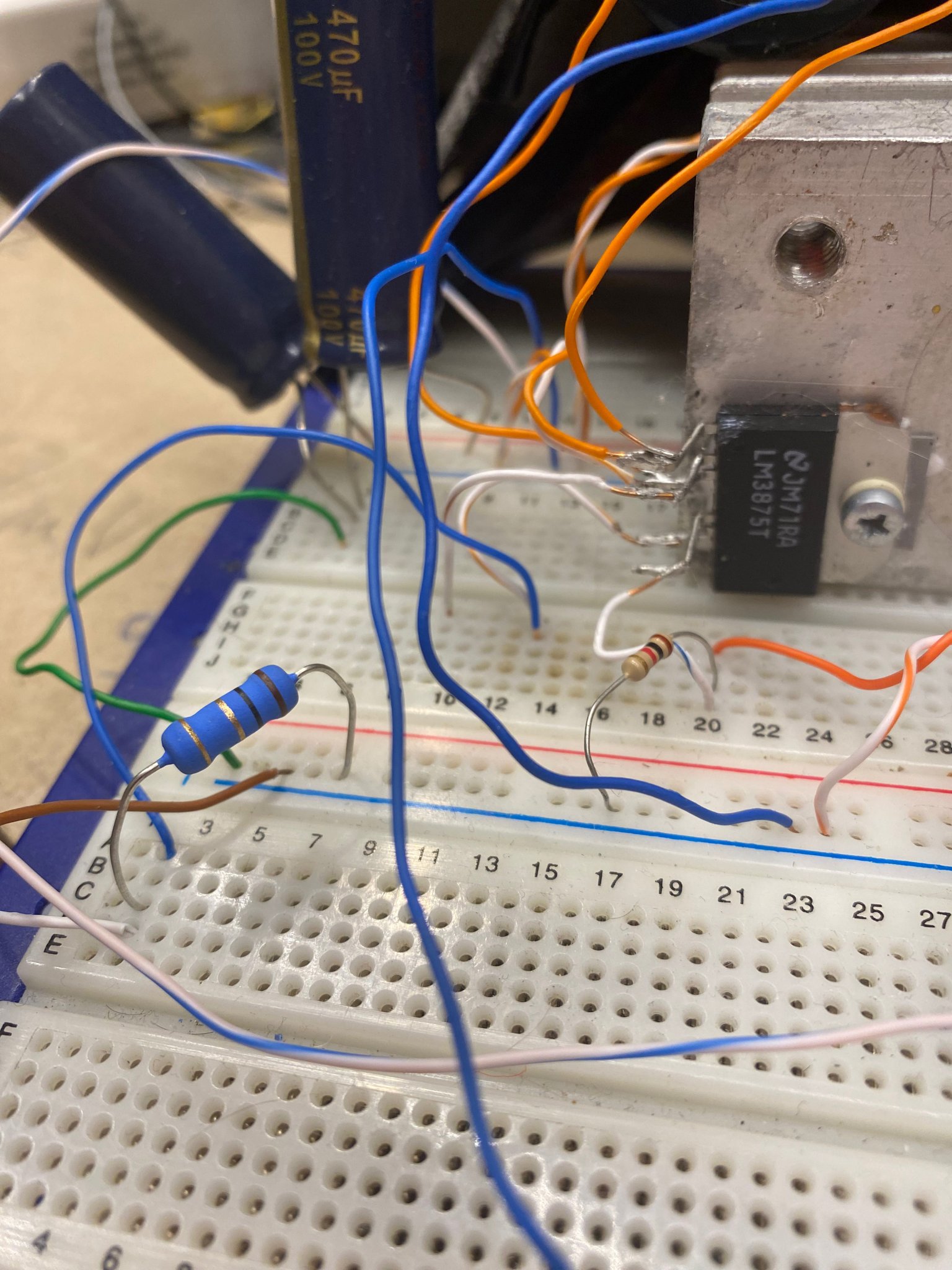

Why you see things so complicated in latest posts??? It takes several minutes to write a post and it takes 15min on a breadbord to assemble circuit as i showed in post #885. So why to write long posts and not to test and hear for yourself? You can get rid of that RC in parallel to the load if you are obsessed with output impedance. It will still work. Done many times. Don't need to be perfect in order to work.Now on table is this ugly current drive amp :) it is real working one, no parts missing. If you like grounded load do improved howland current pump circuit. Done that and it works perfectly based on discontinued LME49811. That was at least 10 years ago, still driving my 4way speakers. XXLS peerless woofers down to 20Hz equalised with current drive. Yes on paper not best to use current at resonance, but in reality
is better than on paper :) anyway thats why then i switched to mixed mode amps. But later discovered more ideas and on breadboard there are two very different output impedance amps now. And when i compare them i equalise to the same acoustic output. Without moving the mic i get identical responces. So i can compare, by switching between with one click on PC. There are two identical U baffle fullrange speakers to compare. And the sound is different. very diferent.
Resume: do it first and think about current drive problems later :) maybe then you will realise that it is not that hard

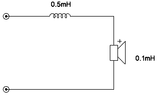

This distoriton grows with frequency and we can benefit form adding more impedance in series with the driver towards higher frequencies, e-g- by adding an air cored inductor.
I just saw that. Bingo! Indeed, see below, this gives you effectively the same benefits as 5:1 current drive, but using a voltage amp:
We don't need current drive, in fact we need to come up with solutions that don't require current drive. The above example with 8 Ohm driver will usually be -6dB at 3KHz. That 0.5mH is rather stable, it is the 0.1mH that is not. In fact it produces a voltage in the voice coil that leads to distortion, the much larger external inductor suppresses that.

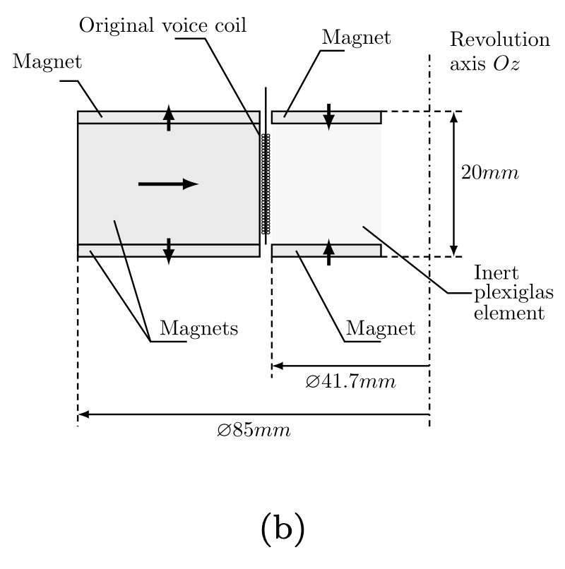

It seems so vague and barely readable they could almost patent it and force unsuspecting independent developers to pay royalties for the amazing tech they generously published.
Edit.. the cynic in me, hehehe. It would be nice to see those colourful cross-sections with field strength, and simple impedance vs frequency graphs instead of frequencies going in some unspecified "north-north east" vector.
It must be because I'm sick -- the world gives me free ideas: "hey look! A speaker motor with only magnets and no iron!" and I find some way to complain about it :)
It has to be acknowledged that they and Mills and Hawksford and others, did some amazing work. So for us mere earthlings, it's a smorgasbord to pick and choose ideas / inspiration / topologies etc.
