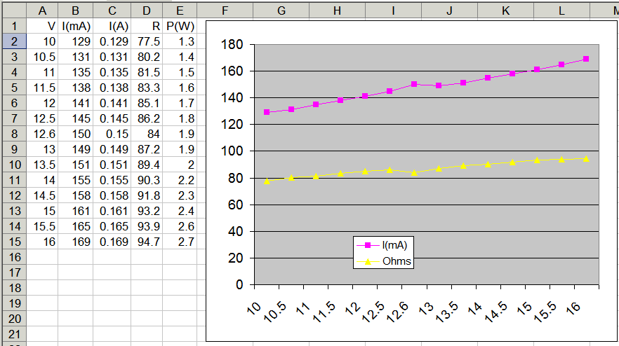

12AY7 Heater Measurements,,,,...
There's an odd jiggle at 12.6V, which makes no physical sense.
Ignoring that, it is as we always knew: a heater is a resistor that *tends* somewhat toward constant current rather than simple resistance.
Nobody here remembers series-string lamp? Holiday festoons? Runway lights? A string of same-design filaments is stable. It would be stable even if the same filament wire were cut 4V for tuner and 40V for H-sweep tube. The "problem" in series-string TVs is that various heater designs were used, some slower-heating than others. The late 1950s agreement improved the situation. (Lowest-bidder sourcing ensured continued troubles.)
Series-string lamps were also fed with Constant Current supplies (electromechanical!). If in a long string, one lamp burned, the whole street or runway was dark. Instead each lamp had a shunt gap with paper insulator. (I have one on my porch, though I've bypassed the cutout.) If lamp voltage rose from 100V to 2,000V, the paper punched-through, that one lamp shorted, the rest of the string ran at nominal current with slightly less total voltage on the string.
