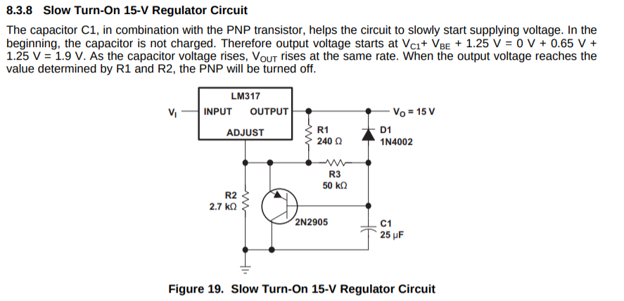

If you are worried about heater surge at power-up, and don't want to fool with the inaccuracy of constant current, why not spend another nickle on an additional transistor, and use this handy scheme from the datasheet for the LM317-
Of course you will need to select the right resistors for the desired output voltage, but this particular circuit works well. If you need more current, use an additional pass transistor or a bigger IC like the LM338. Use plenty of heatsink, of course. I've used this for supplying power hungry filaments on sweep tubes in the past and it works very well. This gives you a slower warmup time (increase the cap to increase the time it takes to come up) and a steady DC voltage across the filaments. Easy peasy.
Cheap, easy, effective.
Yes, that should do the trick if you make the time constant long enough. An NTC meant for inrush current limiting also works fine. You loose half a volt or so because resistance doesn't go to zero after heating up, but that's it.
