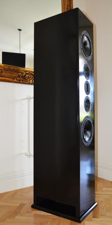

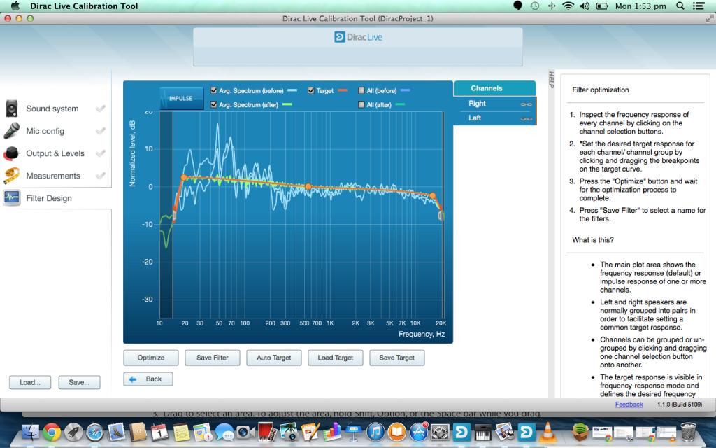

High performance.reasonable price, svelte dimensions. In room response to 20Hz. 88.5dB/2.83V. Max SPL 100dB. Hard to complain.

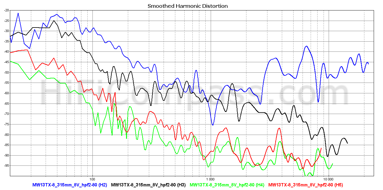

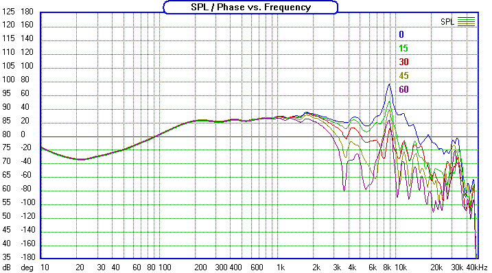

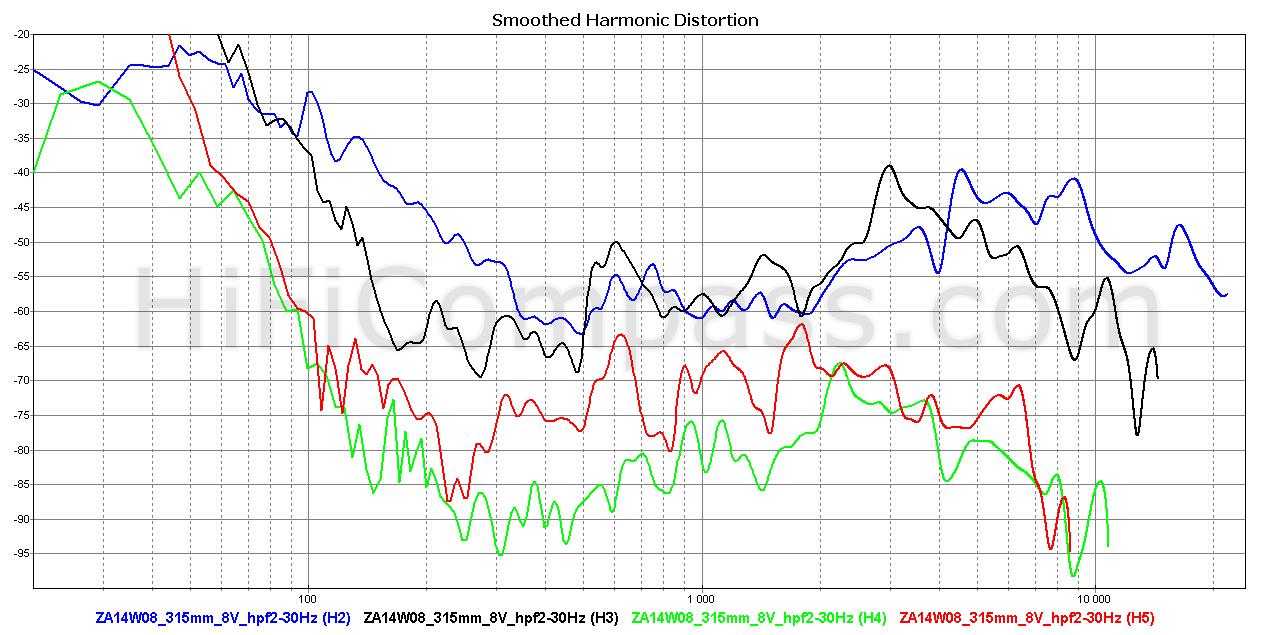

Well, the ZA14, as many cones with quite obvious breakup modes under 10k, has to be crossed over somewhere around 2-2,5k, preferably with a steep (even elliptical) lowpass. The directivity up to about 3kHz is quite predictable and above that the tweeter will dominate the response. Combine it (for instance) with a H1499 which essentially does the same at 2 to 2,5kHz and things will be allright (apart from baffle diffraction).
