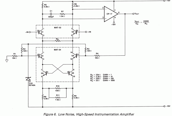

FETs Versus Bipolars
Funny thing thing is I started with bipolars (MAT02) but ended with FETs (2SK389). Now you wouldn't believe it. The circuit did NOT get more noisy! Yes I know it is against all textbook explanations. Horowitz has several pages about this noise problem. I simply cannot corrobate it.
EC8010 said:You really don't want to use a FET input op-amp in this application. As a broad generalisation, FET op-amps are dominated by voltage noise, whereas bipolars are dominated by current noise. When you use a moving coil cartridge as the source, its low source resistance means that the current noise hardly develops any voltage, meaning that bipolars are quieter. AD797 might be a good choice.
Re: FETs Versus Bipolars
I'm amazed! It took a lot of searching, but I finally found some data on the device, and see it has a transconductance of only 20mA/V, even when you thrash it. That sort of number certainly doesn't sound promising. Did you measure the noise when you compared against MAT-02, or was it by listening? Details, details?
Elso Kwak said:The circuit did NOT get more noisy! Yes I know it is against all textbook explanations.
Re: Re: FETs Versus Bipolars
Picture simply taken from the datasheet. The MC-cartridge is connected between +IN and -IN with 100 Ohm resistors to ground from the inputs. So the dartridge leads are totally floating with respect to ground. I replaced the opamp by an AD817. Later went totally discrete. I did not suspect the cross-quad would work with the FETs but it did!
I judged the noise form the same high volume setting, no measurements available.
The sound was much better than the circuit I built with the SSM2017 which again was better than the Mark Levinson JC1-AC, to my ears.😎
Folks, this is the situation:
Noise has several sources. One is base resistivity or Rbb'. This can be 2-400 ohms. The very best NPN transistors have about 4 ohms.
Then the Voltage noise generator. For transistors, it is .5/Gm = 13 ohms at 1ma, 1.3 ohms at 10ma. For fets, it is .7/Gm or.7/.035 = 20 ohms at 10ma.
There is also a current noise generator, which will be neglected here.
Elso has a 33 ohm resistor in series with his input, so it pads any differences between the 2SK389 and and pair of transistors. This difference will be small in this case. Now what if you ran the transistors at 10 ma? Then the transistor would be best, BUT it would be made more noisy than necessary by 1/f noise and added current noise.
Also, Elso's circuit 'might' add some noise from the current sources that are not completely degenerated for noise gain. I hope that this helps.
