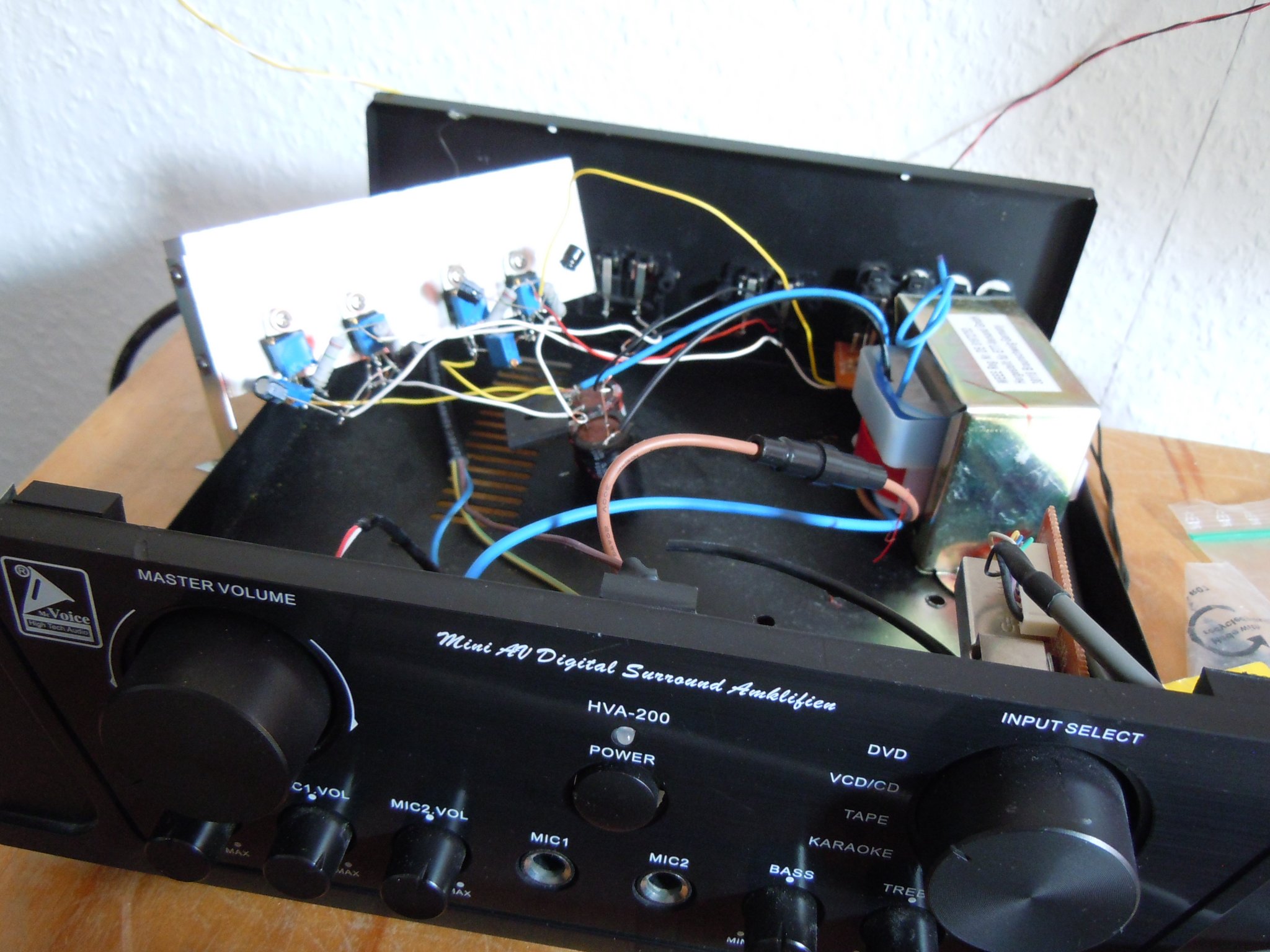

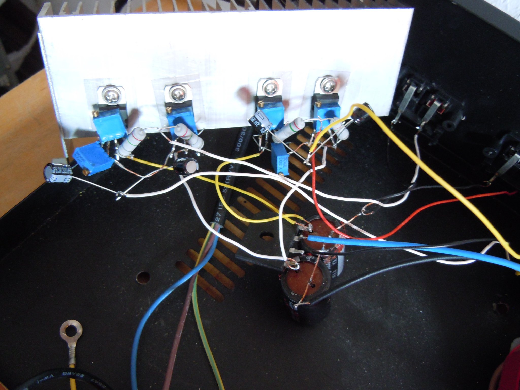

The cool summer-follower;-)
Still had a few MJE3055/2955 lying around. Sonically I had noted - compared to one of my favorites TIP41/42: "Tones smaller, a little potted, braked". Cutting the MJE is not worth it;-) Or use even smaller, better ones, like BD441/442.
I did not measure the hFE of the MJE3055/2955. At the moment the resistance of the bias regulator is 20 kOhm, the base regulators about 50 kOhm - are also used to set the offset. Psu: +/- 26 VDC.
As emitter resistors I used the 0.25 Ohm of the HVA-200. < 2 x 20 mV is the voltage drop across the emitter resistors.
I like to use Panasonic KA-A as capacitors. They are some of the best I have heard. They also sound better than any fat, expensive film capacitors - their problem is their size, so they can only be used for a few octaves, if at all.
Power supply can be seen in #17, sketch 3;-)
Do not use unnecessary switchers and volume controls. Omit everything.
Do not be alarmed: Followers appear quietly for the time being.
As time goes by, they seem increasingly louder. Their cleanliness, dynamics, inner tension make you turn down the volume control further and further. At the moment I listen with the headphone output of a laptop. And that is now only at < 1/2. And I know the neighbor is on 180;-)
And now send me your grandmother;-)

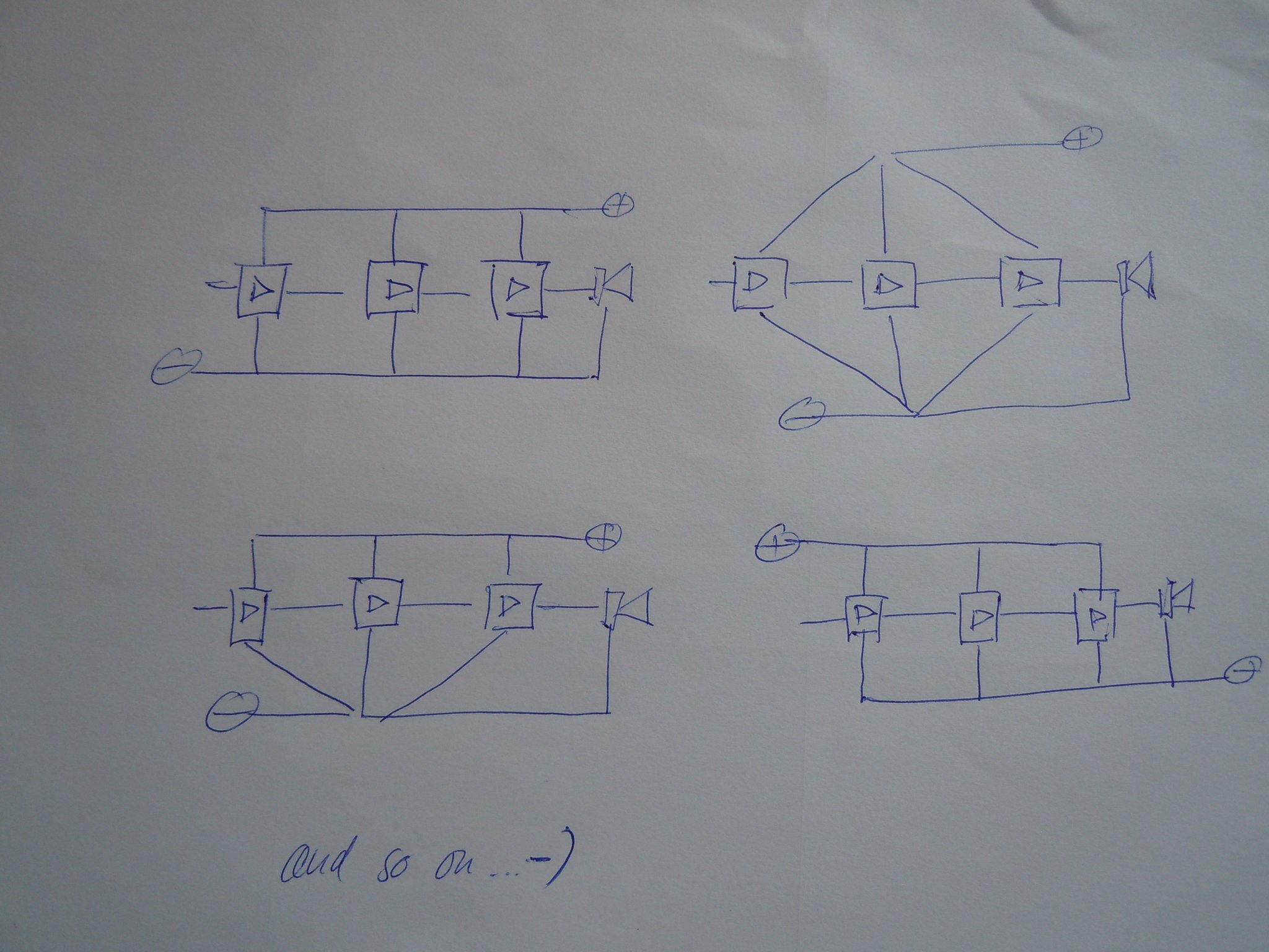

Some food for thought regarding the practical connection of "function groups" - not all imaginable and mostly in Audio, "HighEnd" realized concepts consider current, flow, which is detrimental to the sound;-)
Also small excerpts only - to start!

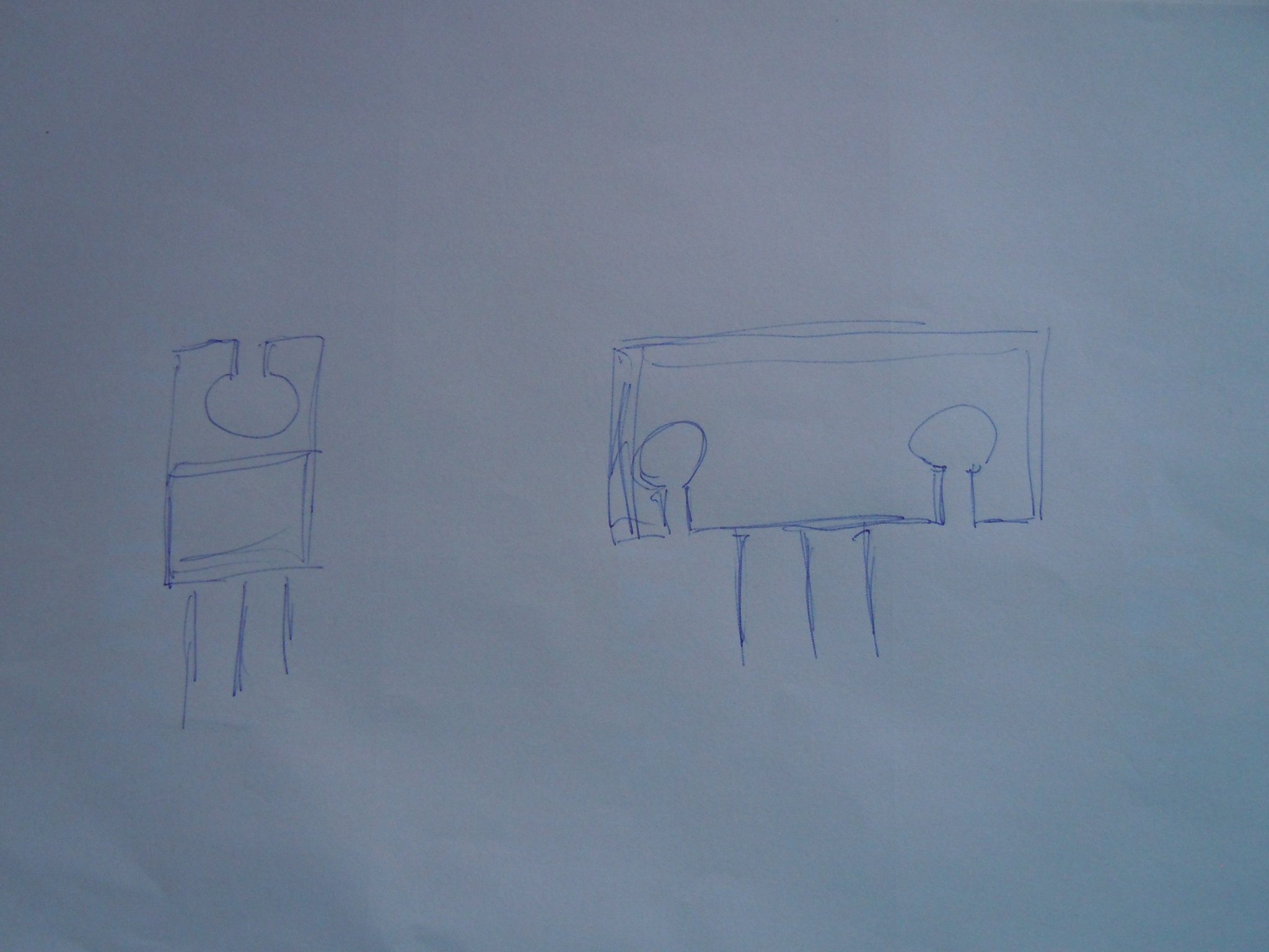

Because power transistors also have a current-misregarding build up - we also hear material, including material tensions, shape, cross-section, mass-stiffness, and more -: here's a little tip to help power transistors sound better: a small cut as seen. At least this one;-)
But there is much more possible;-)
