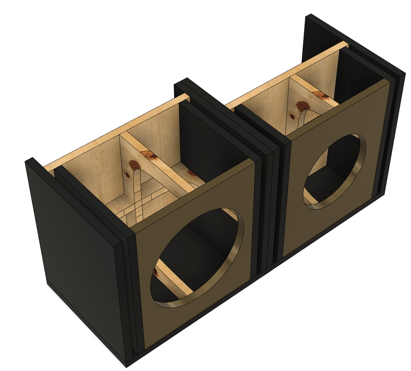

tubelectron, do you mean the "t-line" design above? I didn't actually plan to build that. I figured it would be a nightmare to make, and probably not deliver. Just a fun idea. As of right now I think my sub will be sealed, while the FR speaker will possibly be ported out of the back. I think the back walls of my boxes will be moved in to match the sizing needed. Like this.

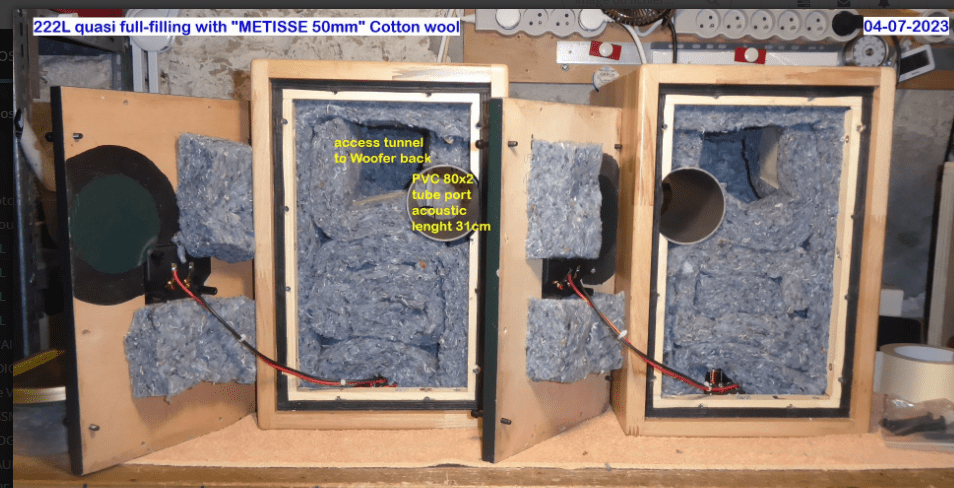

Maybe of some help: Make a small box act like a larger one with polyester fiberfill
This paper about the interest of filling enclosures written by Tom Nousaine is absolutely true - this point is also mentioned by experts like V.Dickason, M.Colloms and J.D'Appolito in their respective books.

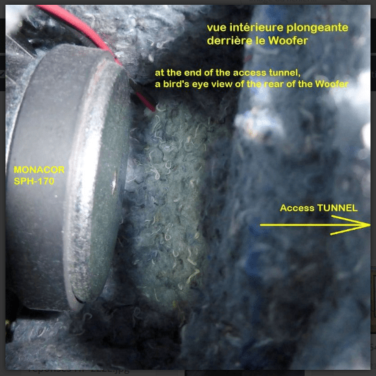

The sole point of importance in the case of a BR is to manage a "free channel" (not necessarily direct sight) from the back of the woofer to the port - I mean : no plugging of some sort...

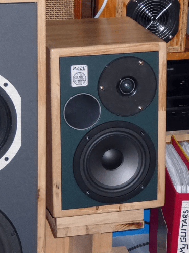

Here's an example on my 222L bookshelf speakers, @90dB/w/m, offering F3=40Hz thanks to filling, with dimensions HxWxD : 370x250x280mm only.

My box size is just weird. If I make it sealed, the box is too small for the FR speakers, if I port it, then its way to big, and I end up with the design above. I don't know if I can fill it enough to make the sealed box work, and even then I keep reading that filling a sealed box is kind of silly.
