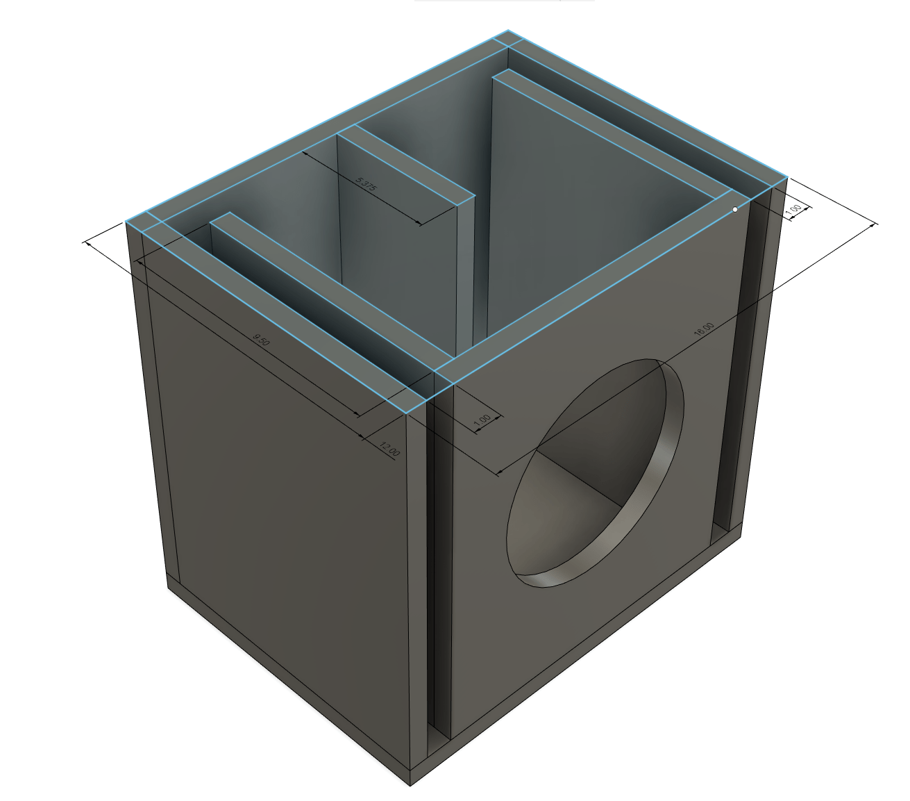

I have a bunch of "cube" shelves. They are 16in wide x 16in high x 12in deep. I'd like to build matching boxes for a set of speakers and subs.
The plan is to have 2 full range speakers, and 2 subs. I think I've settled on 8" all around, but I could do differently if that would sound weird.
I think I'll build them to look like the MasterSounds speakers since they are symmetrical and fit my "design limitation" (the cube shape).
I need help with the internals though. I've looked at a few different layouts/blueprints around but I guess I need a sanity check. Mainly I can't figure out why I would pick 1 layout over another. Like bass reflex, maze, single fold L, 4th order, 6th order, so on. based on MasterSounds they just list the Speakers as Bass reflex, and the subs as 4th order. Should I do the same? CAN I do the same? Do I even need to worry that much? I was thinking just doing it like this for the Speakers. And like this for the subs.

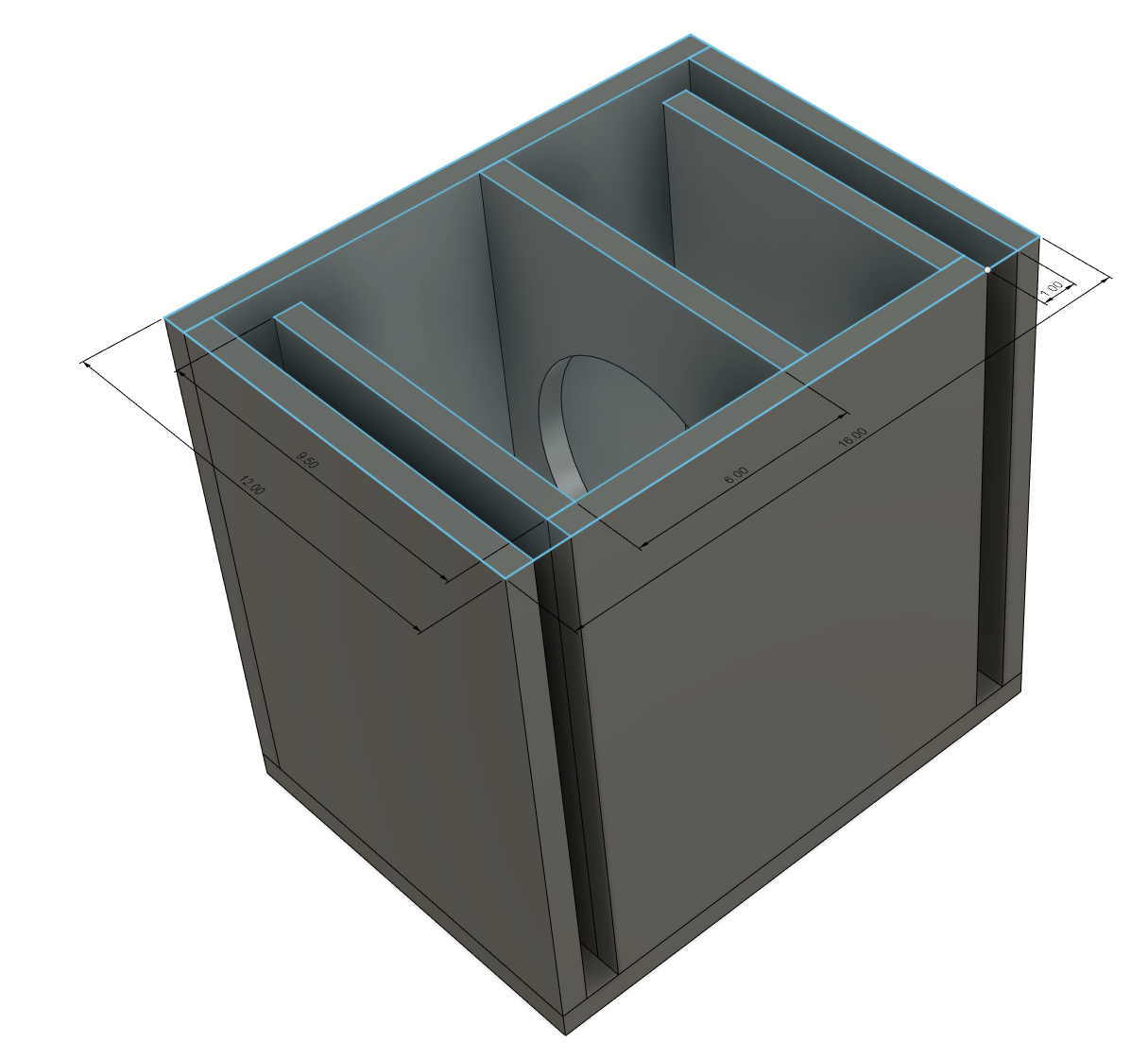

Quick sketch
Given the long high aspect ratio of the vents will require some extrpolation of the simulation to get the tuning right.
You have essentially drawn one of my miniOnken (centre) channels. https://frugal-horn.com/downloads/centre/A12-centreB.pdf
I doubt you will find an 8” that will fit that small a box and work vented. It should also be noted that typically with subs teh top is likely better sealed or aperiodic.
I can only recommend 2 8s, neither will work in your application, i would suggest that a smaller FR wiould do a better job and fit the design brief.

Thanks for replying! I clearly have no idea what I'm doing. I'm just trying to make something be pretty based on my weird "design constraint", the 16x16x12 box.
I was thinking of using the Lii Audio Fast 8 originally, but if that doesn't work or no 8s actually work, I can do 6s. I don't listen to anything VERY loud anyway. I think the MasterSounds A series uses 6s too, so that makes sense. Their box is smaller though.
That miniOnken IS very similar to what I want. It's using an 8, whats different in their design to mine that makes mine not work? It's just a much smaller box/volume it seems.
The Lii Audio Fast-6 doesn't seem nearly as good as the Fast-8. Maybe I can find a Dayton 6 FR. Any suggestions?
What do you mean about a sealed/aperiodic top for the subs? The right side chamber is smaller than the left side chamber is that's what you mean. I based that on this 6th order bandpass.

The sapce tyou have is likely too small. It is for either oif the 8s i have liked, i won’t go near the Lii stuff as teh data they publish is inconsistent. Their modus operandi seems top be to copy old vintage drivers in looks.
Maximizing the volume of the available space gives 36 litres, but som ebracing will be required. Yoiu could almost squeeze an FA22 into that volume, (it would prefer at least 45 litres) and one does not really need helper woofers. The other 8 i like is not suitable at all for a standard box.
Given that you will have bass support, and the midTweeter willnot need to do heavy lifting, the better performance of a smaller driver in the midrange and particularily up top makes so much more sense than compromising just because in the minds of many males, bigger is better.

Don't I have way more volume than the miniOnken? Unless my math is wrong.The space you have is likely too small...
Not counting the port volume and bracing:
I have 1674.75 cu in or 27.4 L.
MiniOnken has 852.975 cu in or ~14 L
Is this wrong? Am I forget to account for something?

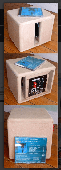

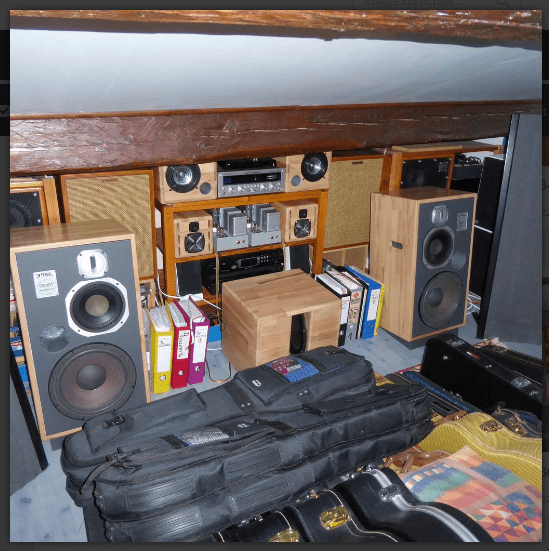

Thanks @woodo : that's it, you are absolutely right. 😉

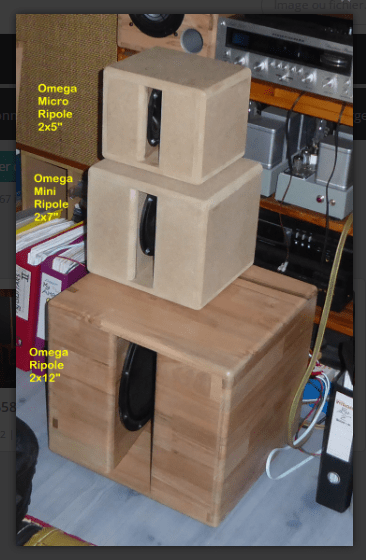

Yes, only the bigger one 2x12" is operational today.
I dimantled the two others that were only "limit validation" tests. They both worked successfully, but the small integrated sub amp module that I used had poor crossover performances, so the results were not as good as expected for this sole reason : poor electronics, not the Ripole principle.

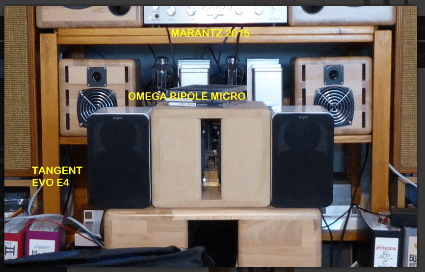

When connected to the serious ATOHM S250 sub module of the 2x12", the small 2x5" and 2x7" were absolutely convincing. If I only could find a small module offering good X-over performances, I would rebuild them... Member Spassgeneral from https://diyaudioprojects.com/Forum/viewtopic.php?f=11&t=7327&start=10 came to the same conclusions.
Here is a picture below of the successful, amazing and encouraging test of a compact Ripole I first made - the sub module used for the test was the ATOHM S250 from the OMEGA Ripole 2x12 :

Possible Sub sketch.
If the second statement means that you have not done much box design previously, I would not suggest a bandpass box of any kind. They're fussier than ported or sealed. And honestly, I'd suggest doing all of your speakers sealed if you can find suitable drivers for what you want. It's so much easier for an inexperienced builder.I clearly have no idea what I'm doing.
If you use an amp on the subs that includes DSP/EQ capability, you can squeeze some extra low end out of the driver, so you won't be losing much compared to a ported box. Along the same lines, if you're using a sub, most of the benefit of a ported enclosure for the full range speakers will likely be irrelevant.
mattstat, thanks for the info. I did a bunch more homework yesterday and clearly with my dimensions anything ported or vented is borderline impossible according to most calculators.
I'm honestly REALLY curious how MasterSounds is getting away with their design or if they are just lying. I think both the sub and the speakers will now be sealed. Unless vents on speakers works differently than they do with subs. I didn't get to that yesterday night.
So now the plan is for both speakers and subs to be seald, have fake vents for the look cus thats nicer than a giant 16x16 slab with an measly 6 or 8 inch speaker in it, and the same for the sub but likely using an 8 or 10. With the larger volume inside I can go nuts on bracing too.
Now I just need to decide on with speakers and subs, and finalize the design.

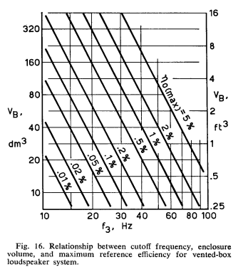

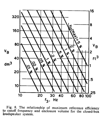

Hmm, regardless of what they're publishing they can't 'break through' the 'wall of science' TTBOMK, i.e., max eff. for a given tuning/box net Vb, so let these charts guide you..........
Efficiency conversion

My 2x12" Omega Ripole is H=400mm, W=440mm, D=400mm, that is to say : 15.74x17.32x15.74 in inches, including the sub amplifier - not very far from your limits...
But you can't place it in a corner, or against a wall though : the back must be at some distance due to the back radiation. Here is the placement that I use, in accordance with the recommendations of Axel Ridtahler, the inventor of the Ripole principle :
