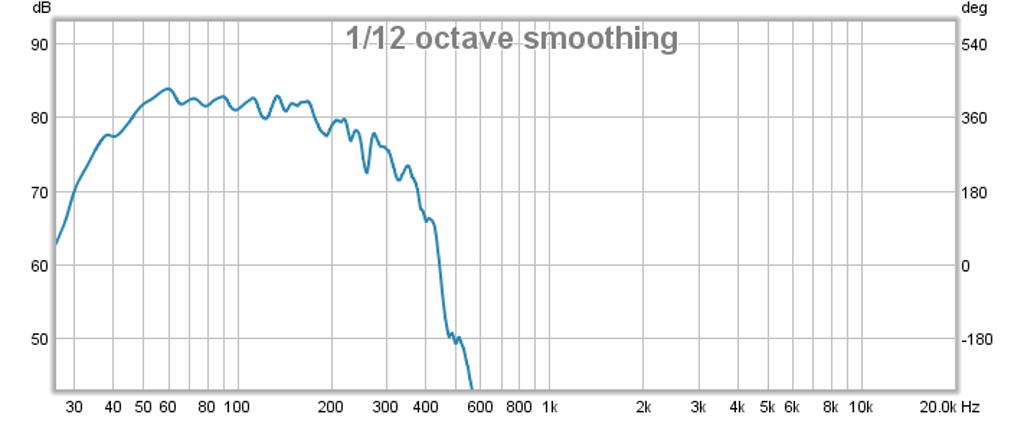

Another alignment that I am considering is a slot loaded open baffle (SLOB) for the bass duties. Maybe using 8x 6.5in woofers in a U folded OB cabinet for smaller footprint. F8 Neo on top and maybe 1st order crossover about 150Hz. Could make it outrageously heavy with a granite baffle and base. The look would be consistent. For the woofers some nice smooth Scan Speak or SBA with circa 35Hz Fs and strong motors. Wired series parallel would put the bass output about on par with output of F8 top.
I imagined a variation of one of Danny Richie's designs, NX-Otica or NX-Treme substituting mids and tweeter for the Cube driver. Although I can't imagine why in that Cube drivers are supposed to do bass better than most WB FR drivers (WRT bass PHY-HP comes to mind ... and I used to think those now extinct drives were expensive).Something like this?

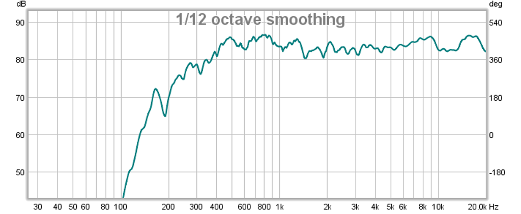

The concern that my client has, is that the F8 Neo, despite the very nice looking smooth frequency response provided by the manufacturer, may in fact, be hiding huge spikes and breakup modes like the Magus. These features are normal on whizzer cone drivers.
Magus independent party measurement:
Let's compare this with a no-whizzer cone 95dB sensitive "full range" driver that I measured myself a few years back (5MR450NDY in 12in wide OB):
A 75Hz crossover is a subwoofer crossing point as it is omnidirectional below 80Hz - I find it odd because I don't think any full range driver can get to 75Hz as an open baffle (even a 3 ft wide one as Mr Pass has on his SLOB). I think Mr Pass used 160Hz on the one in his SLOB article which used a Lowther.
