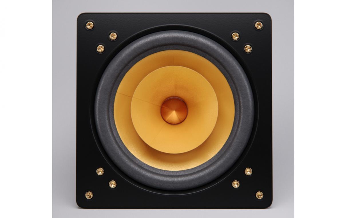

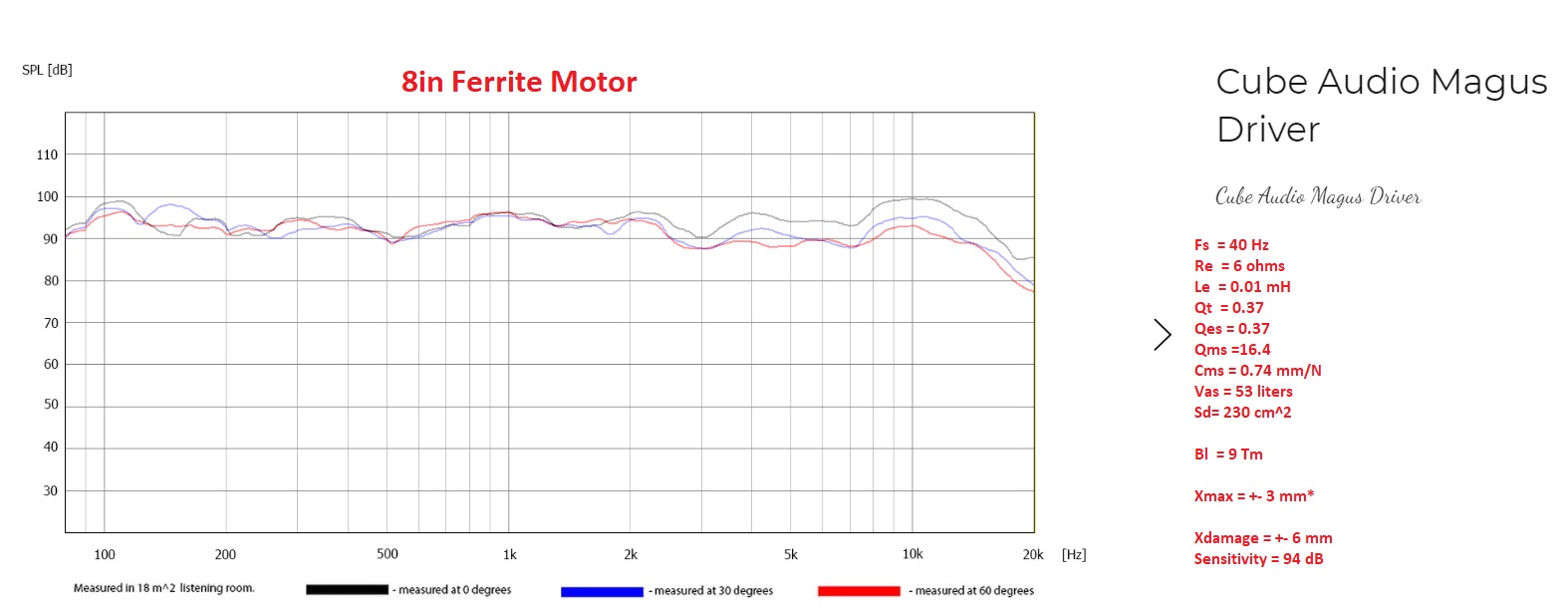

Looking at the 8in Magus ferrite driver now. It appears superior to the Neo in the numbers and graphs alone. Looks smoother with a +5dB bump at 10kHz rather than 10dB, and is 3dB more sensitive. The cone is more conventional looking single whizzer and pointy phase plug we have seen in other designs. Reminiscent of a Dayton PS225-8 ($99) 🙂 [PS220 has an ear-ripping 15dB peak at 3.5kHz though]
attachment.php
attachment.php
Cube Audio has to do something about the fancy graphics on their website. It loads slowly with each mouse click taking 30 seconds. Unbearable so I have to copy the images and data to my own here for quick reference.
F8 Magus vis-a-vis the F8 Neo?
Hard to directly compare the frequency / amplitude graphs as they're on different scales & different levels of smoothing, but the Magus seems cleaner through the top end; at worst it doesn't look like it would give much away to its pricier stablemate when measured in the same conditions. Slightly higher sensitivity also although the nominal rating is a bit high for the published spec., (but roughly in line for a 1KHz nominal or average).
For the rest, Q, Vas, Fs are similar; same VC gap & coil length based on published Xmax, so from a box design perspective much of a muchness. I prefer the 6ohm nominal impedance for the Magus. The Neo's rated 10ohms isn't a particularly big deal but 6ohms keeps most amplifiers happy. None of which necessarily tells us everything about the presentation, although it says a lot. That twin-whzzer of the Neo will behave a bit differently to the more conventional single-whizzer Magus though, which is probably one reason they've altered the central plug profile.
A long-winded way of saying -yes. I think so. Also a question of taste, obviously, but I'd be inclined to give the nod to the Magus on paper, and definitely given the price difference. Be interesting to use the Neo cone on the Magus motor if the coil, suspension fit. I'm prepared to revise this view in light of additional data or experience of course -I know the Magus, I haven't heard or seen the Neo in person.

Yikes, that 0deg peak is a real ear-ripper! 🙂
The peaks at 2kHz and 3.9kHz are probably what’s contributing to the sibilance.
That’s a lot of energy hanging around and taking it’s sweet time to slowly wear out in the higher octaves. What I call sonic “bloom”.
I wonder how the Neo compares?

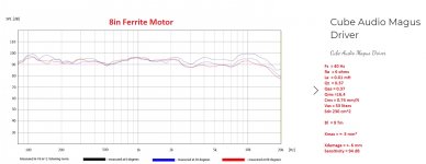

I measured my Magus with ARTA while listening to music. The anoying highs apear (where audible) while I can see peaks in the area obove about 8 kHz.

Wow, those measurements look quite different than those on cube's pages.
I guess independent measurements are always a good idea.
Frankly, looking at it, its nothing different or special. Typical high efficiency full range with all the warts. I see similar stuff on Rutcho's pages.
Considering the price, not worth to bother.
