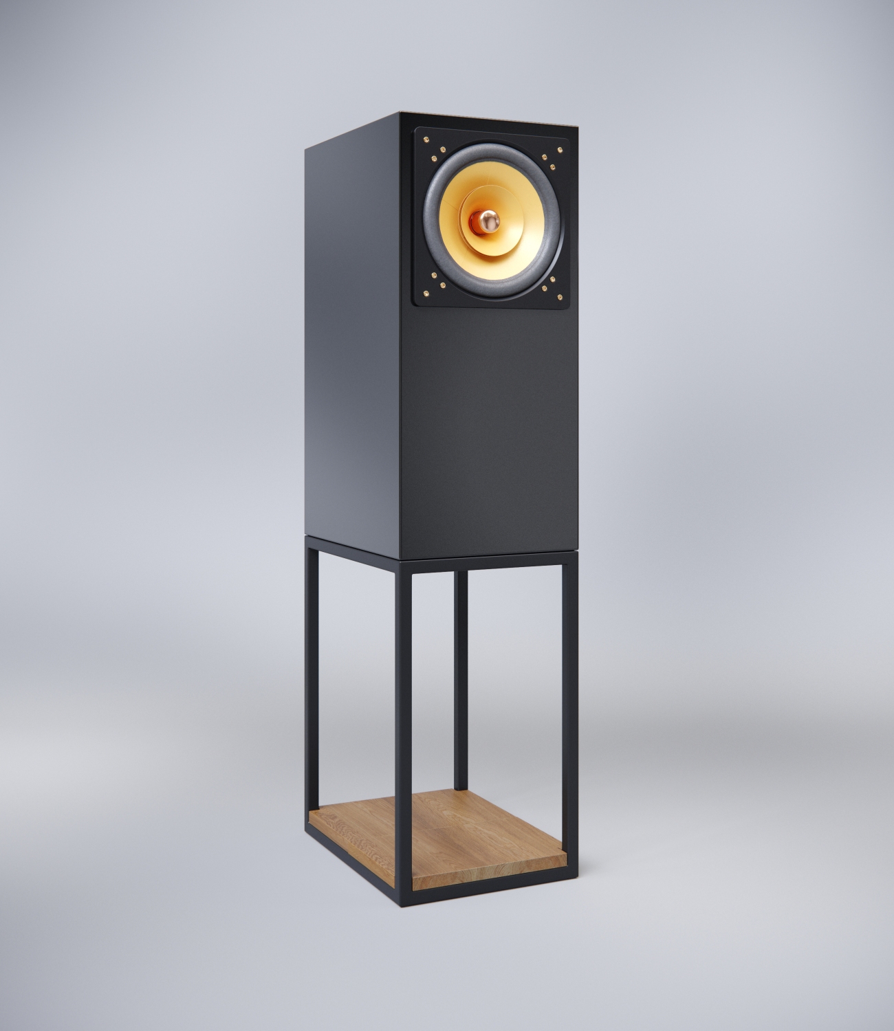

Suggested Cabinets by the Manufacturer include a bass reflex, tall MLTL, compact standmount MLTL, and Voigt pipe are on the manufacturer's website.
Standmount BR (I htink):
Floor standing MLTL:
This looks like their version of BR mounted on top of a powered side-firing sub:

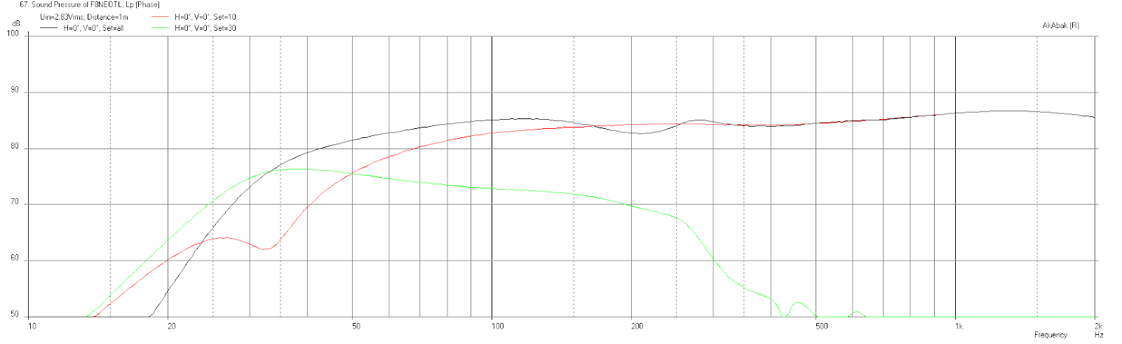

Just wanted to see if folks have any other ideas for a great speaker cabinet for this driver that will give nice articulate and deep bass, great lifelike imaging, and super dynamics.
The Qts, Vas, and Fs are remarkably similar to the RS225-8. What coincidence, hence a simple drop-in replacement to an existing detailed Akabak model was waiting and ready. Here is the predicted frequency response in such a TL - F6 of 37Hz and in 4pi space with 6dB of bass fall-off gives an overall sensitivity of 85dB (no boundary assists).
The TL cabinet looks something like this:
For the RS225-8, this cabinet has been verified in XPS/wood baffle to sound very good. Another option is to have a pair of substantial 10in woofers doing bass duties in a FAST with the F8 Neo serving fullrange duties in a transient perfect 1st order XO.

If you look at the predicted output from the port using the TL (green curve), it has most of its output from 30Hz to 100Hz. The output is smooth. The characteristic 1/4-wave length of 30Hz sound is about 10 ft long, and 100Hz is 3 ft long. To make a Karlson aperture that would blend these frequencies would require it to be of order 3ft to 10ft long. So for a 3ft tall speaker, I can't dedicate the entire length to K aperture for the vent, especially when the simulation predicts it is pretty smooth.
The typical K apertures we see on a Karlsonator or K-15 etc, have profound influence on the mid bass 300Hz to about 1khz.
Yes, straightforward vented box.
It's a folded [single] tapped horn (TQWT if you prefer) rather than an MLTL as I recall.
It is.
