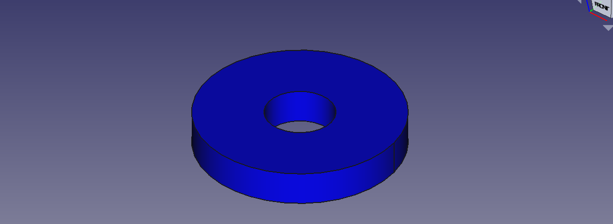

Heat pipe pickup disc/mag mount. This can machined or handcrafted. Thickness will need to be adjusted to the driver used. In this case, 10mm

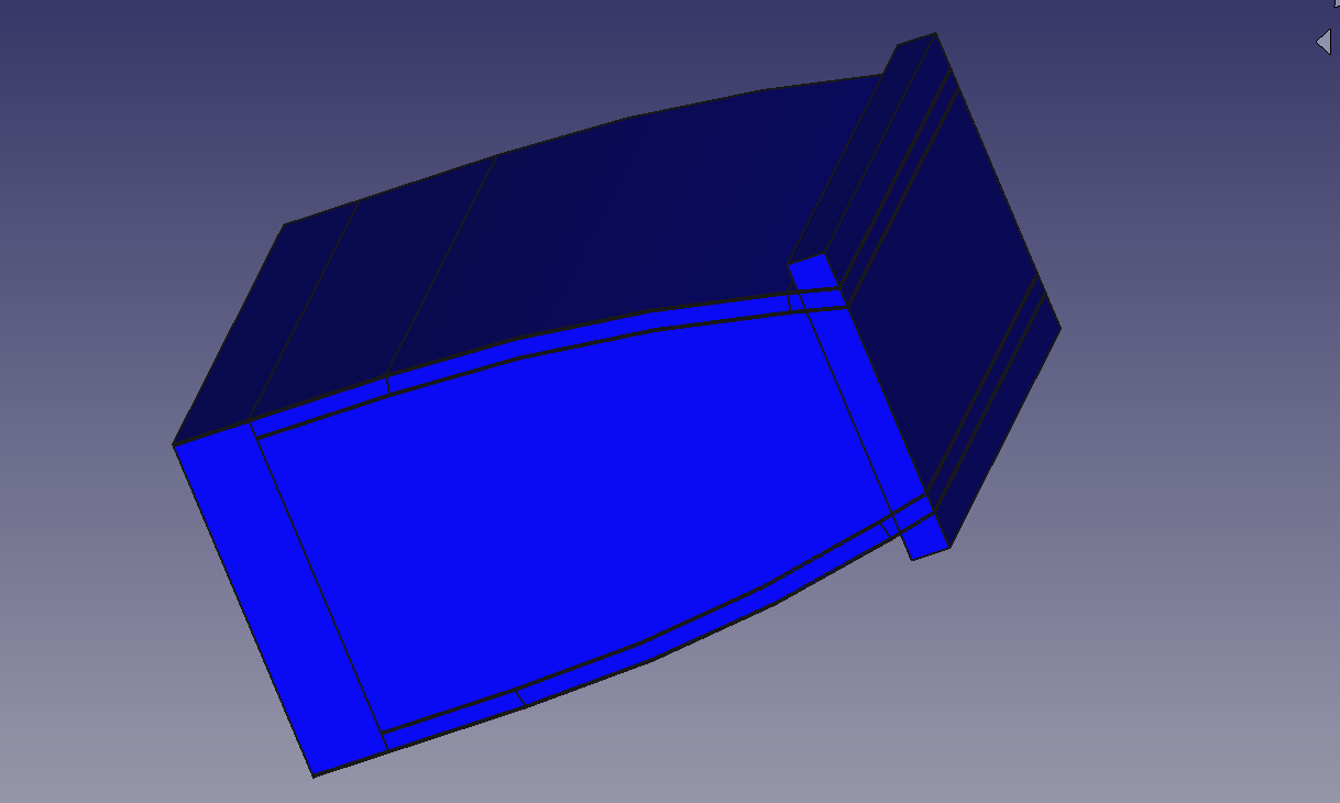

The Cub Sandwich project is my attempt to evolve that and develop a better workflow. V1 is the result of building up the SOR or statement of requirements items one by one. As designed, it moves the constructions process to the software and automation and the actual handiwork remaining becomes just assembly. The electronics bay in this is designed to take 840wrms of amp modules as well as a DSP board. The stereo speakers are likely to exceed what the amps can supply, so I will be redesigning this part to take only the 600w sub amp and leave the stereo amps and other electronics outboard. The V1 design will be just an active sub with DSP and balanced preouts for stereo
Now with V2, the aim is to reduce the time it takes to create each part in automation as well as a cab with more internal space. The active driver is going to see a clean 600wrms. V2 will explore increased SPL by unfettering the driver from space restrictions. As well, the new electronics bay will allow larger amps for the stereo channels as well as space for an optional tube stage between the DSP and sub to experiment with sweet over driving

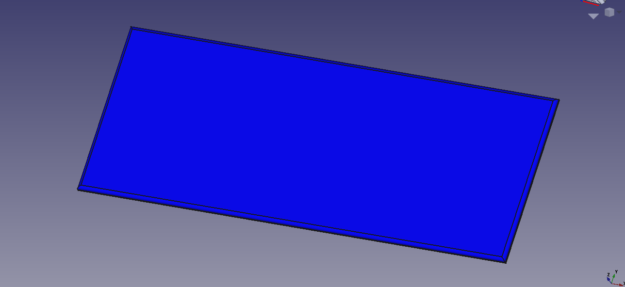

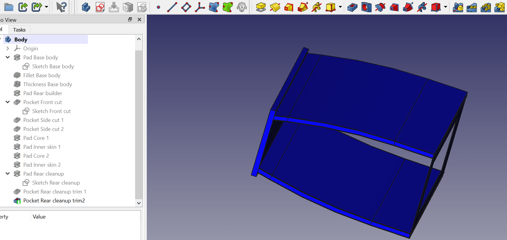

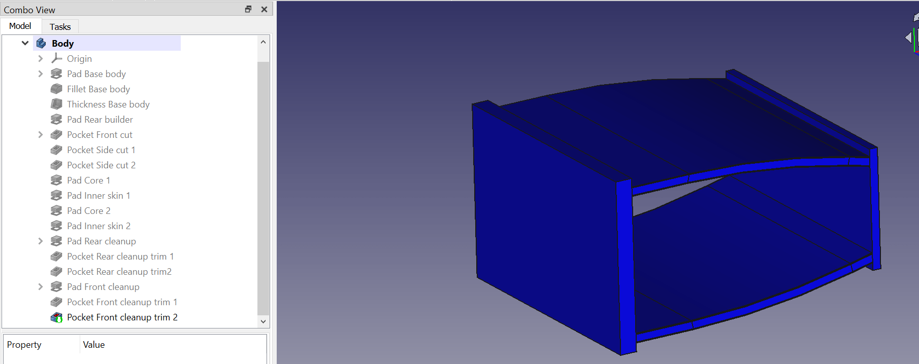

Take a close look at the left info panel in the pic. This is v2 reaching the state of completing the curved sides only in the sandwich layers. There is a 8mm core layer with 1mm skins either side. The schedule is single layer of 200gsm biax or dual 0.5mm alloy sheet each side of that 8mm PVC boatbuilding foam core material. Panel shows 3 sketches and the number of elements it takes to get to that stage. Most of the funny named elements are not even structure features. These are elements to help create another element or a feature. All those elements are just for the curved sides and setting overall design dimensions
The trick to keep FreeCAD stable while working is to reduce the number of sketches needed and instead exploit some padding and pocketing features that the program doesn't bring up as available in the task list

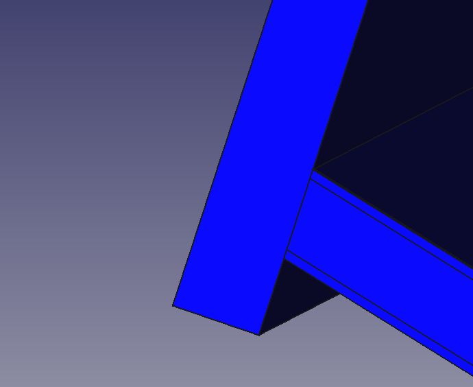

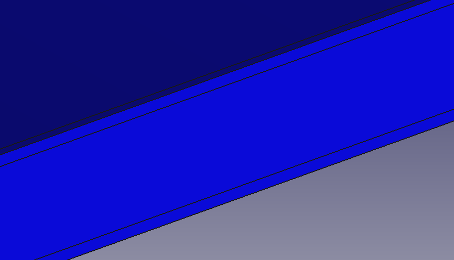

Below is a closeup of a rear corner, showing the skins and core. That back panel showing and sticking out is not a cab feature. That is there to keep everything even like a concreting formwork. That element will be removed once the flat sides are on and a proper forward transom will be created there as a structural item
Just picked up an error. I have been designing in a 8mm core, while the sheets here are 9mm. I had forgotten that and somehow running with 8mm. Thankfully, the way I have managed to layer the elements has allowed me to just adjust up a mm and the sandwich is now at the correct thickness
The boxing formwork is applied to the main baffle area. As can be deduced from the info panel, this needs to be set wider with a new sketch and then trimmed back. There are reasons for doing it this way to avoid FreeCAD limitations, including cleaning up aberrations created during building up the sandwich, as well as those that will appear in more advanced stages. These two elements in place of the proper baffle and back panel absorbs 5mm of base body at front and back and one removed, leaves two beautiful, curved sandwich panels with the raw edges in the correct planes. Now FreeCAD will have its panties in a knot it those two panels didn't have something connecting them together, so another use from the boxing formwork
One bad workflow that I caught while ironing v1 was that I had created the proper side baffles too early. This limited my access to modelling interior elements. So this becomes a demonstration for the learning about iterations while developing something. For v2, I'll do all the inside work first before creating the side baffles for the PR units

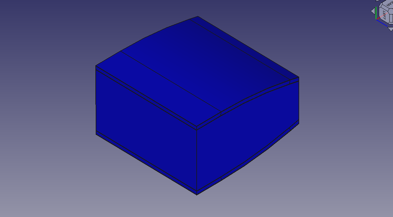

A couple of posts back I did all the steps to get to the pair of curved side panels. Here is a closeup of the section. 9mm PVC foam core and 1mm skin on either side. The design supports aluminium skins with the option of glass skins for increased durability. Now I have to create a rebate on these end edges and create the end panels which will sit in this step
This is where the model is now. I have removed the helper parts, the fore and rear formwork. It's just two curved sandwich panels supported by a temp fill. The edges provided by this fill will let me build the baffle and rear panel without creating new sketches and then carve out the internal structure

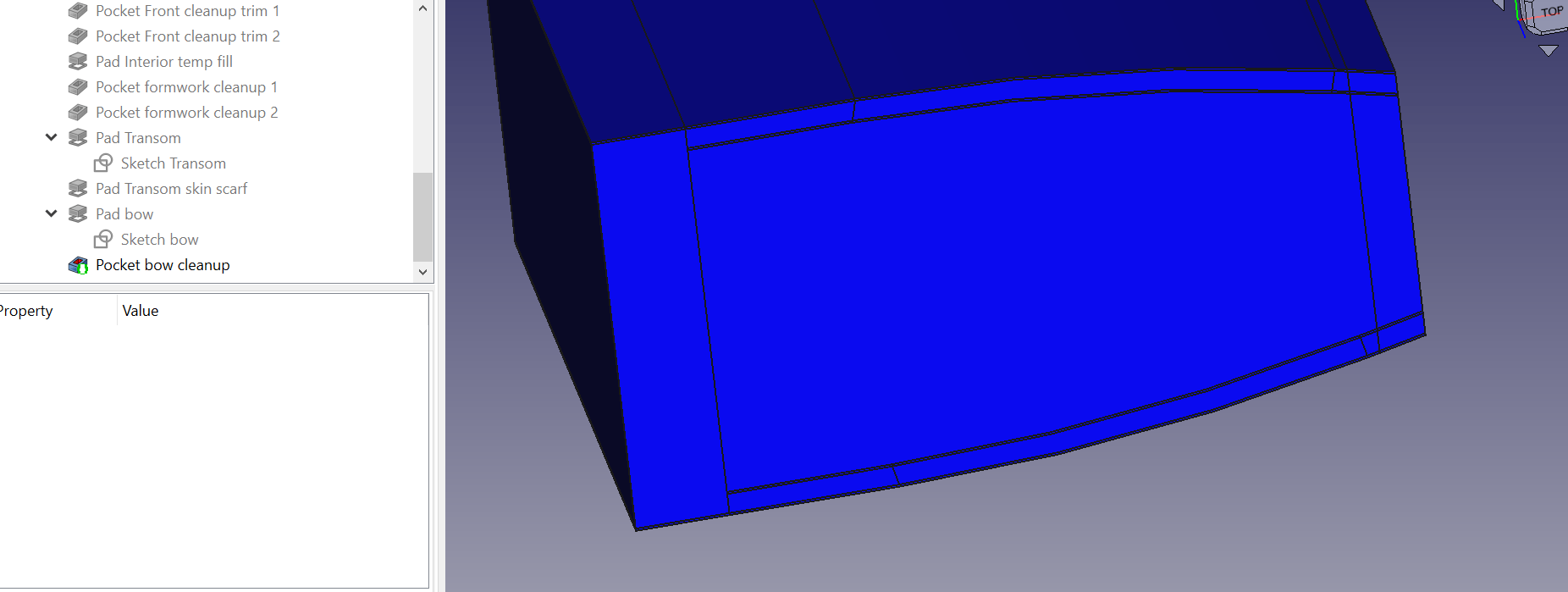

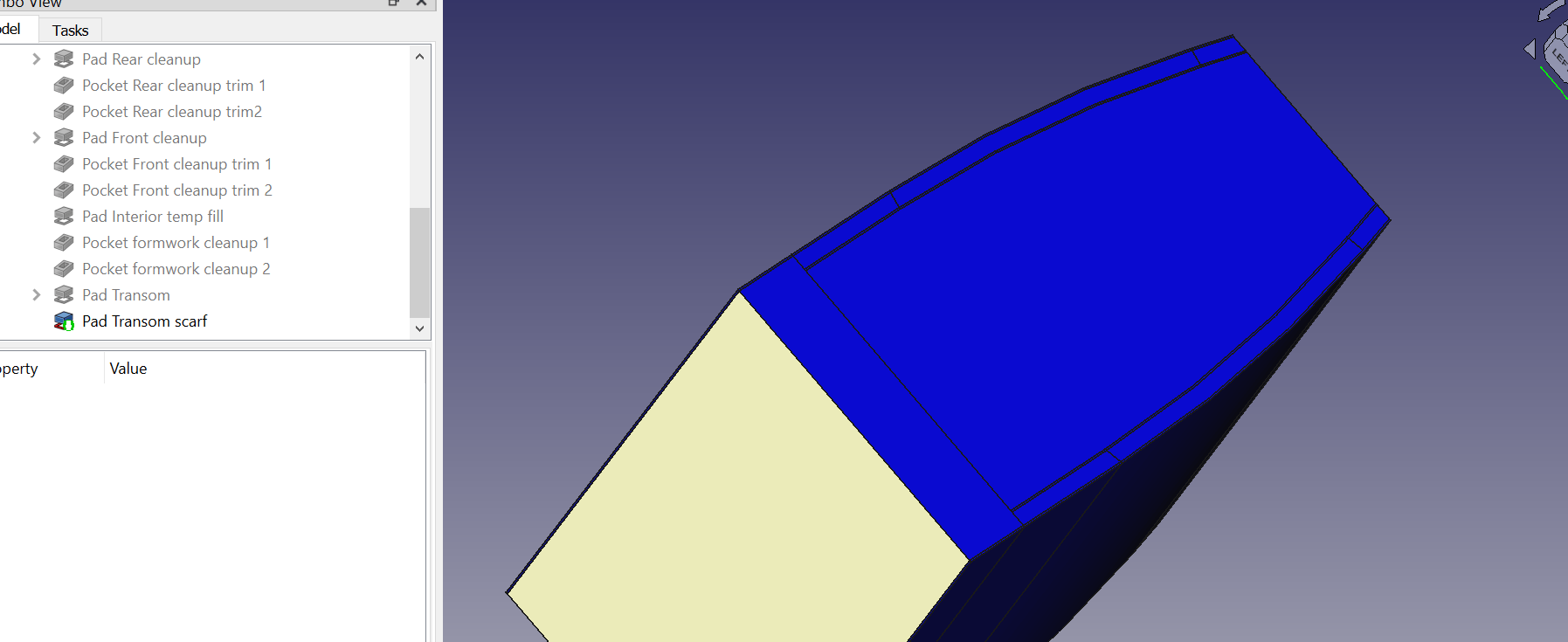

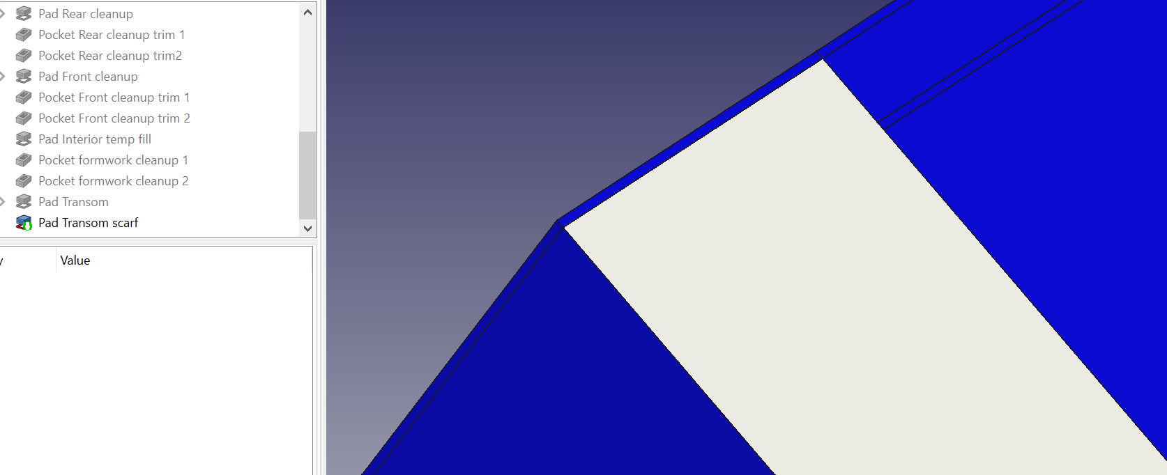

Baffle or transom created. The following pic shows detail of how that panel is captured by the outer skins which forms a structural bandage. This is supported by a fillet behind the joint. With the epoxy based glue that I have been working on, these all get turned into a monocoque structure
Haven't had much of a chance to sit down with this recently. Completing the config for the rear panel today. This pic shows how I have used a sketch to extrude a panel over the end of the cab. FreeCAD keeps the original lines when done this way. Now I can take away the bits that stick out and leave a correctly shaped part between the inside skins

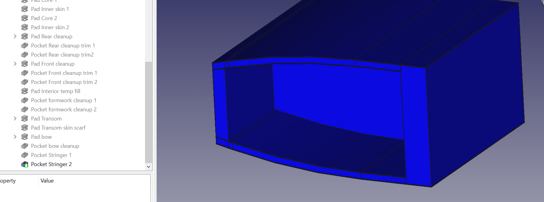

Central stringer created. This would be the main brace in a traditional build. But I am designing this in as an integral body area as done with sandwich techniques. The result is a monocoque body. Next, will form the active driver cutout and determine how the heat pipe will run

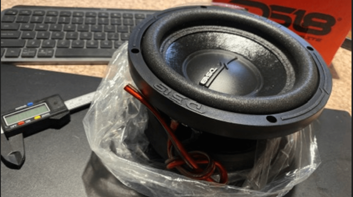

Couple of shots of the 6.5"er going into this cab. I will form the heat pipe to first pickup from the electronics bay under v2 of the cab and then pass by the vent on the driver's backplate and exit from the rear panel. The back panel will have active fan exhaust as well as fan intake for the electronic bay cavity. Same dual jet red fans from v1

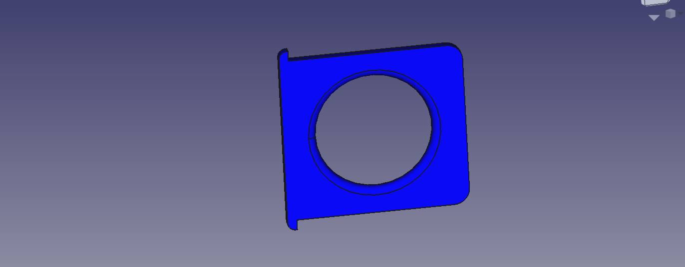

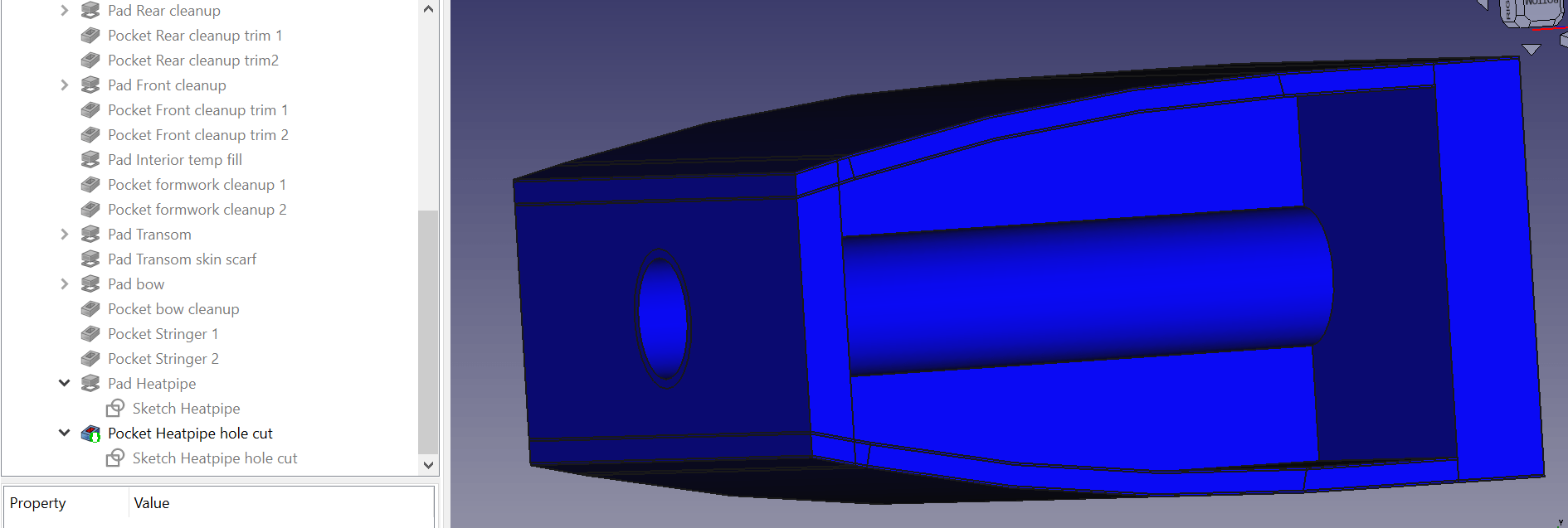

A 52mm inner dia pipe running fore to aft. Wall thickness is 4mm. This will be tabbed with fillets at a later modelling stage. Now to complete the transom or engine mount area on the front baffle. This will be the driver mount cutout, allowing air flow to the twin PR units
