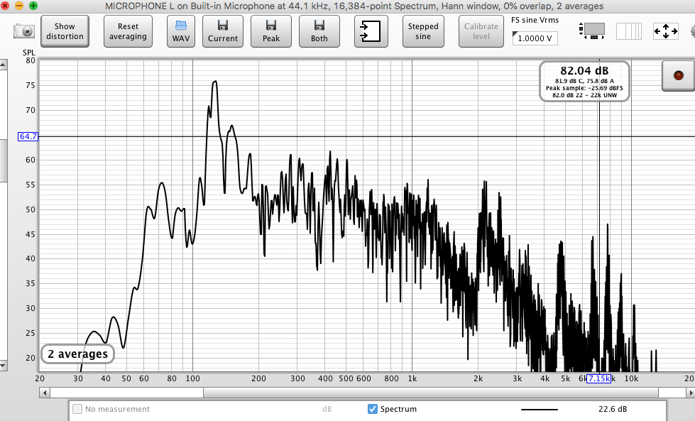

It would be much easier to set benchmarks if you measure with an RTA (Real Time Analizer) like REW (freeware) so you can see what frequencies you are hearing.I think let’s keep it easy to start with and set some bass reflex benchmarks

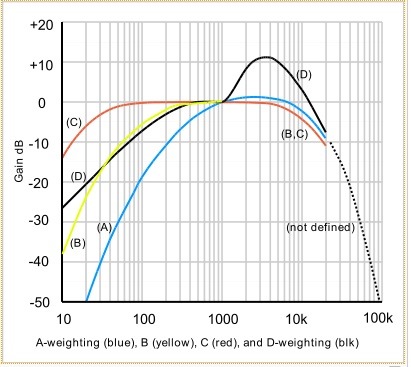

Another detail: many dB meters default to "A" weighting, which reads ~ -20dB low at 100Hz, -40 at 30Hz and -50dB at 20Hz.
If your "60 dB" readings were actually 60dBA, your normal daytime video playlist music could have been well above 80 dBC, or dBZ weighted, a flat frequency response of 10Hz to 20kHz ±1.5dB.
Unweighted responses do not define the frequency range over which the meter is linear.
In the RTA example of my voice above, the level was 82.04dBZ, 81.9 dBC, 75.8dBA.
The difference between the "Slow" (1000ms up and down) "Fast" (125ms) Impulse (35ms) or Peak (maximum instantaneous level) can amount to another ~20 dB difference depending on the nature of the sound.

Just did some quick measurements with NIOSH for iOS the other day. You are correct, it displays 'A' weighting for frequency and 'slow' for time. Will change that and take new readings

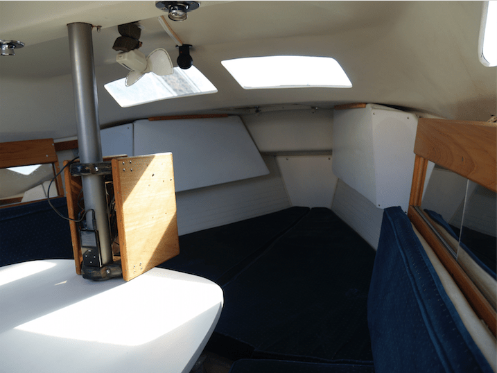

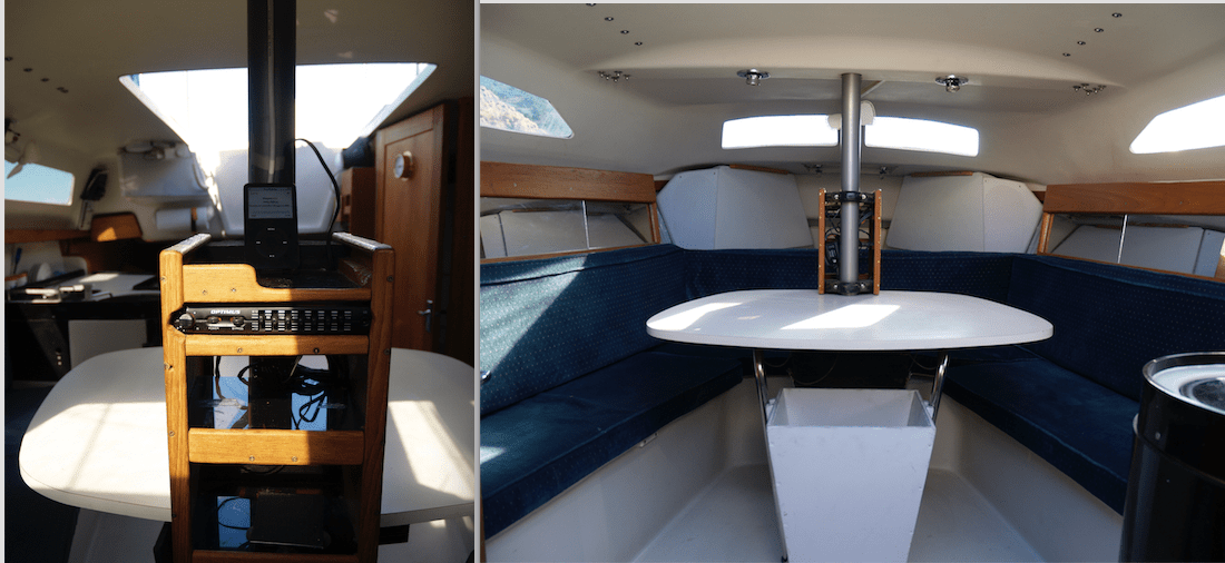

On the nautical theme, I built in 2.5 way speakers in the V berth of my (second to last..) 25 foot sailboat:
A Seas 6.5” P17 coax went in a .4 cubic foot enclosure tuned to 45 Hz, using a port 6 square inches, 12 inch deep.
A 6.5" Vifa woofer (bass assist cone), the model number which has escaped me, was in a 1 cubic foot chamber tuned to 37.5 Hz, a port 8 square inches, 11.2 inches deep.
These ports are rather large, and the area they take up is added to the box dimensions, as are the cone displacement. Fiberglass insulation was put on two sides of the interior.
The cabinets were built in to the “V” berth curves of the boat, and to achieve the correct toe-in, the speaker baffle is angled in around 45 degrees. That angle allows the cabinet to be only about 5” deep from the side wall, but because it is so thin, around 3 foot deep, tapering thinner at the back of the cabinet, which is in the forward (pointy end) of the “V” berth. I put the ports on the outside, running flush against the hull.
I built these in 1996, and at the time had never heard of Seas or Vifa, being pretty much only into pro sound. Took it all on faith from Bob Oswood that they would work well with his passive crossover design, and they did, surpassing my expectations.
I also put a third speaker near the companionway steps using another Seas P 17 Coax wired as a “phantom” speaker. This speaker is wired with the positive and negative leads going to the two positives on the amp, so only left/right difference information is reproduced out of it. With that speaker, you could hear a stereo image no matter where you sat in the cabin.
Flat to 40Hz was not bad in 1996, and the system rocked with a 30 watt per channel 12v amp.
One of the best sounding stereos I've ever heard playing everything from orchestral to punk, funk, reggae, country western, blues, jazz, new age, Americana...
