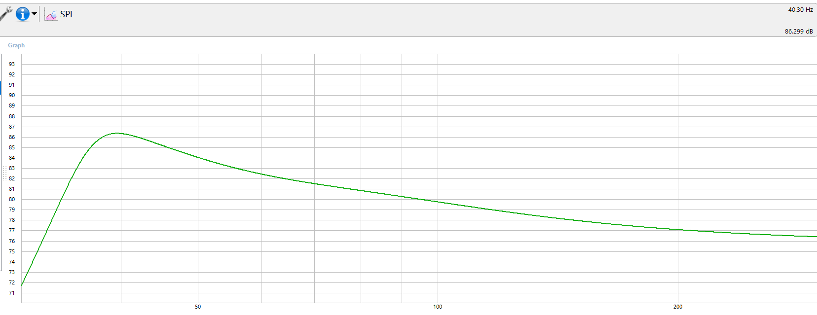

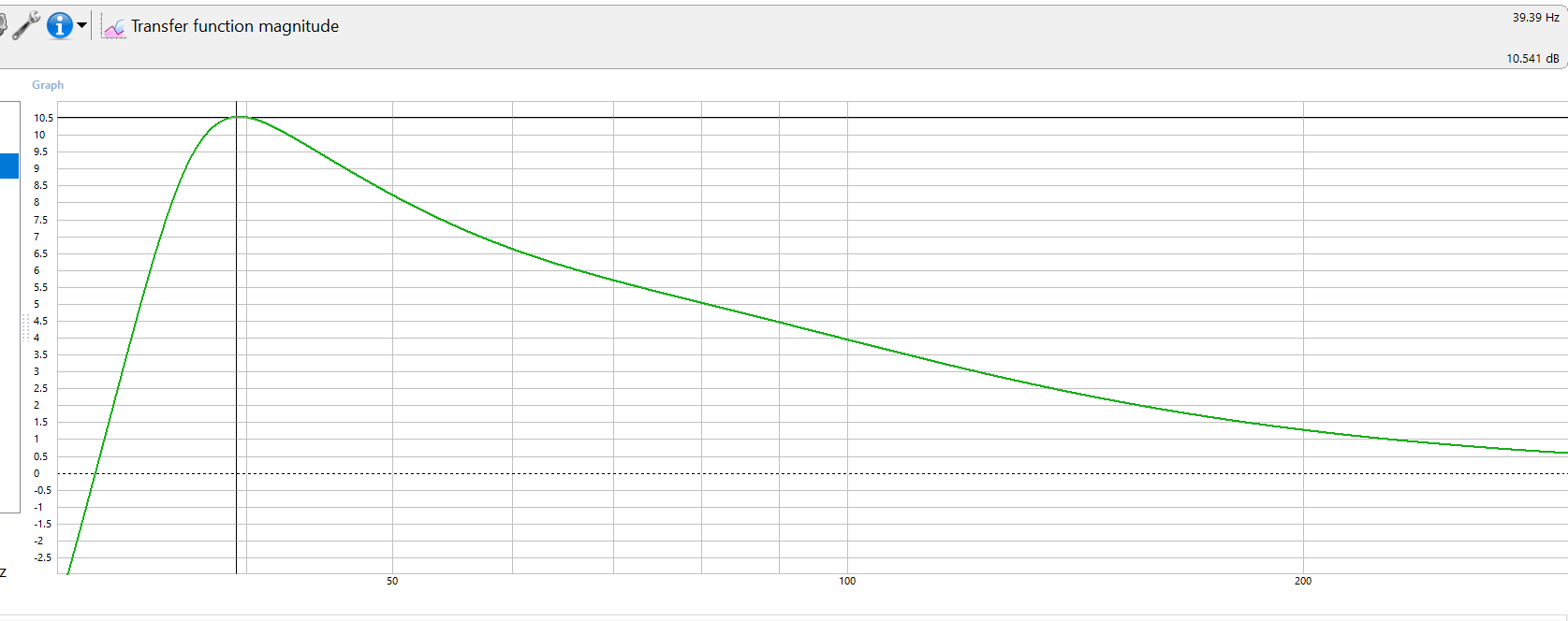

Stretching Fb down another 2hz needs cab down below 3L and a bit higher tuning weight but loses SPL from that 106db at 300w to 103ish db
Spent some time trying to read and understand what the various graphs mean and also tried to config the cab more space efficiently to claim more than 6Lbut not really feasible due to cab shape and single 10" PR
The best I can get while staying within tuning weight max recommendation and space that I want to make available works out to 10L driver volume. I can get this, but I will have to change the cab shape completely due to it needing a single 10" PR from the choices available to me at an affordable price. Units from US shops are unaffordable due to shipping charges

Let's see if the ZR6.4D can serve here. The current sims show it can approach the Z623 in output and with a very smooth response. The driver is only 172mm wide and will fit nicely in a narrow desktop box. I like the idea of a pair of bass cabs as stands for a pair of 3" FR tops. Or even a two-way with these two drivers. Very inert boxes will be a must, so dual opposed PRs

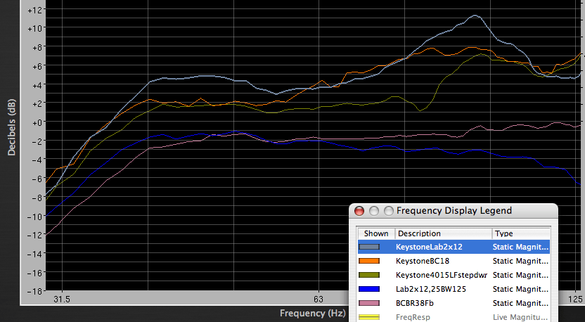

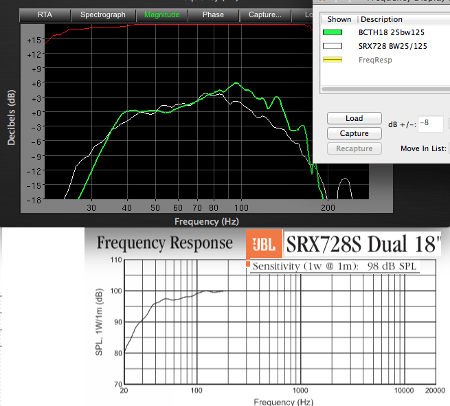

Like most subs designed for sound reinforcement use, the Keystone does not have flat response.Art, I tried to get some perspective on this and look for some plots that you would be familiar with. How does the current 103db flat to 40hz with 300w compare with the Keystone 12?
If I recall correctly, the 45" x 26.5" x 22.5" Keystone loaded with 2 Lab 12 does around 128dB at 40Hz at 300 watts, rising to 135dB ~110Hz.
It could do 103dB dB at 40Hz with under 4 watts.
Loaded with the BC SW115-4, sensitivity is slightly less, with smoother response, less thermal compression, and more output potential.
The 2x12 LAB12 Keystone is about +5dB at 40Hz and +14dB ~110Hz compared to the same drivers in a bass reflex of half the size with the same low corner frequency.
Though a pair of the BR have slightly more LF (using double the power) they can't come close to the upper bass output of the Keystone.
The Keystone Loaded with the BC 18SW115-4 has very similar sensitivity to the JBL SRX728S "98 dB 1w@1m":
The above outdoor ground plane tests using a BW25Hz HP and 125Hz LP filter were done with identical power level, sub position and test mic, "0dB" =96dB, if JBL's specification sheet is correct.
Note that JBL stops response at 200Hz, avoiding depicting the port resonance ~225Hz 😉
Though nearly the same sensitivity, the Keystone with one BC 18SW115-4 has considerably more output potential due to it's Xmax being almost double that of the JBL SRX28 drivers.

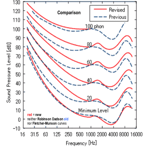

In the Keystone thread, those last graphs with the red and gold traces on black, Is that at 1w? Looks to match up to about 65-80db at 1khz. I hope that I am starting to read these things
One thing has become clear. I need to listen to some things with a meter on. It's very hard to know how loud a number is without any context
So if putting in a major effort for a flat response means it will be perceived by the ear as a falling response, then going back through various sub, multi and FR designs on the forum, I can't see anyone designing a rising LF response. They are usually drooping to a targeted F3
I do notice the bit about losses outdoors and room response augmentation or DSP or Eq compensation.......why is it so bad to just go for flat to the target frequency and compensate with whatever augmentation from the porch floor? Or use electronic compensation, or both? With the current sims at the driver's rated 300wrms and supported 600w peaks together with a 600wrms amp, can there be enough headroom to dial up a loudness curve in DSP to compensate for that falling ear response?

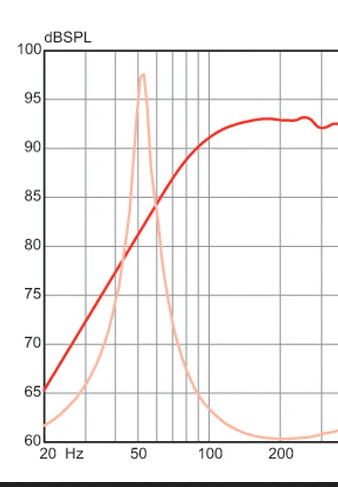

Help me make sense of this one. From comments, I got the impression that the mid bass hump is not desirable and from what you say, the drooping low response will be even worse with the ears loudness perception. That's a 7db hump or 7db droop, is that designed in or is that how much legs the driver has?Like most subs designed for sound reinforcement use, the Keystone does not have flat response.
For that matter, unless the rooms are guaranteed to provide rising LF gain of 10db or more, most frequency response models and measurements that I see online should be whisper quiet low bass as heard by the ear when compared to upper bass and that most designers prefer to reproduce an attenuated version of the material in the recording then that the producer intended
Nothing is near 65-80 dB at 1kHz in post #47.In the Keystone thread, those last graphs with the red and gold traces on black, Is that at 1w? Looks to match up to about 65-80db at 1khz. I hope that I am starting to read these things
The black (SMAART) graphs go to 125Hz and ~250Hz.
The different color traces are identified, the top three are the Keystone cabinet with different drivers, the lower two traces are bass reflex cabinets with the same low corner.
The JBL SRX728S graph is at one watt (2volts in to 4 ohms), the SMAART graph above compares the JBL SRX728 to the BC18 Keystone TH (tapped horn) both at the same drive level.
PA sub cabinets are designed for maximum output in a given space, whether in transport, venue use, or storage.Help me make sense of this one. From comments, I got the impression that the mid bass hump is not desirable and from what you say, the drooping low response will be even worse with the ears loudness perception. That's a 7db hump or 7db droop, is that designed in or is that how much legs the driver has?
Their response is always processed with HP, LP and parametric filters for the particular application.
As amp power and processing is now built in to many PA (or studio monitor) cabinets, the raw response or sensitivity is not specified.
Designing for flat response below 40Hz requires much larger cabinet volume than typically desired, so EQ is used to compensate for the rising upper response.
Since cone excursion is at minimum at Fb, plenty of boost can be applied around it without exceeding Xmax.
Much (most) of pop music bass is in the 60-120Hz range, having more sensitivity in that range reduces average power, reducing heating. Most subwoofer failures are thermal, rather than mechanical.
Of course it is once corrected for the ear sensitivity as per the loudness scale. The low end sits around 40-50hz about 105db on the yellow trace in that thread. So the actual perception would be similar to 1kz at between 65-80db. Thats a very droopy response once corrected for loudness scaleNothing is near 65-80 dB at 1kHz in post #47.
My bass is strung with BEAD and I see a few 5 strings live on Rototom stage
Let's leave correcting for the ear sensitivity scale for another time and as more understanding arrives. I spent the past hour getting some readings at my listening position. This is seated on the Heaving Bed, working on the keyboard and listening with the 2.1 Logitech Z623 at a distance of 1.8m from the sub and mains, Sub is in a corner, 60cm from the back wall, 30cm from the port side firing onto heavy block out curtains

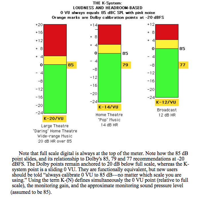

Setup for readings
Playing back my normal daytime video playlist in Windows Media Player. WMP graphic Eq is normally set flat. I have taken down all but the last three sliders, with the highest being 125khz slider. These three are left at unity. Covered the mains with heavy blankets until mostly drowned out. Sub boost is left slightly below unity as normal. Z62333 main volume knob is set to half-way as normal, WMP volume is set to max as normal and system volume controlled from windows
Daytime level
With windows volume at 38. The SPL peaks around 60db with music
Evening level
With windows volume at 16. The SPL peaks around 56db with music
Late night level
With windows volume at 12. The SPL peaks 50db with music
A 40hz tone is just becoming solidly audible at 39db and I can feel it through the body as well and the audible perception rises and peaks at over 80hz but starts diminishing by 90hz
There may be issues related to the SPL meter app and the frequency response of the iPhone internal mic but if the proposed 2.0 channel 2-way speakers can be developed to read just as well or better on the same equipment and settings than it would be a successful project......of course it needs to sound as good too

Would really appreciate your thoughts on these results on meeting or exceeding the current listening position results? Would this have the potential to develop a low reaching and nearfield mini Dj studio monitors with? Am I now correctly modelling for ear sensitivity/efficiency losses to accurately monitor the bass instruments?
I am also making the assumption that room loading will further augment this bass response and I would be able to properly use DSP as ballast and take away rather than add thus further improving things like group delay and excursion thus improving distortion numbers?
A mutually coupled second cabinet adds +3dB ("B" is Bell, as in Alexander Graham Bell, it should be capitalized like Bassinga) sensitivity. Two sub cabinets require only half the power as one for the same output.For the SPL estimation, do I add 3db or 6db for the second cab?
Two sub cabinets each with equal power as the first add 6dB, +3dB sensitivity, +3dB power.

I think your "listening position results" are single numbers, and you listen 10 dB louder (to some unknown combination of frequency levels) at night.Would really appreciate your thoughts on these results on meeting or exceeding the current listening position results?
No real concept of what you are trying to model here.Would this have the potential to develop a low reaching and nearfield mini Dj studio monitors with? Am I now correctly modelling for ear sensitivity/efficiency losses to accurately monitor the bass instruments?
I have no knowledge of your personal hearing sensitivity, and no idea what efficiency losses you are writing about.
"Accurate monitoring" in my way of thinking requires the speakers accurately reproduce the input's frequency response and (hopefully..) some reasonable facsimile of the input's transient response over the usual 20Hz to 20kHz range.
If you monitor at different levels than the recording was originally monitored at, you may want to adjust for your own particular loudness contours.
I don't think your SPL levels are reliable, if they are you don't need more than 1/10th of a watt to produce them.
If your low frequency SPL is only peaking at 60dB, you are monitoring at far lower levels than any pro would base a mix upon.
I suggest you read what Bob Katz has to say about monitoring:
https://www.aes.org/technical/documentDownloads.cfm?docID=65
DSP as ballast?I am also making the assumption that room loading will further augment this bass response and I would be able to properly use DSP as ballast and take away rather than add thus further improving things like group delay and excursion thus improving distortion numbers?
Don't make assumptions that "room loading will further augment this bass response", depending on the sub position and your small room listening position, response can vary +/-12dB over a half meter.
