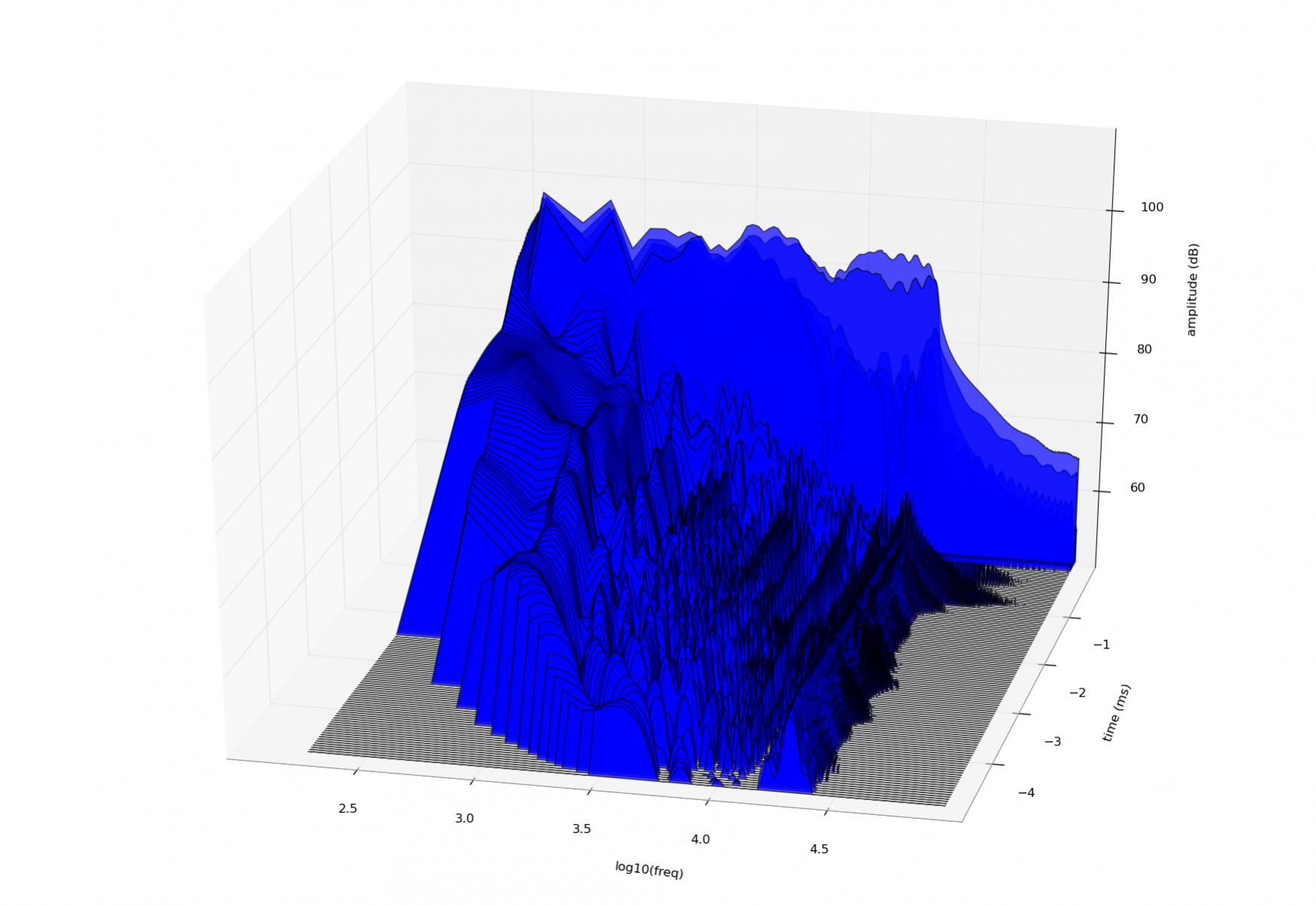

Cumulative Spectral Decay Plots

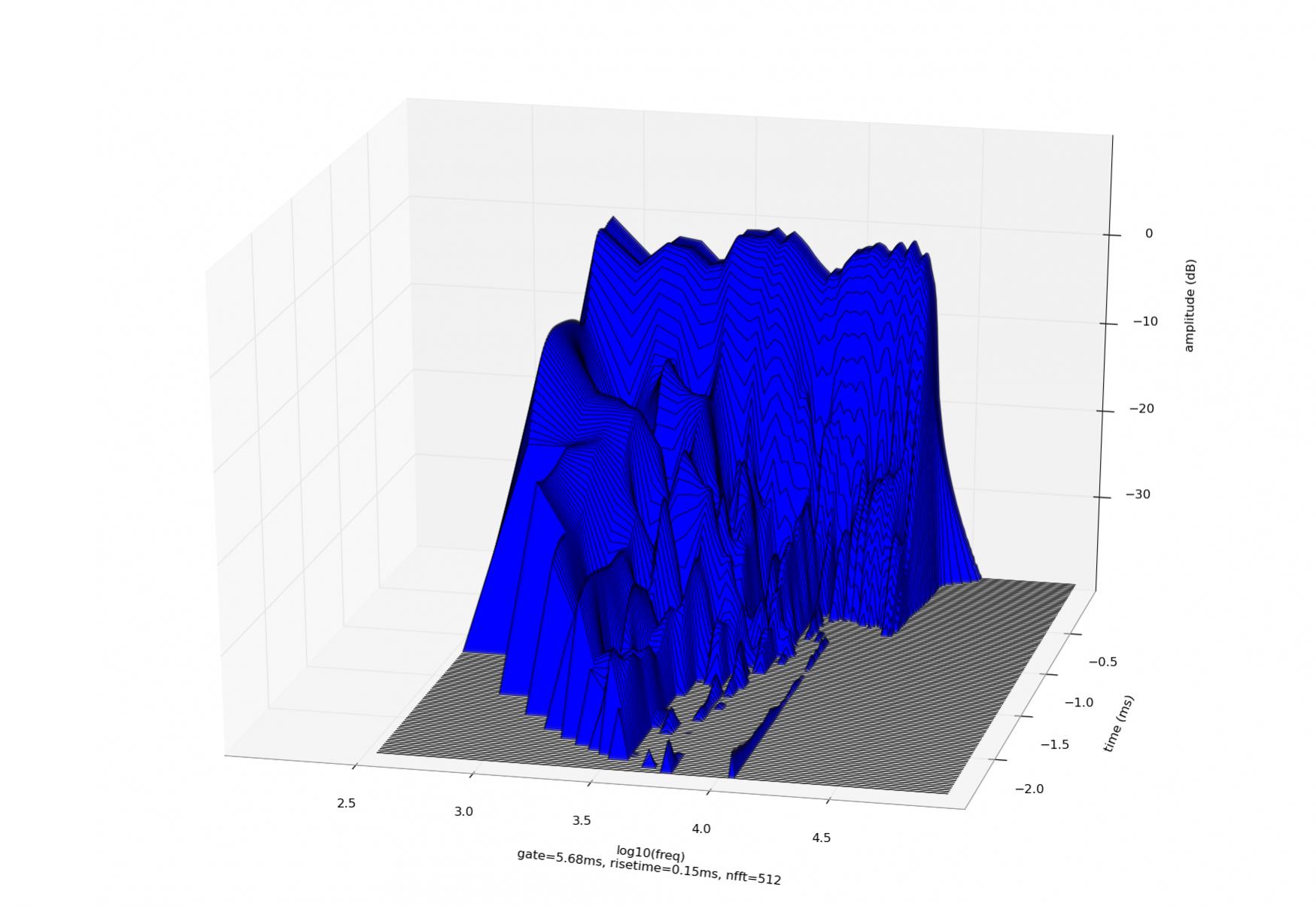

As an educational exercise I wrote a short python script which makes CSD plots from the impulse responses exported by HOLM Impulse. From the experience I am surprised by what the plots can reveal or hide to the viewer with different amplitude and time axis parameters. I think I will definitely be a more skeptical in assessing waterfall plots. The code is provided below if anyone would like to play with it.
Code:
# Author: Roger Lew
# Date: 7-15-2010
# Version: .1
# Copyright: Public Domain, do what you want with it
This script creates csd plots from ASCII text impulse response files. The impulse
response file should begin at time 0 and have a power of 2 number of samples
the file should have only one column with the amplitude values by time. The sampling
rate (as well as other parameters for the plot) should be specified below. The script
should open a window which will allow you to manually rotate the waterfall and save an
image if you so desire.
Made with python 2.5, requires numpy, and pylab

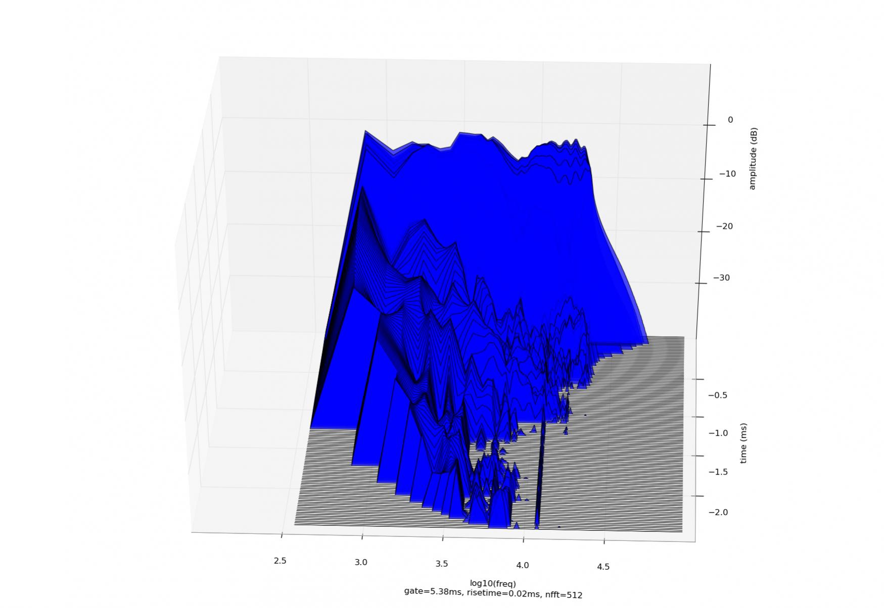

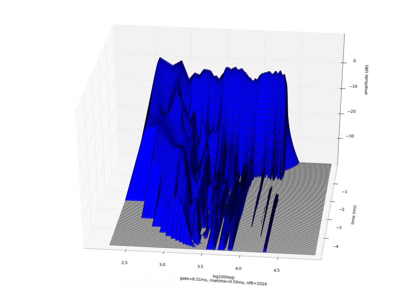

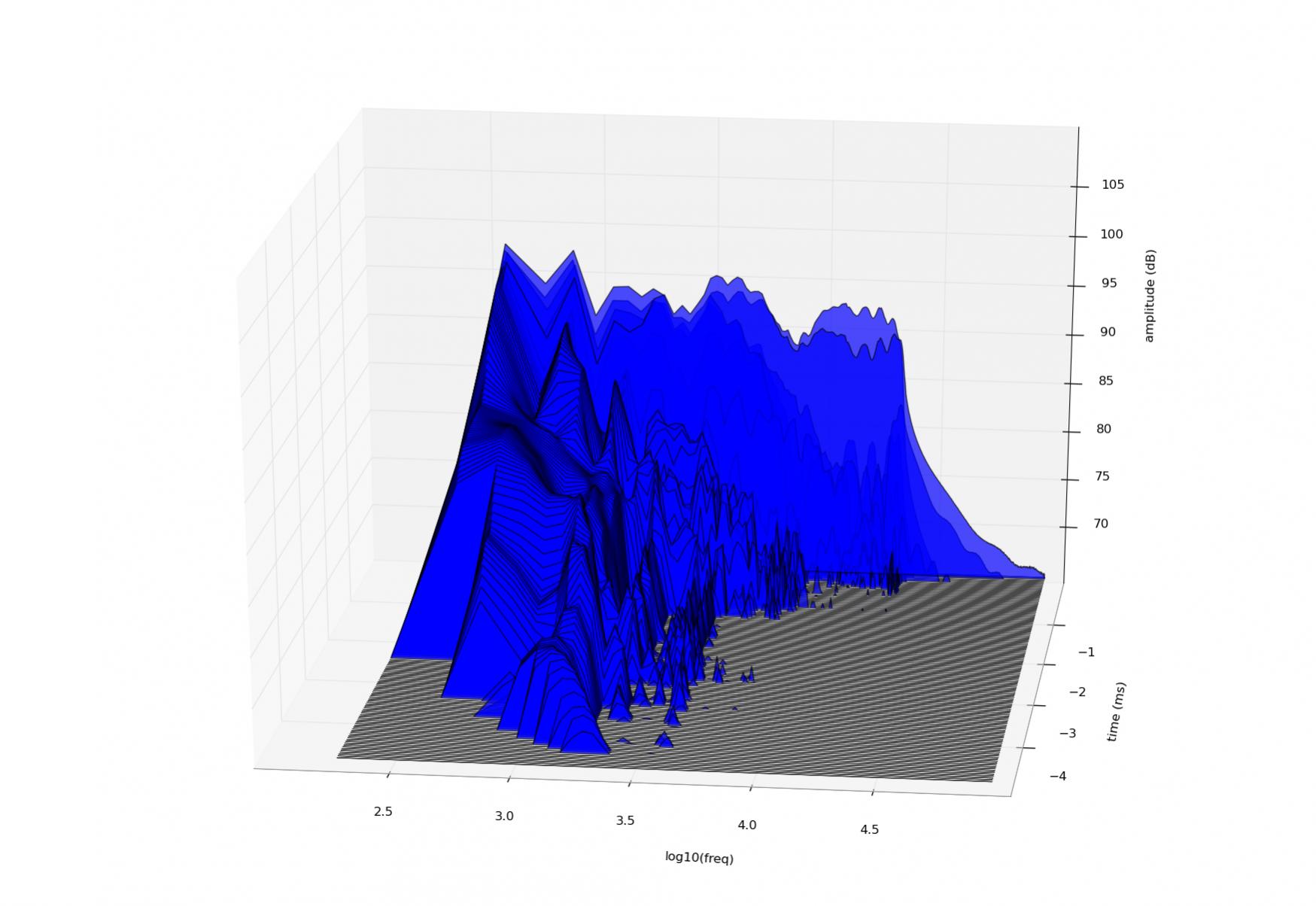

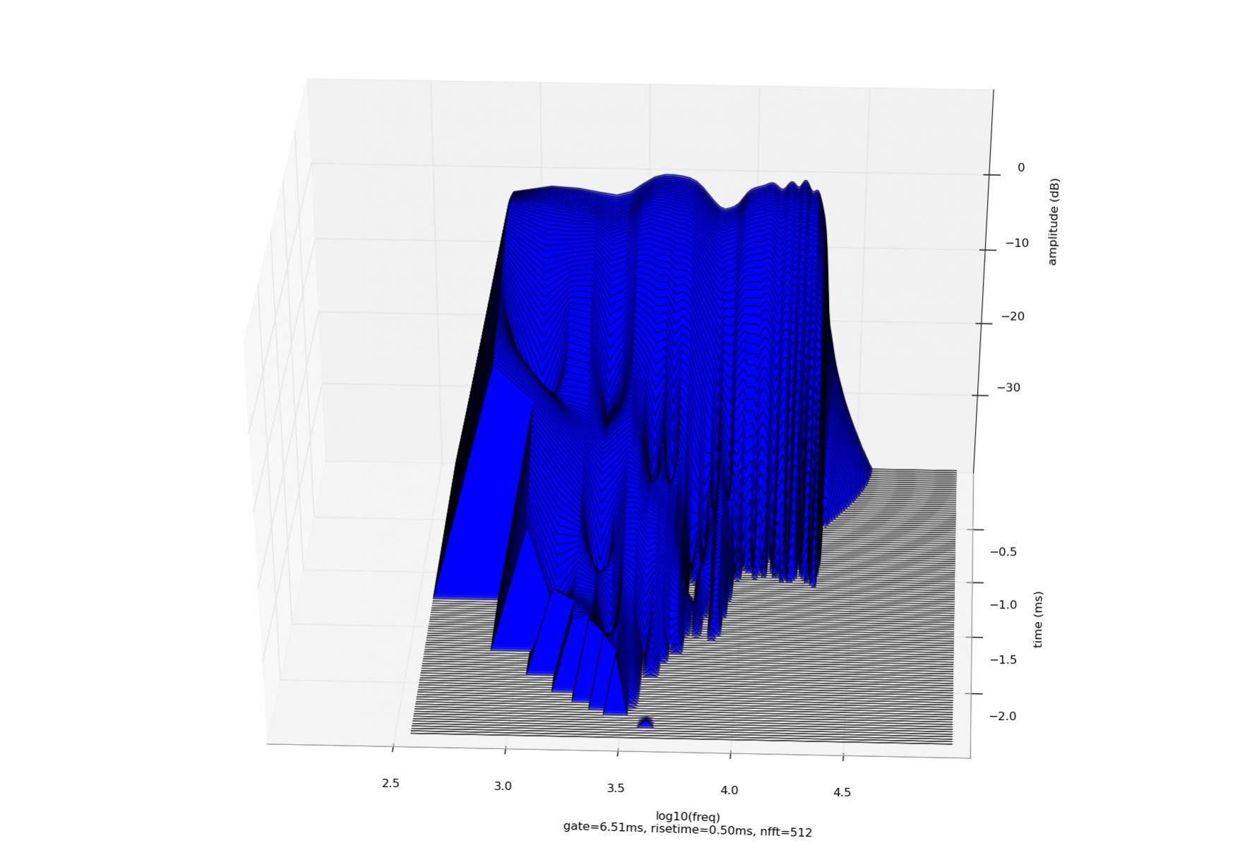

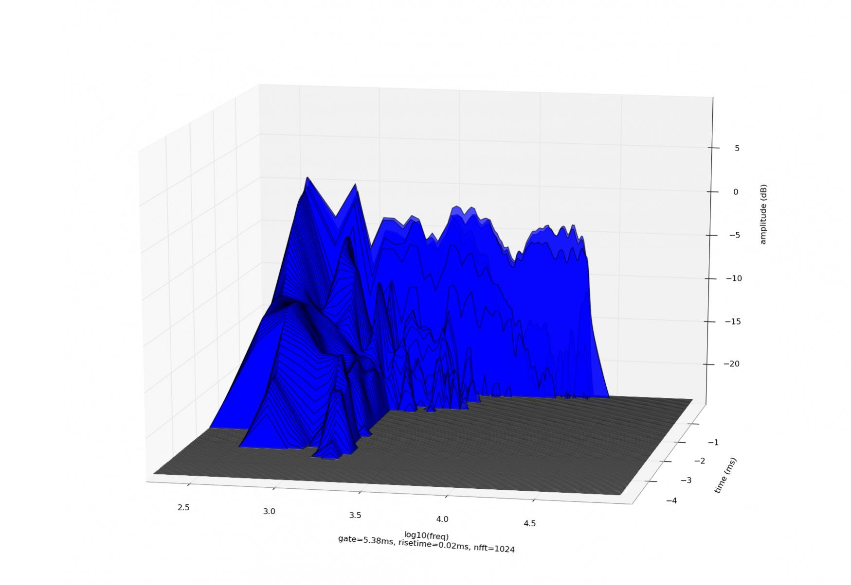

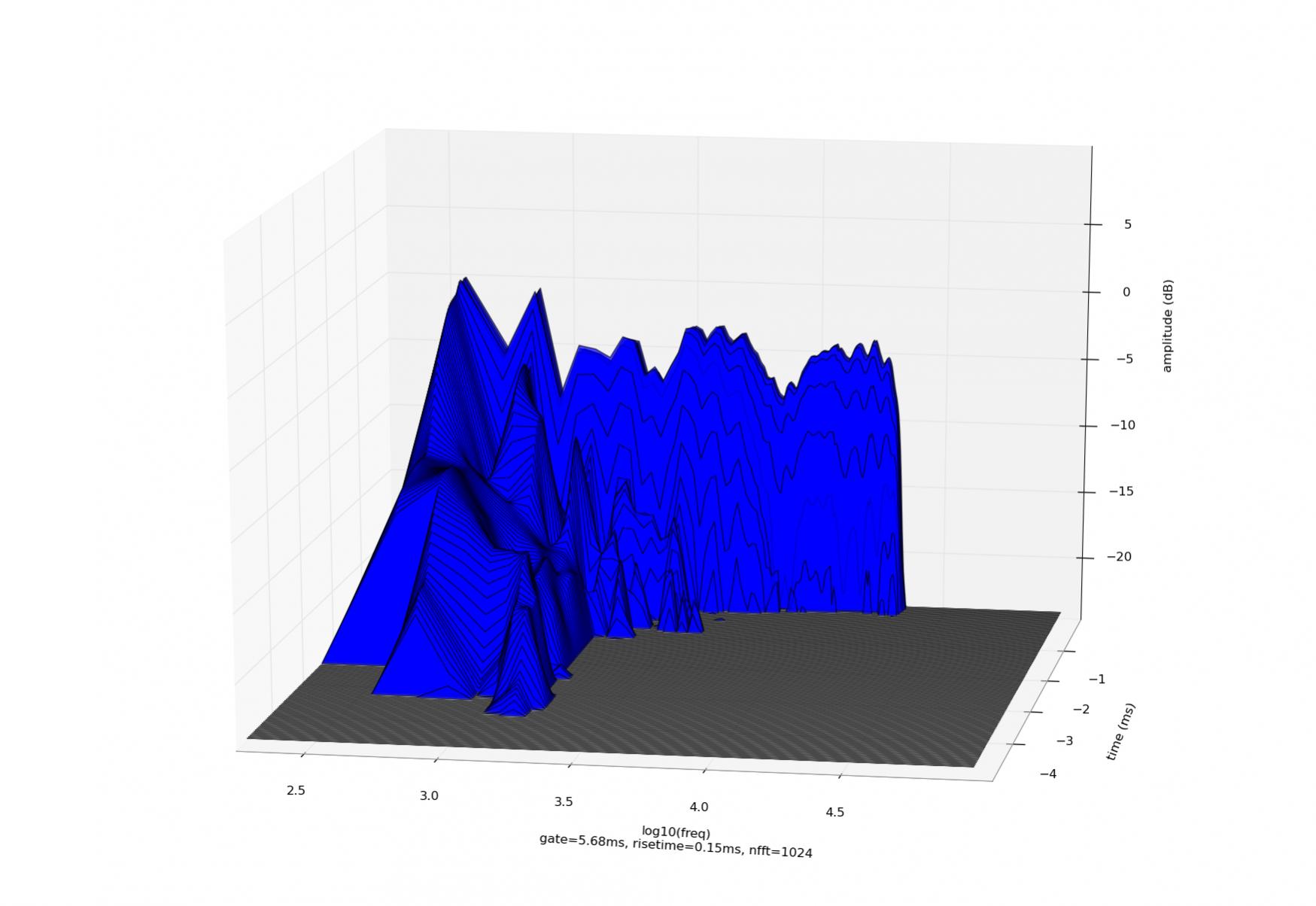

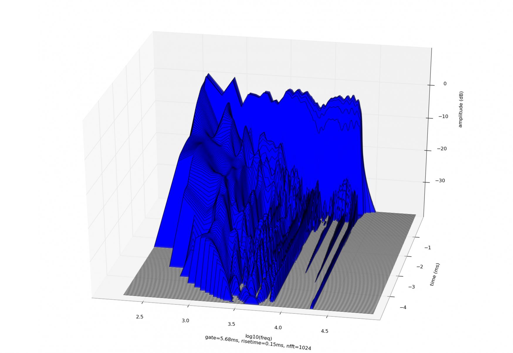

version .2 of CSD script
I implemented apodization with the 4 lobe Blackman-Harris function. The rise time as well as the fft size can be specified. I need to clean up and comment the code some more, but it took me an embarrassing amount of time to realize the beginning of the impulse needs to be padded so the windowing doesn't destroy the first high frequency impulse. I'm thinking about wrapping a simple GUI around it. If you happen to see anything odd, please do speak up. I freely admit I don't really know entirely what I'm doing. I'm treating this whole thing more as an academic exercise.
