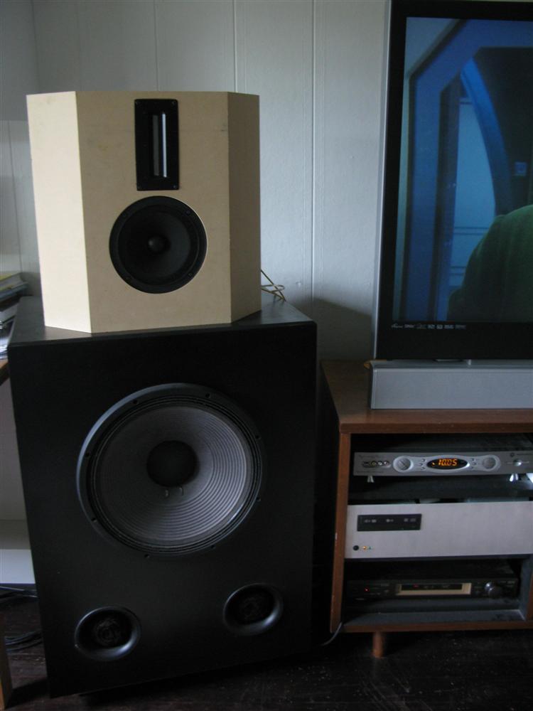

Cool...
Is that a vintage Hartke up there?
Would make a cool clock on the wall if it is no longer functional...
