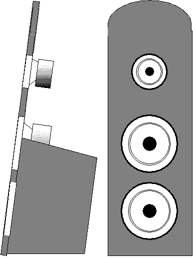

ok, so i have two options.
either...
1xFR125S and two woofers (mabye the Dayton RS225S-4) in Open Baffle
Or
1xFR125S facing forward and a WR/FR125S facing up in a 25 sealed cabinet.
cant decide...

here is a scale (rough) of the OB...
OB apeals to me a lot aswell because i could make the side stands removable so it could be flatpacked as i go between home and uni.
although i would need a crossover, would a 2 way with two 4 ohm RS225's be best? and what would be the best crossover freq?
and is it a problem that the FR125S's are 86dB efficient and the RS225's 92dB efficient?

inrank said:\although i would need a crossover, would a 2 way with two 4 ohm RS225's be best? and what would be the best crossover freq?\
You really should be bi-amping somewhere between 150 and 250 Hz....
You top woofer isn't going to do much except rattle the baffle. I'd put them both down near the floor, inside the wings.

also, what about this design?
using 2 10" woofers rather than two 8"s, in a baffle 800mm x 300mm.

Somewhere along the line I missed your intention for this build. If you want a good OB setup I would eliminate the FR125 altogether unless you plan to scavenge them from the previous project. I experimented with them in OB last fall and I think there are better choices to get some bass and volume. The 10" Goldwood from PE you linked to has potential but you mentioned you have a sub so I don't follow with that. If you're looking to experiment with OB and need a set to rock in your dorm room I'd hit up the thrift stores and/or Ebay for some likely canidates to keep cost low. If you can afford it the Visaton B200, Hemptone 8", or the Hawthorne 12" seem to be the darlings of the OB camp. Although I haven't heard them, the dipole with front firing FR125 and rear firing WR125 should be a sweet setup. More of the better stuff from both drivers and more bass, too. BTW, Planet 10's advice about placing the woofers lower substantiate what I found to give the most bass response in an OB alignment.

We tried FR125 in an OB, and it was limited to what it could do in the low bass -- that spawned an FR125/Extremis (or other suitable woofer(s) OB project similar to the one proposed here. With active XO the 125s would be just fine.

Re your last OB, that looks very much like the new Jamo type, and as Siegfried Linkwitz notes on his website, with the driver centres being so far apart, the polar response is going to be 'interesting'
Scottmoose said:Re your last OB, that looks very much like the new Jamo type, and as Siegfried Linkwitz notes on his website, with the driver centres being so far apart, the polar response is going to be 'interesting'
is that interesting good or bad? 😉
whats the driver centres?
