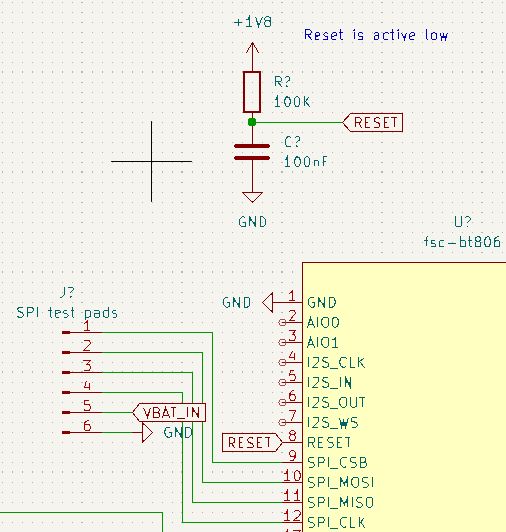

Got my hands on the FSC-BT806, was previously using the EH-MB18. Ran into an issue however with the FSC-BT806. I've soldered the circuit together below (VREG has a tac switch and pull down resistor and all GND pins are grounded, VBAT also has a couple of decoupling caps - this isn't shown on the schematic below).
Applying power results in the device doing nothing, I've attached all three LEDs, pressed the button, held the button, connected to an SPI programmer and still nothing. Am I missing an enable pin or something? I saw on the dev board schematic there was an SPI enable jumper but I don't think that's relevant. If anyone who's got the FSC-BT806 working and in a programmable state could lend a hand, I'd be very grateful.

You can refer to the development board schematic I shared in one of the previous posts. Also 5V on these pads is not great idea, I think they're max 4.3, but I might be wrong.
You can remove all the battery power switches as well as 1.8/3.3v switches. You won't need SPDIF and I2S stuff, most of the buttons (only SYS_CTRL is needed, but you will need to have one more as MFB - multifunction button).

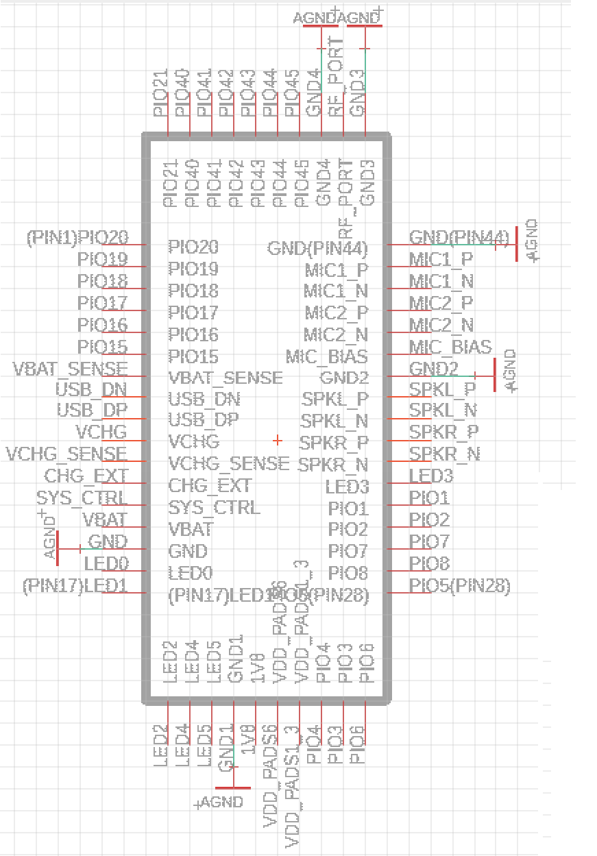

I just noticed that diagram says SYS_CTRL = MFB (pin 13). Are these two pins supposed to be the same, or is this something specific to QCC5151 or that particular module?
SYS_CTRL = MFB
I have no idea why they wrote that, but from analysis of firmware source code they seem to be different buttons.
EDIT: not always. There's SYS_CTRL (pin 0), MFB (pin 40) in 9_buttons.pio.buttonxml. But at the same time message LI_MFB_BUTTON_SINGLE_PRESS refers to SYS_CTRL button. And APP_ANC_TOGGLE_ON_OFF refers to MFB.
So it's not very clear if they are supposed to be the same, but I'd say they are not.
If I understand correctly (coming from QCC5141) SYS_CTRL is a dedicated pin on the chip (similar to the VREG pin on CSR8675) while MFB can be any generic PIO. So they should not be physically same, but I don't know if the firmware can be made to detect both on a single pin, or if there is any peculiarity in the QCC5151 chip.
That's correct.
It seems that this is exactly the case. From module specifications:
QCC514x/5x are basically the same chip with very minor differences (initially to support LE Audio, but it turned out to be not enough). There's even no separate QCC515x target in kcc (516x and 7x do exist even though probably no QCC516x chip will ever be released). Specs for the QCC514x/5x/7x (and even QCC512x) modules contain similar notes about SYS_CTRL.
