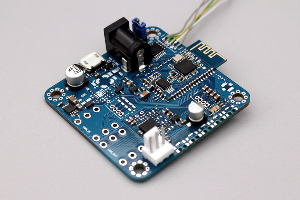

Hi everyone! This is my first post here at DIYAudio so don't beat me up too hard, haha.
I must say that this thread has caught my eye, since I am in the process of assembling a DIYINHK ES9018 dac board and ESP P101 power amplifiers to build my first hifi amplifier.
I'm still waiting for most of the parts to come before finishing, so I've had a lot of time to think about what features I could add to take advantage of the ES9018 digital inputs. Ideally, I was thinking it would be great to have USB (via an xmos board), TOSLINK, and bluetooth inputs (via spdif).
Looking around for a bluetooth to spdif board/module, hoping to find a DIY kit or something that I could hack (if necessary), I only came across this "High-end aptx Bluetooth audio receiver", unit (and a few similar to it) that I guess I could pull apart and put inside my project. But I was hoping for something simpler.
Then searching for bluetooth to i2s I did find this "Assembeld Bluetooth TO I2S board" board that looks to be more easily integrated in my project.
The problem I have is that I don't know if I can have more than one i2s inputs on the dac board, so spdif output would be easier to use for my purposes (since there is a spare input for that).
So my question to you fine gentlemen, can the CSR8645 module, as shown through the link on the first page of this thread, be used to transmit spdif audio to a dac? And if not, could I use the bluetooth to i2s module I've linked to, to do spdif instead of i2s (since I will be using the i2s input of the dac for the USB xmos module).

On wt32(i), per default there is no licence included.
On iwrap 5.0 there was a demo licence (approximately 5min playback).
You have to contact CSR for apt-x licence keys or Via for AAC.
But Via does only support large volume licensee. CSR has a better support, but there is also no end-user support.
If you like to do something with apt-x or AAC i recommend to buy a ready to use modul from china with enabled algorithms.
