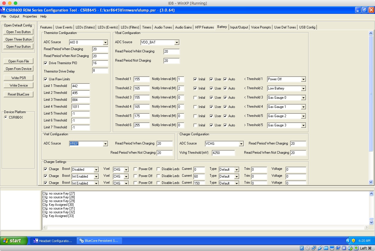

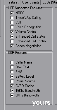

Battery report works out of the box here (tested only with IOS). Parameters can be changed within the CSR8600 config tool (ADC-levels, ADC-input, etc.)

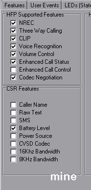

for me it's disabled. I have bluetooth headphones based on csr8645
here is my battery section
would you be so kind to provide yours? so I could enable this feature for my module
