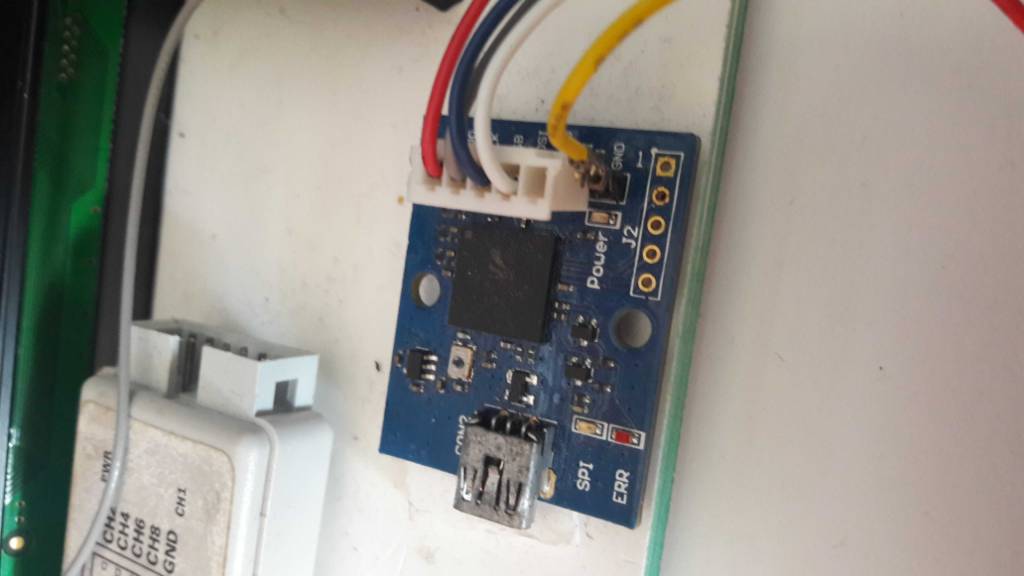

I have this one
This is csr spi programmer.
Some tools needed only scr programmer (pid of usb), so i use this one.

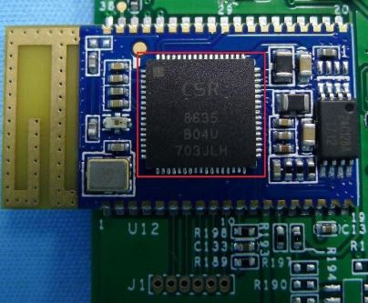

I have been trying to determine the pinout on this particular 8635 module but cannot seem to find a diagram anywhere. I have had success renaming many other CSR modules but cant crack this one which is integrated into a 3116 amp so I can't replace it. At the bottom of the pic you can see what I assume to be leads for the CSB, MISO, MOSI, CLK, SPI pins but that doesn't really get me anywhere. Please help, thanks!
